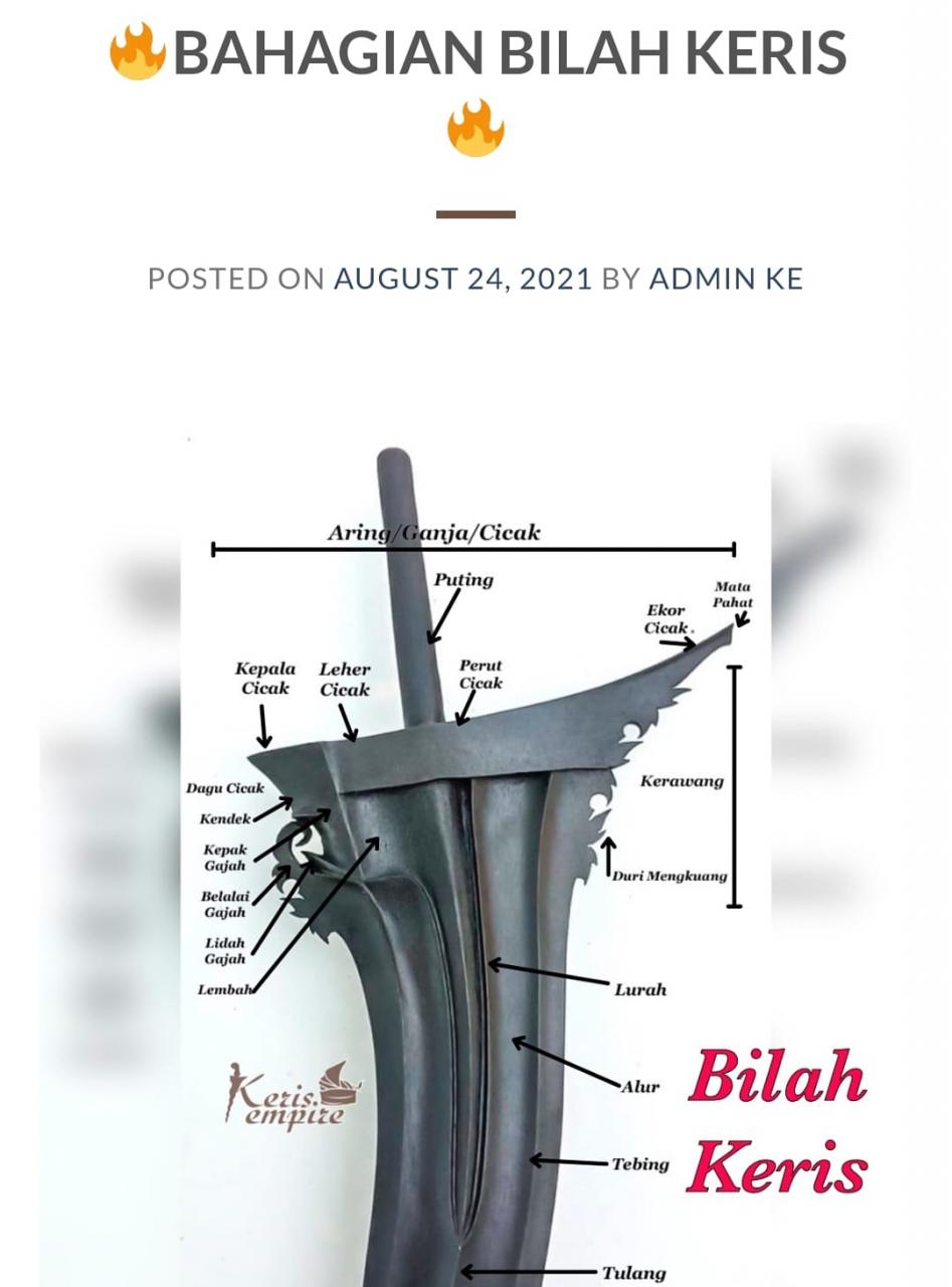

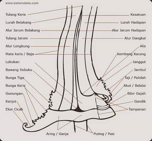

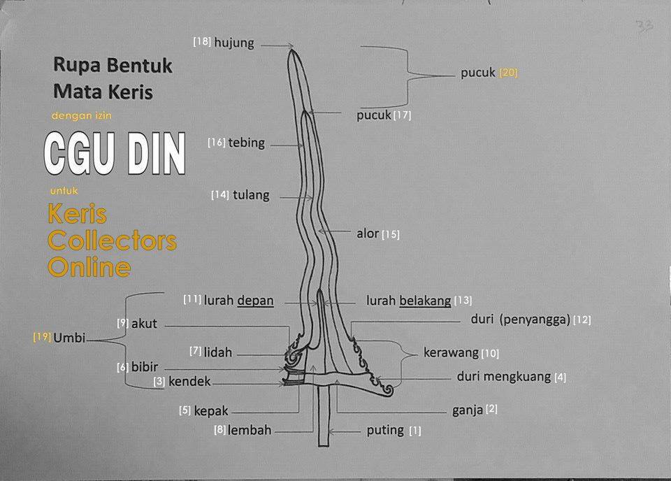

Reading the descriptions has raised a question for me. Ricikan, sekar kacang, praen, gandhik, lambe gajah, greneng, jenggot, sogokan and blumbangan are all Javanese words for parts or aspects of the Javanese keris. Gangya is the one word here that has obviously had some carry over to the Moro kris/kalis as a variation of their word gonjo (ganja). This terminology has, to a greater extent, been adopted and applied to keris from outside the Javanese culture, though i have run across numerous diagrams that show the more culturally correct terminology for various other Indonesian and Malay cultures as well. While i do understand that using one lexicon to describe the features of keris makes communication a bit easier it still seems a shame to allow more specific cultural identities to fade away from lack of use. But rarely have i seen this many Javanese keris terms used to describe a Moro kris. I have to wonder if we are not doing the Moro culture a bit of a disservice by not seeking out the terminology used by their smiths and people to describe the parts of their own weapons. I has seen a few diagrams that attempt to lists these culturally correct terms, but none seem to be as extensive as the Javanese lexicon for keris parts. I have attached what little i have seen in this regard even though i am fairly sure that you all have seen them as well.
I am also attaching a few diagrams showing some of the variations on keris terminolgy that can be found in various places around the archipelago that are different from the generally embraced Javanese terms.

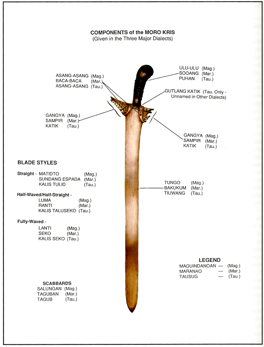

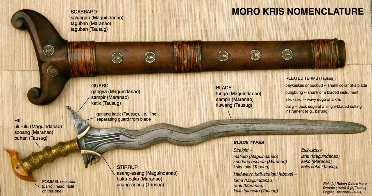

David, you raise a very good point. There likely is more specific terminology in the original Moro cultures for the features that I have labeled with Indonesian terms. If I had a reliable lexicon for those terms, I would certainly use them. For example, I have used the Maguindanao terms gangya consistently for Moro swords because that is a term used by the Maguindanao and is sufficiently close to ganja to be understood. The term asang asang is Maguindanao, and I have also used the Maguindanao terms for a straight kris (matidto) and a fully-waved kris (lanti), as recorded by Cato (p. 60).
As for the carved features for which I use keris-related terms, I have no information as to what they may be called in the various local languages. Hence, I use common Javanese terms for these. This decision was made after corresponding with Alan Maisey, who recommended an accepted set of keris terms that would be understood widely among the keris community.
I also use the Indonesian terms because I want to remind people about the origins of the Moro kris, and what those features originally meant. No doubt there has been some re-interpretation of those features over time among the Moro communities. Again, I'm not privy to how Moro peoples have interpreted the Indonesian keris symbolism that they adopted and adapted over time. There are some suggestions in the Western literature, but frustratingly little scholarship on that subject.
Yes, it would be nice to have more information about local terms and interpretations. I would use such terms if I could find them. However, I'm aiming for clarity and how to communicate the features of these swords in a way that can be understood widely. The Javanese naming system seems a place to start until more accurate terms are available.

Halloo, just as an aside- according to a Maguindanaon culture-bearer of the Salipada lineage, the proper terminologies should be:
If it's a straight kris, it's called "kris sundang."
If the kris has waves, then it's called "kris a lanti."
These terms are different from Sulu's, since kalis has its own proper terminologies, as asserted by modern-day Tausug culture-bearers:
If it's a straight kalis, it's called "kalis buntul."
If it has waves, then it's "kalis ____ siku," the number of waves is specified.

Xas, thank you the terminology. While it differs a little from what Robert Cato collected from his informants in the 1990s, I shall revise my data accordingly.
Ian, please understand that i was not criticizing your usage of these Javanese terms in this regard, simply making a call for more vigorous research to discover the proper names for these features in at least one, if not more, of the Moro languages. We do have at least a few native Filipino members here who may be able to make some inroads on this study. It just seems that we have for some time assumed that this knowledge is not available, which i suppose could be the case. But i would hate to see Moro collectors give up on this search altogether because language is such an important part of any culture and understanding deeper or hidden meanings that might be lurking there. Despite the obvious fact that the Moro kris descended from the Indonesian keris, clearly these two weapons were treated in very different ways by these respective cultures and the specific names used for the various features can help us understand better how these people related to these weapons.
