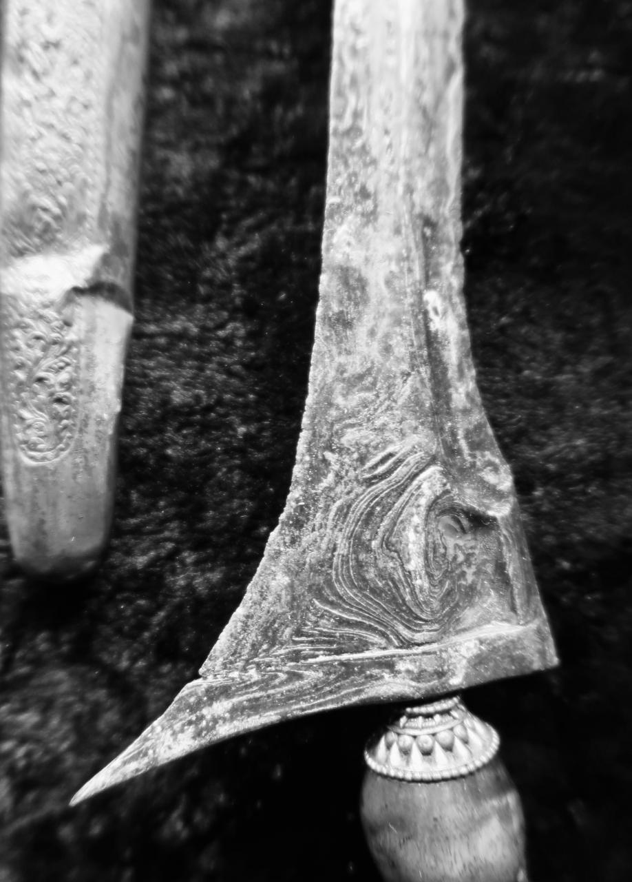

Regarding the Jogja keris.
Varnish is easy to remove, depending on exactly what kind of "varnish" it is it might move with methylated spirits, or you might need some other solvent, but it will come off.

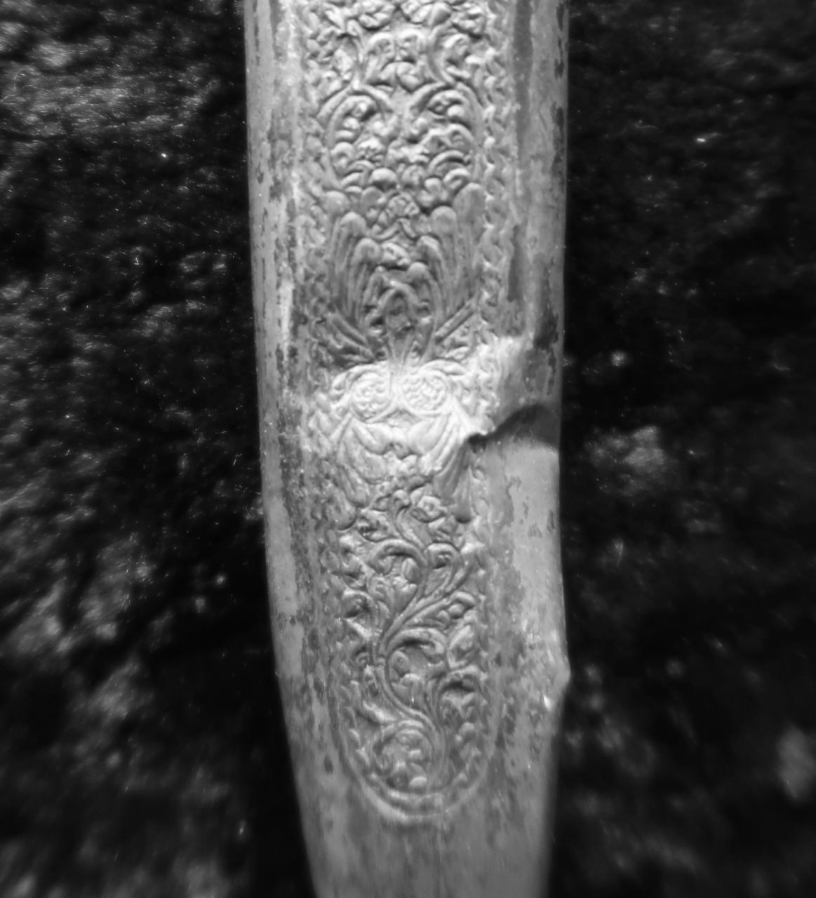

The pendok should not be much of a job to straighten out, a piece of 1cm round steel bar clamed horizontal in a vice & inserted into the pendok will permit the dents to be straightened out, finger pressure is usually enough.

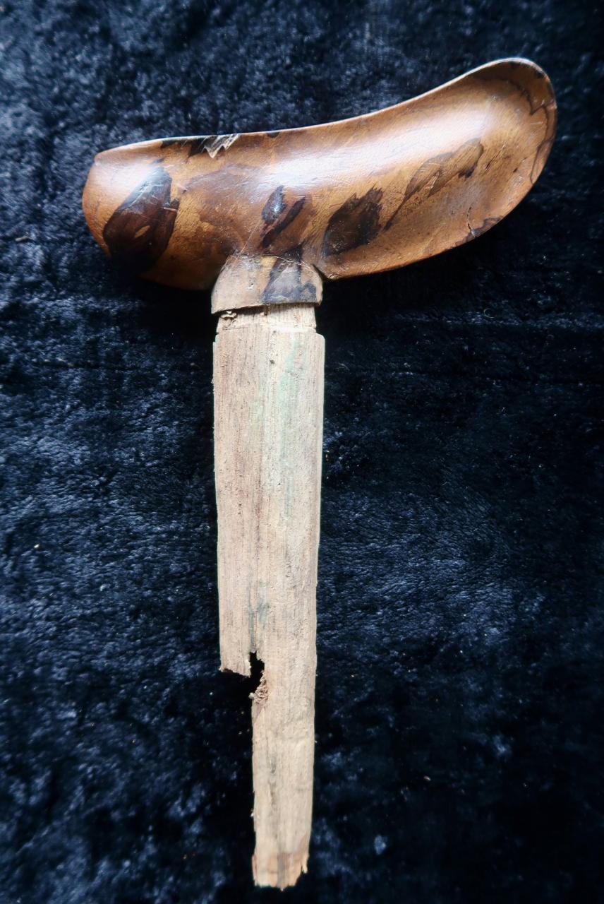

There was dammar varnish also on the tombak and this I scraped of with my thumbnail. I will do that with the Keris blade as well. As a teacher in furniture restoration the woodwork ain’t a problem. I haven’t found out what kind of wood the gander is made off. It is a very light wood and to my feeling the sapwood part of wood but what species I don’t, have a clue.
Can I ask you what you mean with a foot at a gambar ?

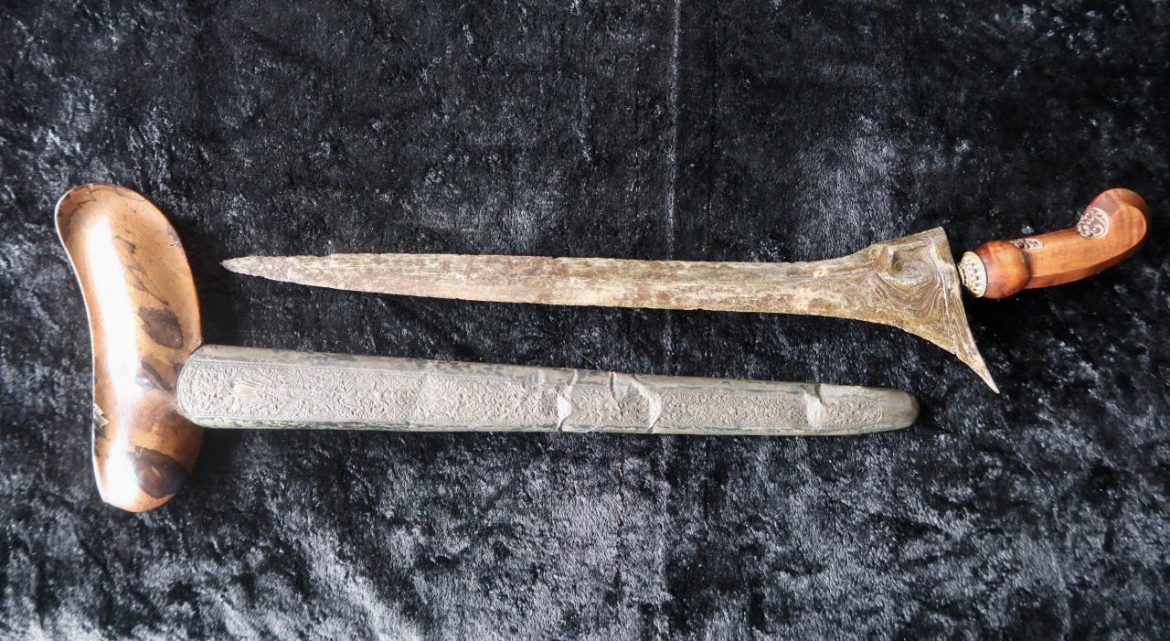

I post some pics of the Javanese Keris. I think underneath the varnish is a nice pamor as you can see in the picture.
