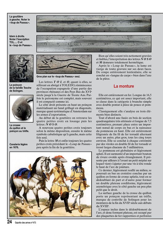

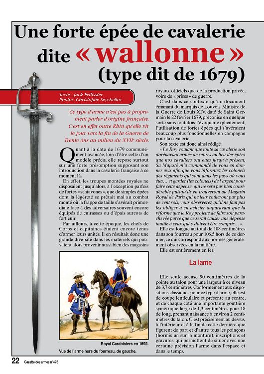

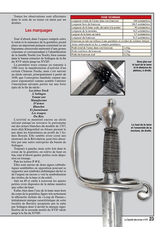

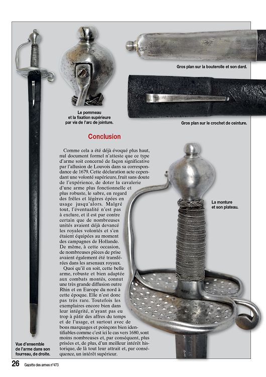

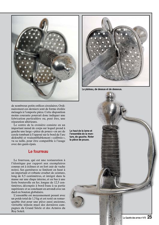

Below are screen shots I took of the article. To be honest, from what I read through Google Translate, it doesn't add much to the discussion either. Looking at their example, it also has a number of variations to the typical examples you see in the digital catalogue of the Dutch Army Museum (search for "Waalse degen").

Thanks Radboud! Time to practice mon français (even if it does not resolve this particular discussion).
EDIT: Also, interesting that this one has a TOLEDO(?) inscription and simple holes iso stars in the guard plates.

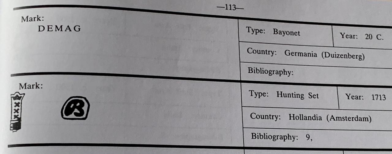

Closest mark I found in the book 1000 Marks of European Bladesmiths, page 113.
