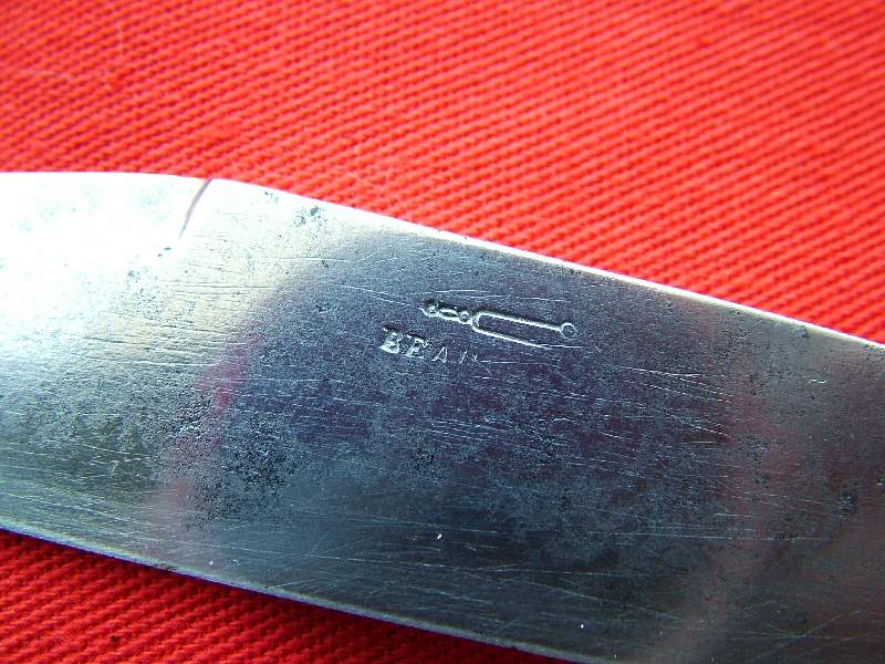

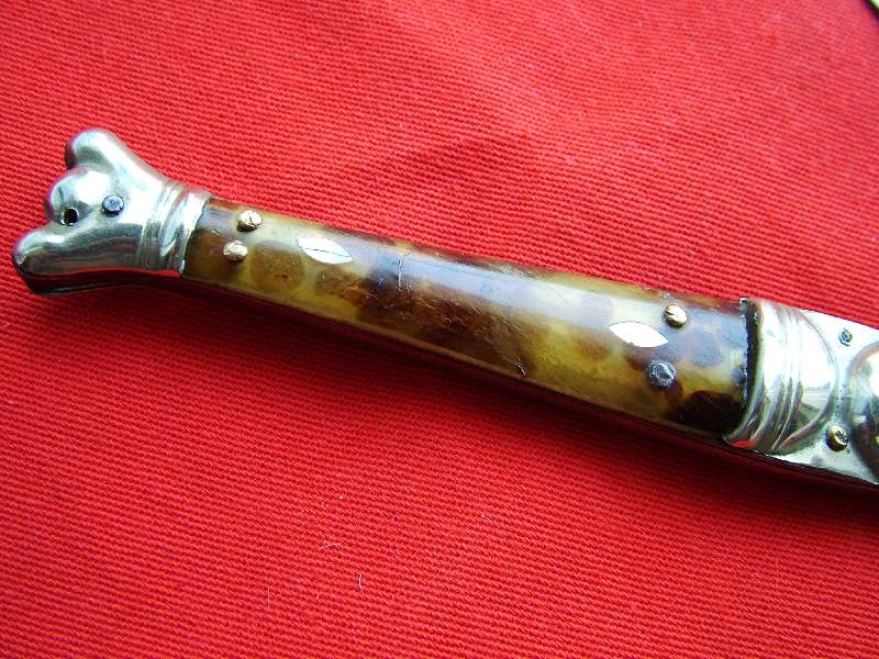

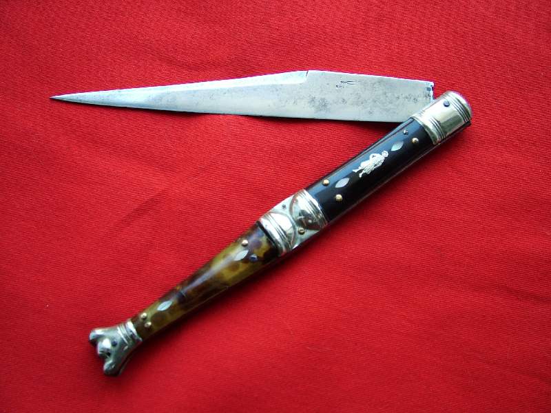

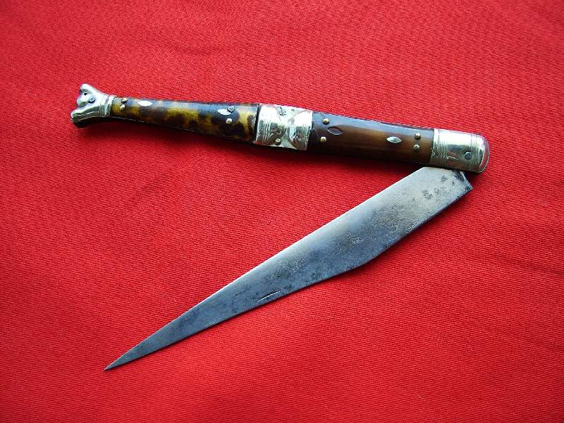

After some thought I decided to post the other navaja here. It is for sale as I want only one navaja. So the after one of them is sold the other stops to be for sale.
This knife has 3 tortoise panels on the hilt and one made from black horn. 8 small mother of pearl inlays (one missing). Fine constructed and very old. It is also long, 40cm. No cracks, chips etc.
Chris please your opinion, it is always good to learn
