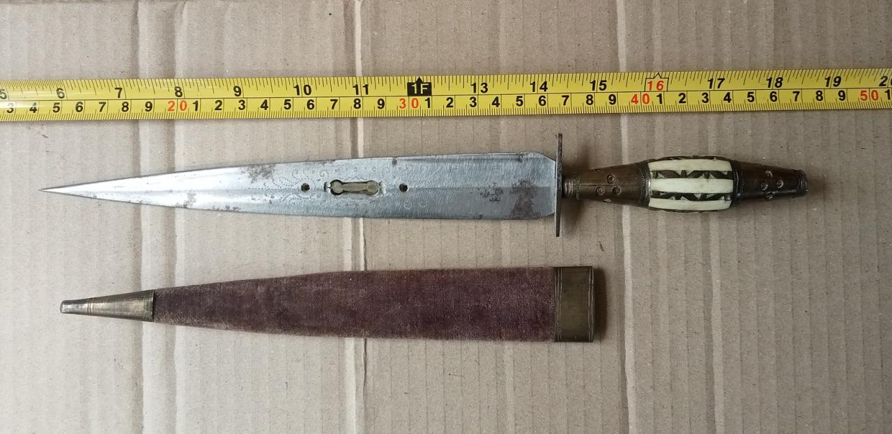

Just bought this Albacete dagger, at auction, with its perforations and the brass inlay.
Always wanted one of these, and managed to get this one at a decent price.
Any Idea on how old it may be? No dimensions yet. No sheath/scabbard 😢. Edge needs some TLC.
Anyone figured out why many have the perforations/brass inlay yet? Knife has a fair amount of Pointillé decorations...
Thanks in advance for any comments.

Nice. aren't you going to clean it ?

Old 1st November 2022, 07:12 PM   #9
Hasn't arrived yet from the Auction house.
I'll clean off any active rust/corrosion. Probably sharpen the edge to remove/even up any chips or nicks. Will try to keep any patination on the knife and grip brass.
I Will need to get/make a scabbard for it.
