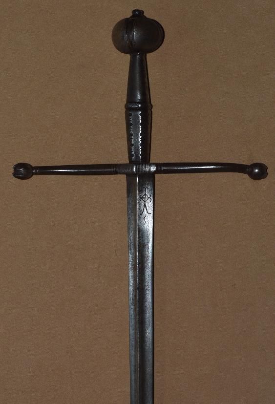

Yest they existed and started on 16th C estoc swords or Tuck as in the picture. Later also on rapiers, but these are rare. These blade were thick at the base and long , like 100cm or more and longer.

That almost looks like a smallsword blade. Did not realize that those were mounted on estocs/tucks. Is it as light as the smallsword ones?

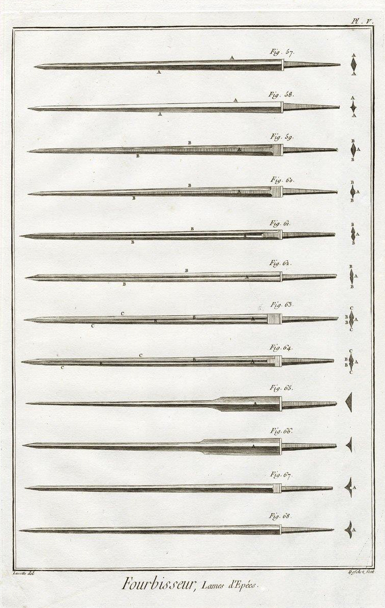

Is this what you are talking about? See below:
Incidentally: estocs were very long, rigid, armour-piercing swords carried at the front of the militia.
The 'hollowed' design was one variation which was lighter, and consequently could be longer; square (or diamond shapes) were also used.
The procedure for producing the hollow version was the forerunner to the development of the classic smallsword (and ultimately Brown Bess bayonets) until the secret machine came along.

do you see any of your variations here:

No, these are much thicker, like twice as thick as a small sword and longer to.

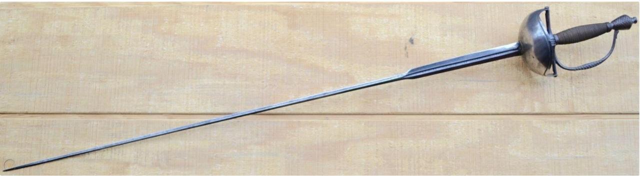

Here are a few.
First one from the thread in the other forum where these blades are mentioned. Second from a dealers page, third is mine. There is another out there in the auction world which is the same shape, on a transitional rapier, though the back edge slopes slightly to one side.
All have a single edged, very deep isosceles section triangular blade.
