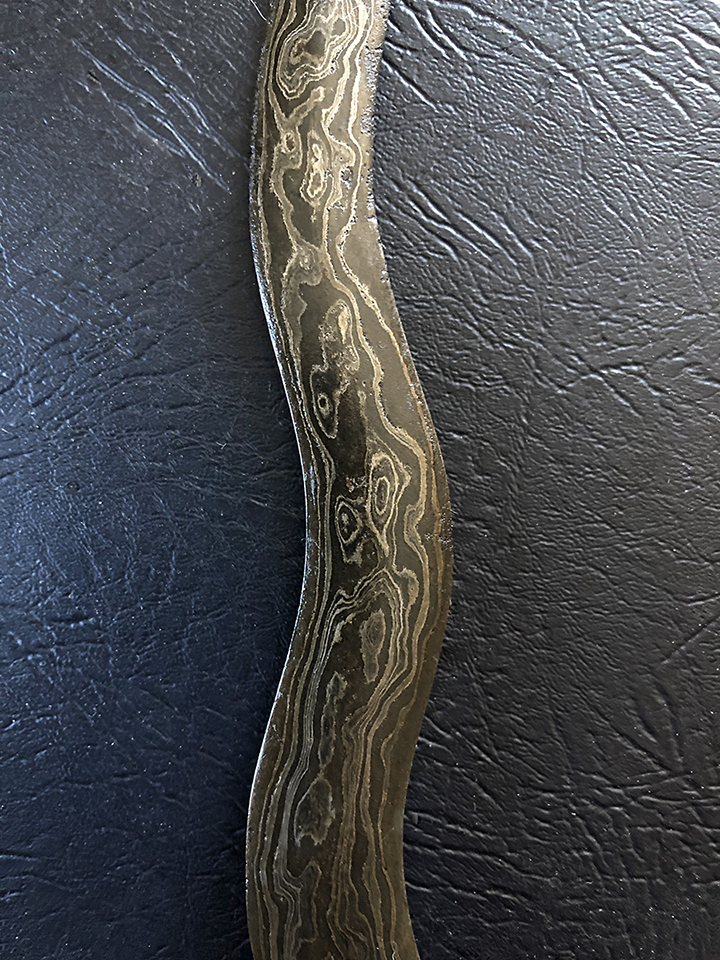

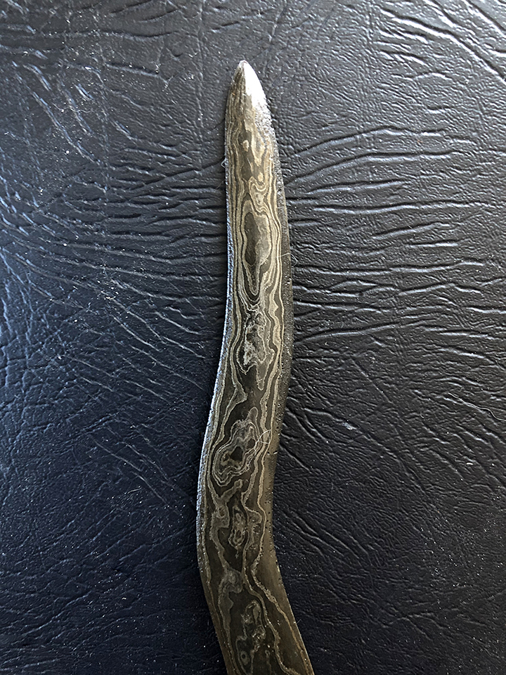

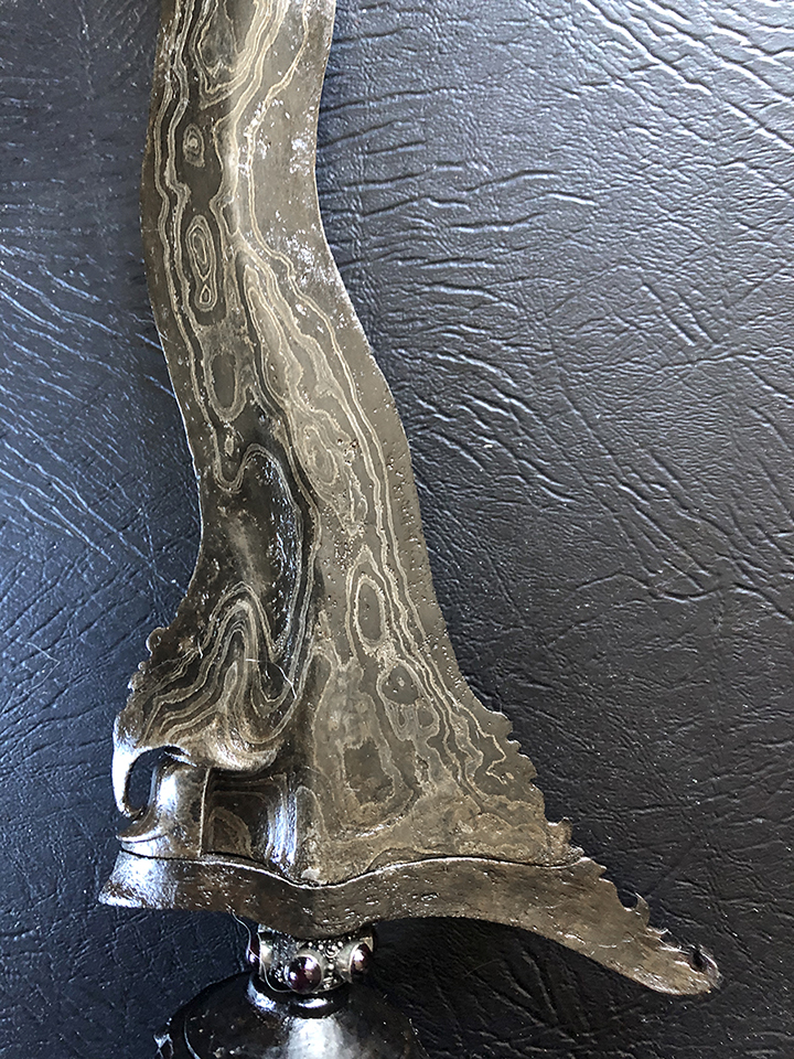

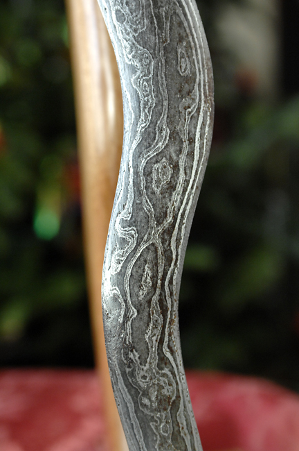

Not always as tedious as my description sounds Anthony. Sometimes you can get a passably decent stain on an old blade with vinegar and a bit of brushing.
On the other hand, this keris is one that I made, to get a decent stain on this it took me two full days, most of the time working in full sun in the middle of summer.

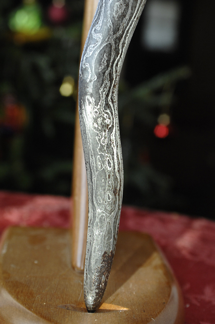

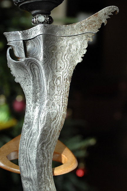

Here is a Bali keris that i stained about 13 years ago. When i found the blade it was not in the best of shape. It had lived in a store window of a curio shop in South Orange, New Jersey for some time and was covered in a thin layer of active rust. The first group of photos shows the keris after i cleaned the rust off with a soak in pineapple juice and regular scrubbings for a couple of days and then gave it a warangan treatment. I must admit that i did not use Tahitian limes, but rather whatever regular limes were available at the supermarket. As described before, i used lab grade arsenic trioxide to make the warangan.
As you can see, my first treatment was weak at best. It was certainly an improvement over the original condition (sorry, i didn't take any before photos) and revealed the pamor pattern, but it was not satisfactory for me. The second set of photos (sorry for the quick and poor cellphone pics as i did not photograph this at the time and just made these now for this post) shows my results from may second attempt on this blade done soon after the first. It is still far from perfect, but i decided not to make another go at it and to live with it as is. The stain seems to have help up well over the more than a dozen years since it was applied.
I do have a few blades i have been wanting to attend to for some time and maybe i will get around to them this year as the weather improves. If i do i will be sure to document the process for thoroughly.
