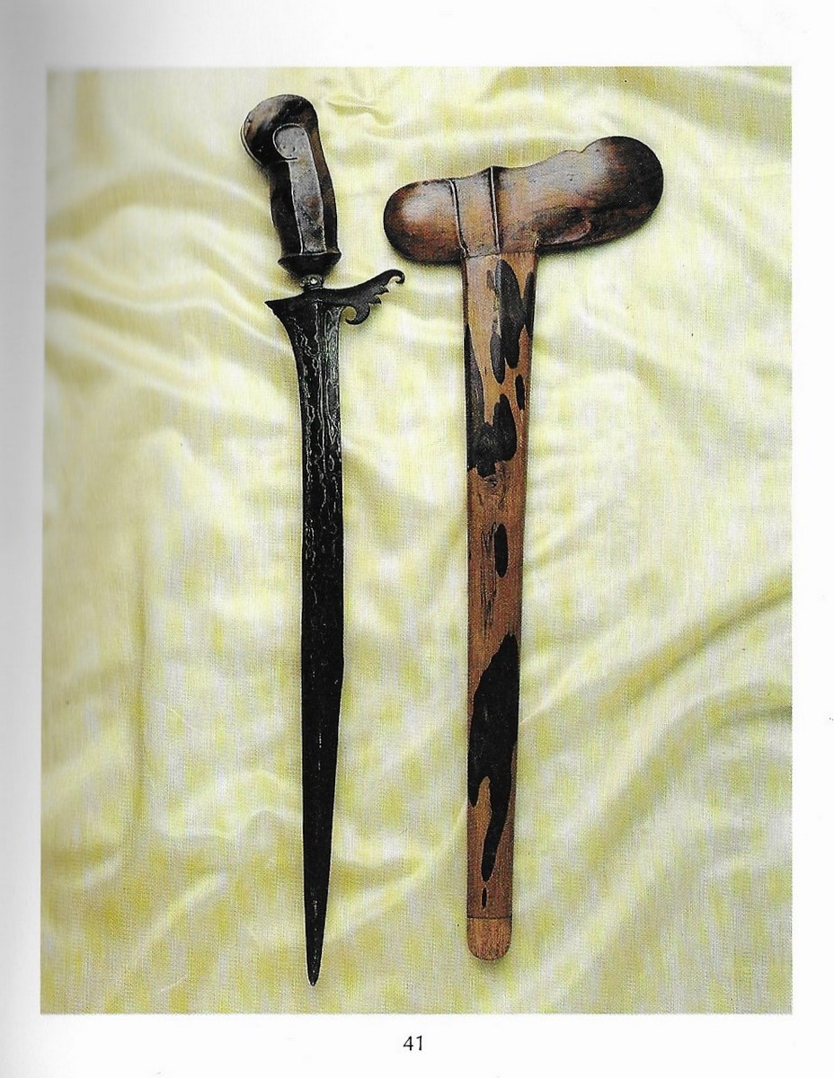

Thank you Alan, and I attach the pic of the kris in question from Mario & Vanna G.
Ha ha, RIP Wayan Ritug! I agree with you that the kris from Anthony is most probably a recent creation.
