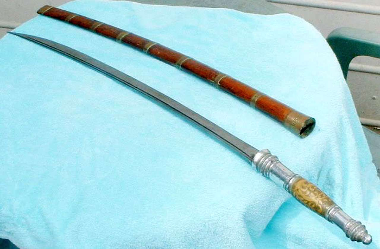

The hilt is very much like mine - see the photos in post 15 in this thread: https://www.vikingsword.com/vb/showpost.php?p=180723 - the main photo is below.
Mine has a more traditional blade and scabbard, shows a peacock bird in the brass/bronze section and also has a burmese/mon inscription on the silver section...and no western lettering.

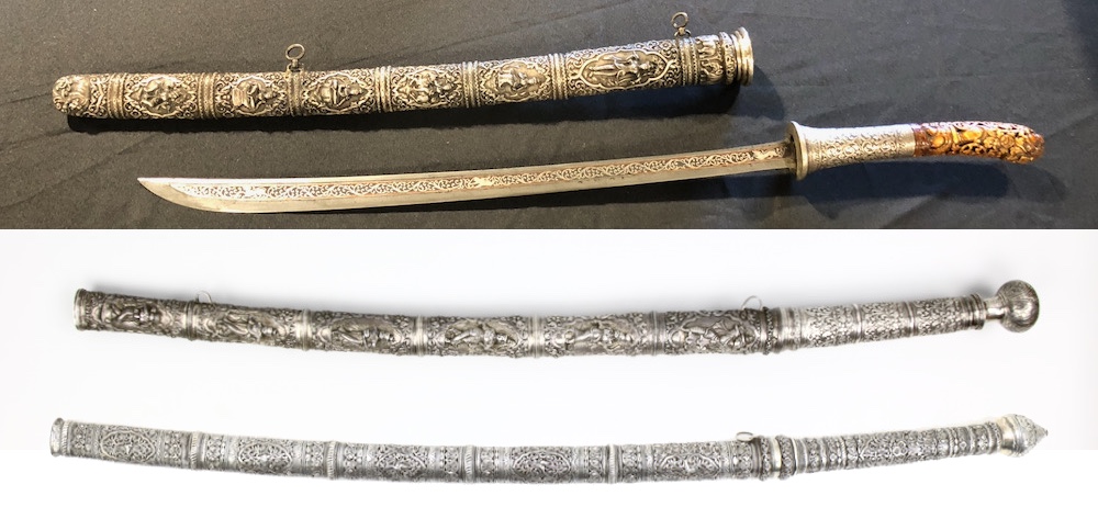

This widely spaced layout of two rings to hold a cord or strap does seem to be part of a somewhat older tradition. It is seen on a number of large presentation dha from the late 19th to the first decades of the 20th century.
Among the ones I have had were at least two that were made for locals, by virtue of their inscriptions. The first had references on the blade to a general that fought the British fiercely, another the name of Maung Po Min, a Shan aristocrat. Both swords were probably from the 1920s or 1930s, exhibiting the typical high-level silver repousse work also seen on bowls from that period.
A last one (bottom) is somewhat earlier and indeed made for a foreigner, Sir Owen Tudor Burne (1837–1909). This one, oddly, only has the ring at the top.
I am not sure why the suspension method on this type differs, but just to illustrate it's not a fantasy feature only seen on low-grade items. I think it was perhaps because these were meant to be carried by someone other than their user, and thus not worn "at the ready" like someone would wear his own sword. But that's just speculation.
