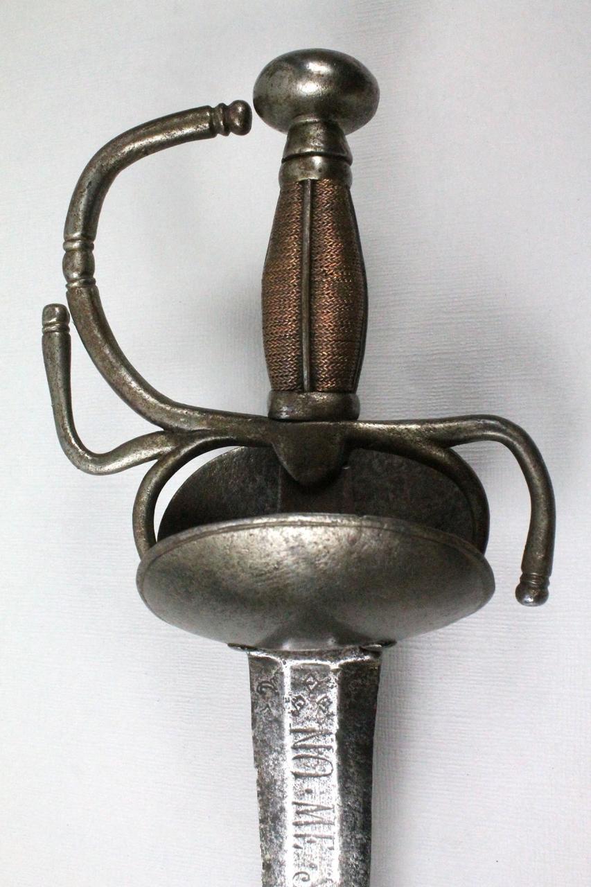

I am just the winner in an online auction for a Spanish 1728 cavalry officer sword.
There was something strange at some points. Too perfect workmanship and an unusual blade model, marked X EN TOLEDO X. The sword has surface black spots, but no pitting. Price was slightly on the cheap.

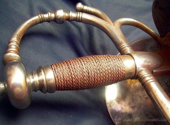

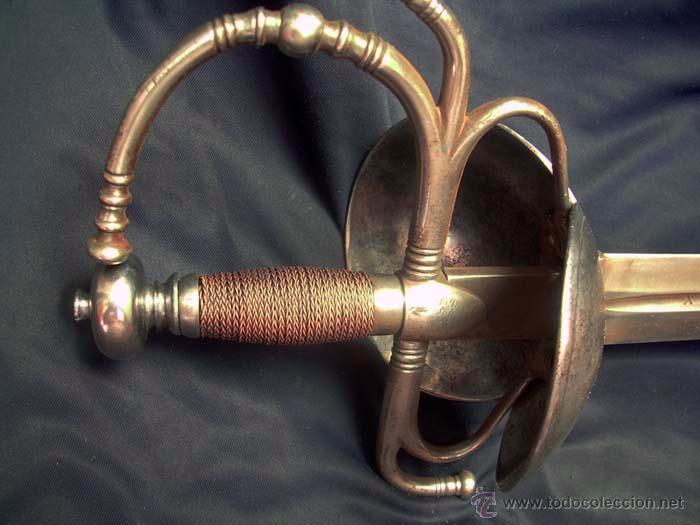

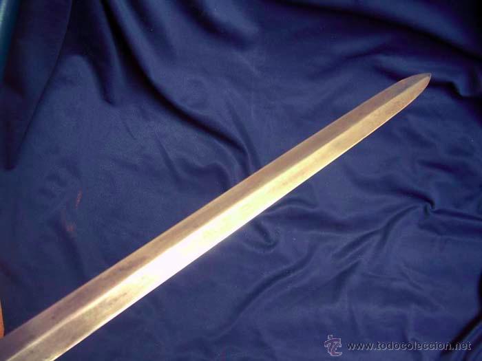

I started looking through the picture collection until I found an identical one in pristine condition, sold 6 years ago. They seemed like the same sword, but in the older pictures it seemed newer, too incredible new, actually. The weathering on the auction sword maybe it is not 200 years old but it is consistent and not recent.
And then I found it. In 1910, The Toledo factory made a copy of the 1728 model that can be found at that year catalogue (number 83).
https://www.toledo.es/toledo-siempre...te-hacia-1920/
I am not sure what to do. Honour my bid or tell the auction house they are selling a replica as the real stuff.
The 1910 copy is extremely rare. And the workmanship the Factory put in these swords was amazing, nothing comparable to the usual Toledo wallhangers.
As I collect both, 1728s and Toledo factory products, the thing would not be out of place, actually. I already have another similar to number 86, but this one is marked as from the Toledo Factory and dated 1881. I have another, number 97, that is also properly marked with the factory stamp after 1943. But it seems those from 1910 can be deceiving, or the stamps have been erased.
I will hang the pictures of the sword when I have decided. I understand replicas shall not be the proper subject of the forum and I have not problem if this is moved.

Other than the new-ish grip wrap, what is the giveaway here? Looks like a nice period sword to me.
Old 30th May 2021, 03:12 AM   #11
M ELEY
Location: NC, U.S.A.
Posts: 2,236
I concur with Dmitri. It looks of the period to me except for the wire wrap-

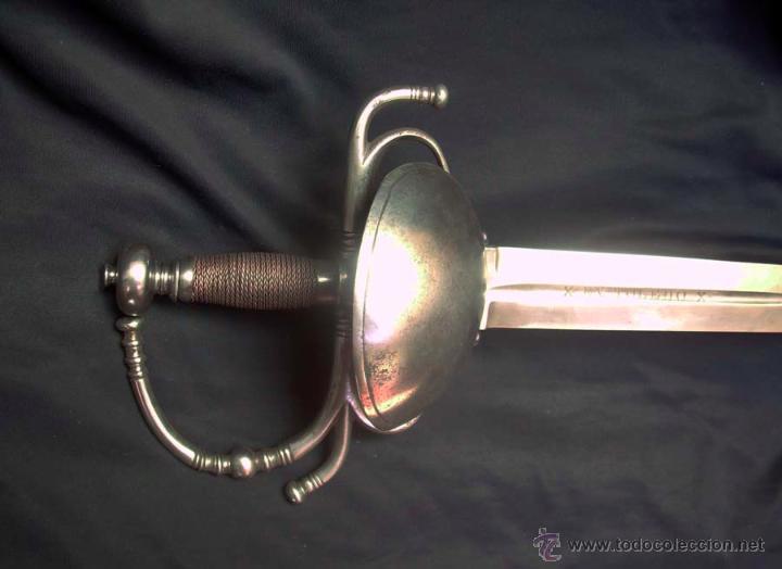

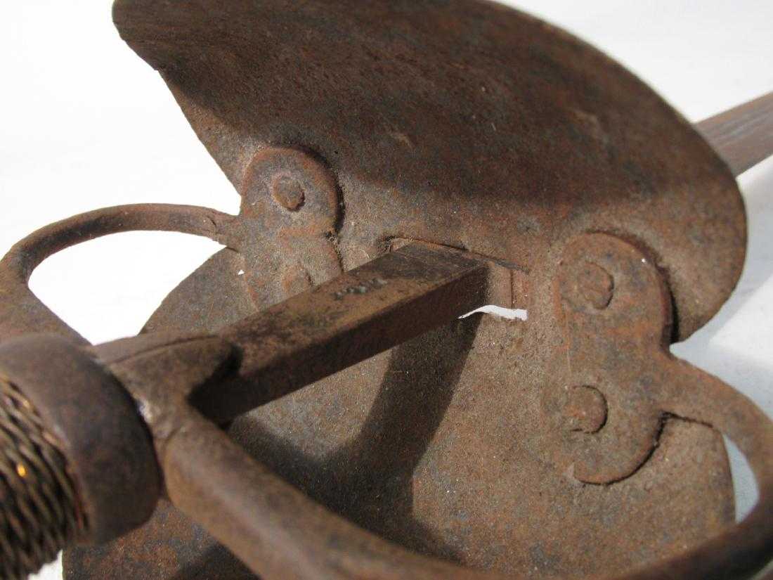

There are two problems here. The first one is that the cross is of the wrong shape and too perfectly executed. I have never seen a real XVIIIth century 1728 where the transition from the round quillion to the shields surrounding the cross are perfectly simetrical. Usually this is made by soldiering two shield-like pieces to the usual cross. Here, this has been made by adding the quillions to a slightly oval cylindrical piece. This can be seen at the 1910 catalog too.

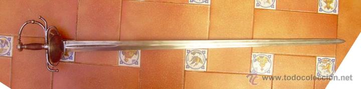

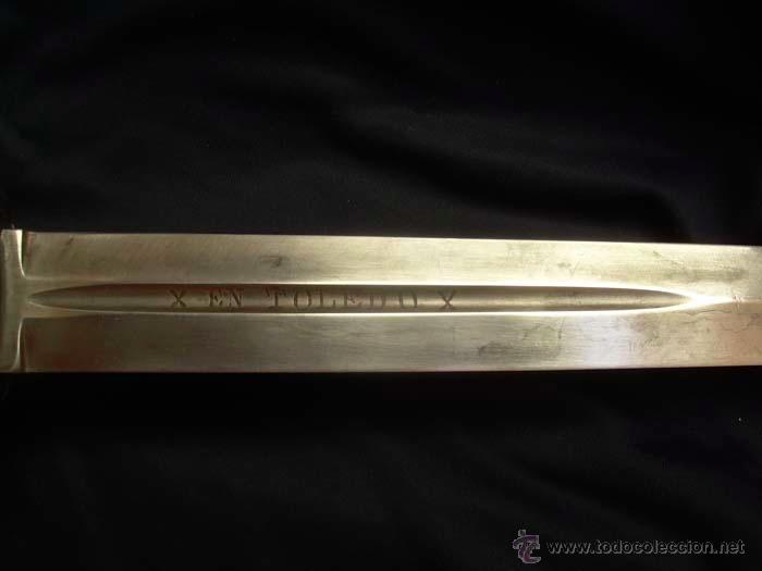

The second problem is the blade motto. The blade shape is typical from the period shortly before the refoundation of Toledo, 1740-1760, or rather earlier. If the motto would have been x EN SOLINGEN X or X KEISER X or X ENRIQUE COEL X. But that is a blade (and hilt) typical from a time when Toledo was functionally dead.
I believe the 1910 Fabrica de Toledo replica was made copying from a real sword, but this sword sported a Solingen blade, and they wrote instead X EN TOLEDO X.
The only X EN TOLEDO X large cavalry blades I could find were copies of the 1796 model made at the end of the XIXth century and this other next sword, sold some 6 years ago.
It is so much similar to the sword auctioned this week that it could be the same sword, just before being forcibly antiquated. Or it is a twin of the 1910 replica. I repeat, I have not seen that X EN TOLEDO X blade on a 1728 outside these two (one). I do not believe this has 270 years.
I believe the now defunct Madrid Army Museum had a number of the 1910 replicas used to dress mannequins with period uniforms, but as I do not live in Madrid I was a bit unaware of the danger of these replicas. Specially if antiquated.

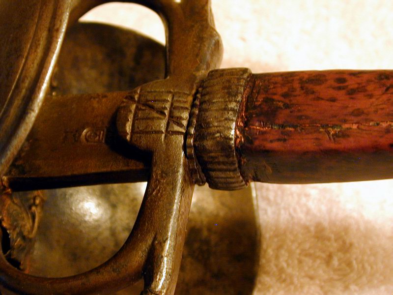

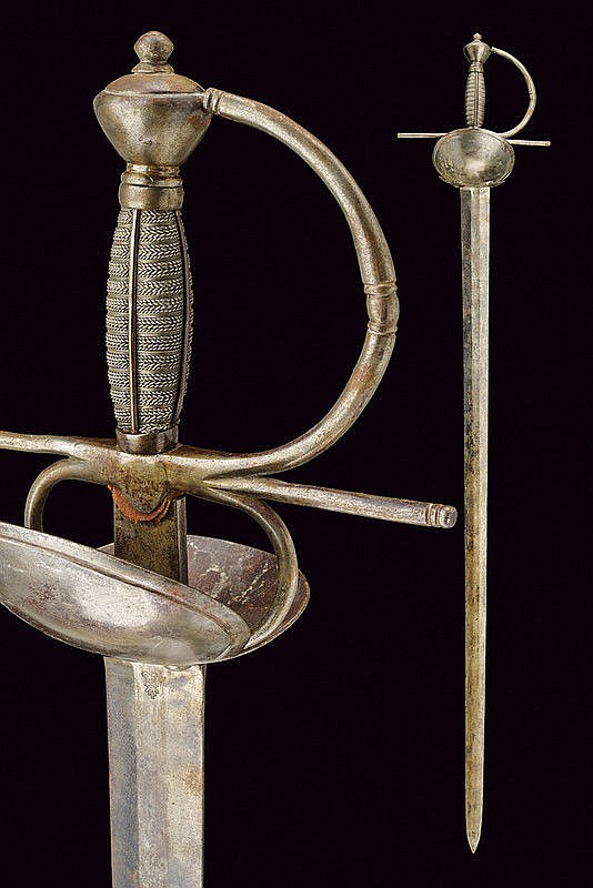

Just to show the point of shields at the cross.
Officers swords (and Guardias de Corps) have often a shield with a lyra like form. Troopers and some officers swords have just semicircles.
