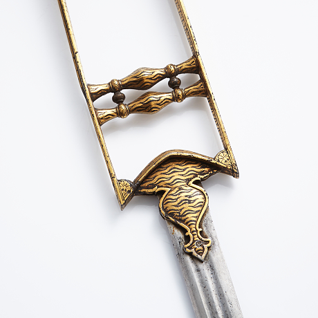

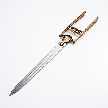

Stockholms auktionsverk held an arms and armour auction today. Among many fine items was a beautiful katar. I had a very low estimate so I kept my ey eye on it. And it went for almost a 100 times the estimate. I can see that its a very fine item. And if it is old, 17th century, then the condition is really good. But I feel I´m missing some vital information to why someone would pay that much for it. Can any of the more seasoned collectors of indian weapon enlighten me as to why this katar is so desirable?

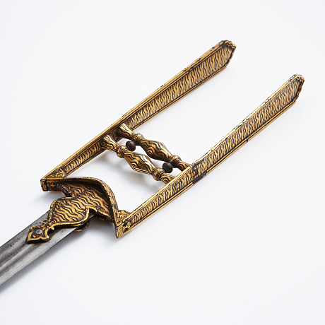

Interesting Katar, looking at the typical and very scarce tiger pattern in koftgari, I would suggest this Katar was probably linked to 'Tipu Sultan' the 'Tiger of Misore' many of his personal collection came on the market and most items went sky high at auction.
The Mysore reign came after the Vijanagagara empire and Tipu Sultan defended the empire against the British, but died during the Anglo-Mysore war in 1799.
He had his own arsenal with very high quality arms and armour, many of these were decorated with tiger stripe motifs. These items were confiscated by the British and are very sought after by collectors. The motif used is called 'Babri' or 'Bubri'
The riveted blade and style tells us this Katar is made in Southern India, which is another clue to the Tipu Sultan.

Even if one pays more than current value these items will reach that value and surpass it in time. I'm not in that league spending 10's of $1000's.
The rivet through the blade is not professionally done and most likely a later replacement but would raise the question of the blade being original to the hilt.

It's decorated in bubris or tiger stripes.
I didn't read the description but bidders probably assumed it has
some connection with Tipu Sultan.

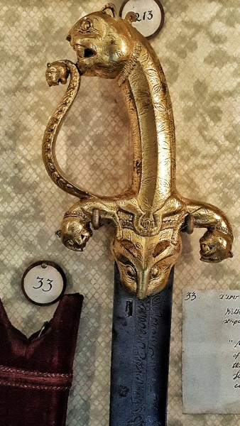

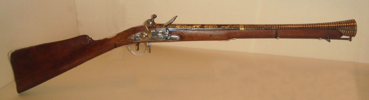

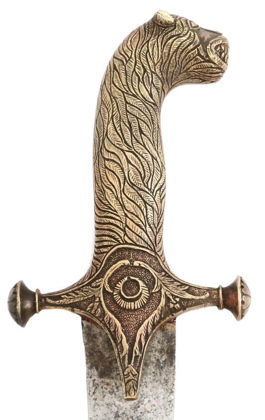

If I had to guess, as a collector that does focus mostly on Indian weapons, the reason for the inflated price on this katar actually does come from (as Drabant suggested) its tiger stripes. These stripes are famously associated with Tipu Sultan, an 18th century South Indian ruler that was known for being pretty much being the last source of Indian resistance (and indeed the last independent kingdom) in South India against British expansion. He was known for being quite fond of tigers, and as a result had tiger faces and stripes and all sorts of tiger-related imagery on his possessions. For ease of reference a blunderbuss that is known to have been owned by him is attached. The problem with this is that, given his prominence in Indian history, his name and things representative of him (i.e. the tiger stripes) are then frequently attached to things in order to increase their worth, often quite dubiously as it is next to impossible to tell if a weapon was really owned by him or not. As a result, there are several "swords of Tipu Sultan", as well as guns and other such things that all have tigers featured on them in some way (attached is one such sword with very obvious tiger imagery). An example of clearly fraudulent attribution can be seen on Faganarms, where they justified selling a sword with a (relatively) roughly cast and decorated brass hilt for over $3,000 on the basis that it had a tiger-head pommel and "stripes" going down the handle (see https://www.faganarms.com/products/a...of-tipu-sultan, though a picture of the hilt is also attached). Though this katar is way more likely to have been owned by Tipu, it is at the same time entirely possible (I would argue, anyways,) that the koftgari artist that decorated it was simply a fan of waves.
Regardless though it certainly is quite a fine katar.
