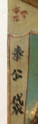

Hello friends. Greetings from Manila. My first post. I bought this beautiful blade recently- I can't identify it properly. My gut feel tells me it is a Lumad Tagakaolo bolo (but i'm not really sure). It has Japanese (or Chinese) characters on the scabbard, and on the blade itself - plus a pagoda.
Could this be a war trophy of a Japanese soldier (if the characters is Japanese)during WW2 and recaptured back to the US forces? Are the characters Japanese or Chinese? what does it say/translate?
Really appreciate any feedback/info on this lovely blade.
Regards and keep safe,
Yves

Here is the inscription, rotated and sharpened...

This is extremely interesting! Black characters 奉公袋 in Japanese read "hokobukuro" and mean "service records bag" http://www.nambuworld.com/hokobukuro.htm
I don’t understand how these scabbards and the Japanese soldier’s bag are connected, and this is a very interesting case!
For red characters, a separate photo is required - now it is impossible to read them.

Very cool knife , even with the odd translation

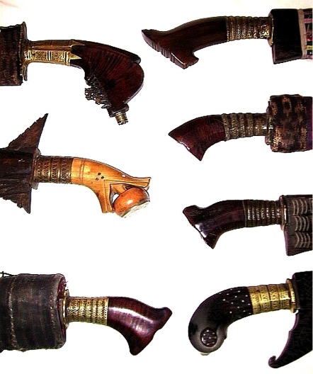

Hello Yves, and welcome to the Forum!
Thanks for posting this very interesting example. The only thing that is definitively Tagakaolu/Kaolu on your piece is the hilt. The curious "ears" to the pommel are uniquely Kaolu as far as I know.
Attached is a picture showing various hilts from Bagobo/Kaolu swords. The oldest is the traditional Bagobo hilt in the upper left. In the bottom right corner is an example of the same form of hilt as shown on your bolo.
In looking at your sword, the edge appears to have a prominent bevel and I wonder if it has a chisel grind. This would be very unusual for a Kaolu blade as the Bagobo/Kaolu knives and swords have a V-grind. If it does have a chisel grind, then the blade is likely Visayan with a hilt from the Kaolu. Since the Kaolu live on Mt. Apo, a dormant volcano on the outskirts of Davao City, and a large population of Visayans live in Davao City, it would not be at all surprising to see a combination of a Visayan blade and a Kaolu hilt. That blade form is certainly produced in many Visayan areas. Overall, I think your bolo was a working tool, as evidenced by the many knicks and chips to the blade, rather than primarily a weapon. The humble, roughly carved hilt, would fit with that use also.
The scabbard may be Kaolu but has been decorated by another culture. The Japanese inscription suggests it was the product of a Japanese soldier during WWII, who perhaps adopted the bolo as his personal jungle knife or machete.
A very interesting piece. Thanks for sharing the pictures.
Ian.

Welcome to our little forum (and Mabuhay!)!
I totally agree with Ian. All I can add is that the manner of the carvings, the paint, and the manner of blade was made all point to me to WWII.
And I agree with you that many weapons (including copies of Japanese katana) were made locally for Japanese soldiers during the occupation.
