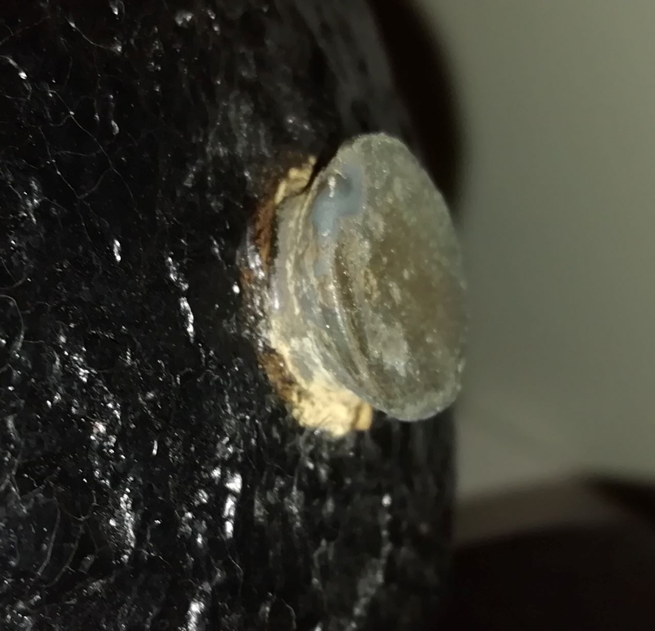

Hi,

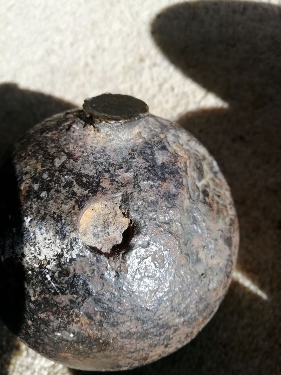

Are these cannonballs? They are cast iron. I initially thought they were ball grenades, but they are completely solid. I haven't seen a cannonball with what looks like a bronze stud in it before.
Each are just under 3.5” in diameter making them 6 pounders.
Can anyone shed some light on these?
Thanks

Hmm. Those are interesting. My initial thought was that they might be one of the many cannonball look-alikes (shot puts, counter weights, etc), but then I wasn't so sure. Could these be coehorn shells filled with metal? I've seen this before. I once had a Confederate shell filled completely with lead. The protruding bronze could be sprue? Or were they bar or chain shot, but cut down over time? Or are they just the top of a flagpole? Hopefully those more knowledgeable on ordnance will chime in-

So you've got a riddle there
If as you say this 'thing' has circa 3 1/2 " as for a 6 pounder solid shot, it should weigh circa 2 600 grams (5 3/4 pounds).
If it were a howitzer ammo (bomb=grenade) should be much lighter, even if fully loaded with explosives.
But then, being a solid shot, it should (could) have a visible seam mark from the casting and, what looks to be a fuse plug ... is not.
Could you tell us more about the 'bronze' studs ? Do they appear to be 'unpluggable', or do they look definitely fixed ?
You know there are iron balls out there made for purposes other than ammo ... like windmill vane counterweights and other.
I am certain not to have helped a lot ... but i have tried hard .

Many thanks

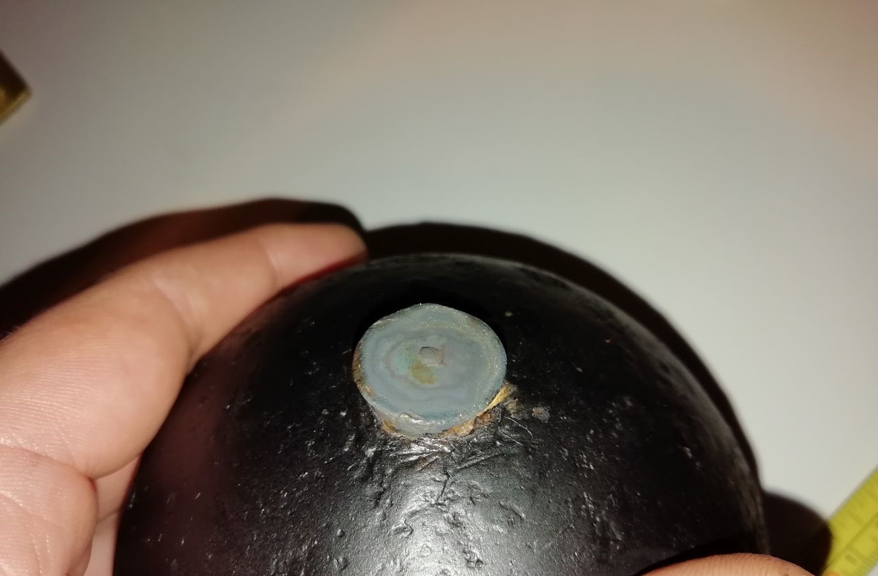

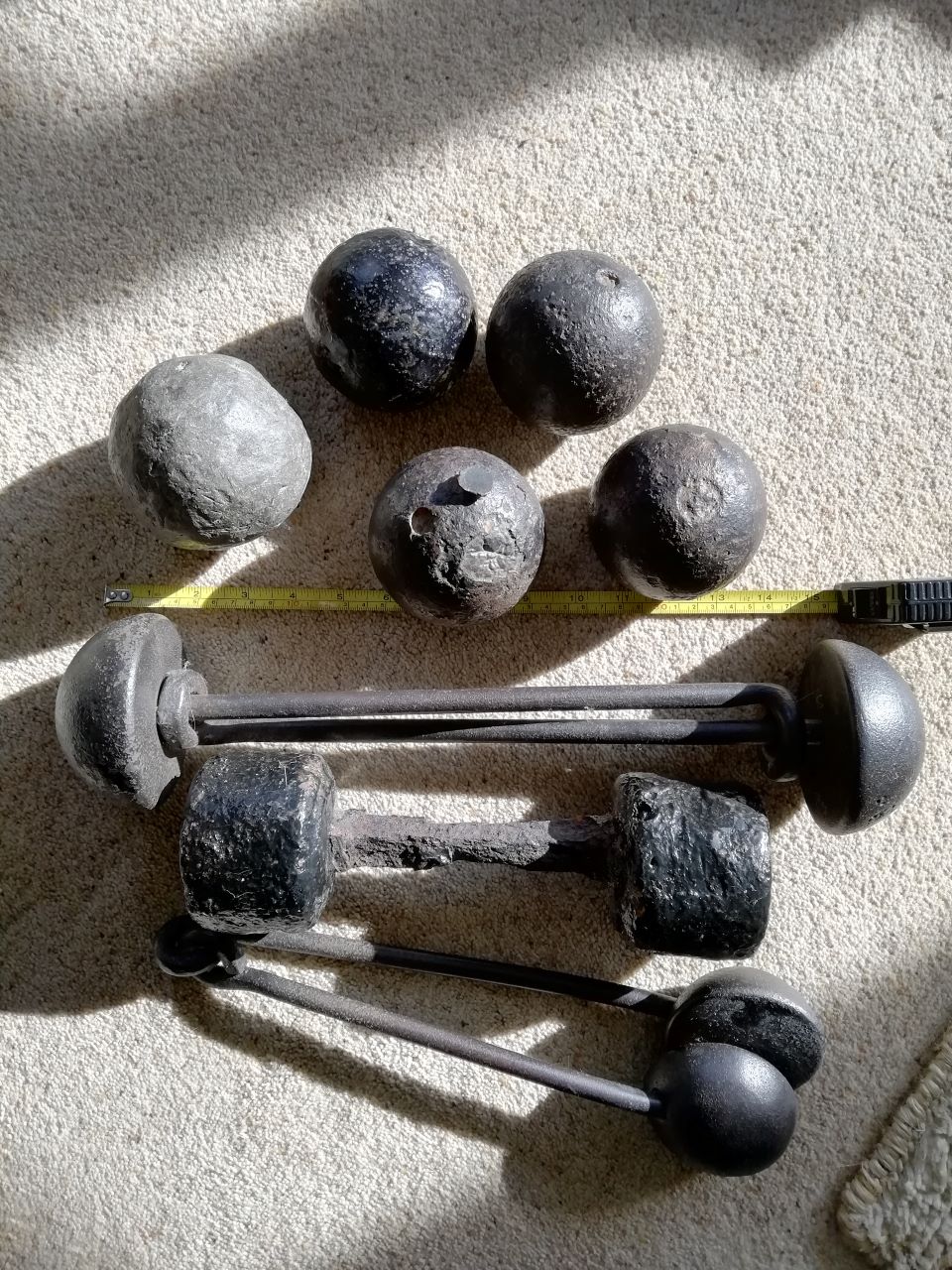

I got a chance to have a look in an old museum collection today and found another 6 pounder and a 24 pounder, each ball with a similar stud (1st attached image of the museum’s 6 pounder, 2nd the 24 Pounder). Sadly, no further info available. What are the odds of the museum also having such similar balls?

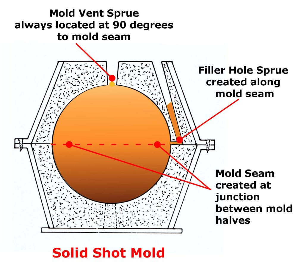

Fernando, thank you for the image. The studs must be part of the manufacture process. It vaguely looks like the mould seam runs around the balls’ circumference, 90 from the stud but it’s hard to tell. The stud is very solid and sprue-like, roughly 1/2" wide. M ELEY, all of those are ideas seem quite plausible the 3 1/2 ”-ish ball with the stud weighs 2707g, I also have a known 6-Pdr wreck recovered ball which weighs roughly 2300g so maybe the stud one is filled with bronze? There is only 1 stud, same with the examples in the museum.
Also attached is an image of some bar shots acquired at a similar time.

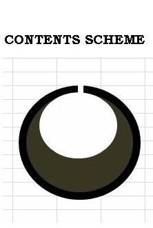

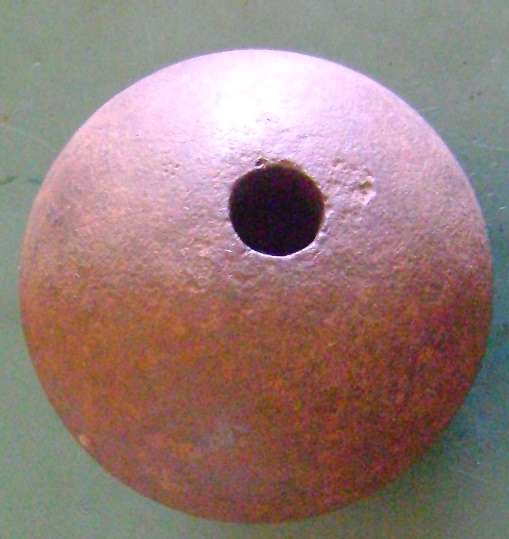

If it is filled with lead grape shot leaving some void area, the resulting density might be similar to if it were solid steel. Or maybe it is a cannon ball but a replica just made to look like it is hollow.
Google images ,cannon ball plug hole, cannon ball wooden fuse, etc and you'll see other examples that look like yours. Click the images and many will lead to further discussion. Apparently one hole was a fill hole and one hole was a fuse hole that was kept plugged until use.
