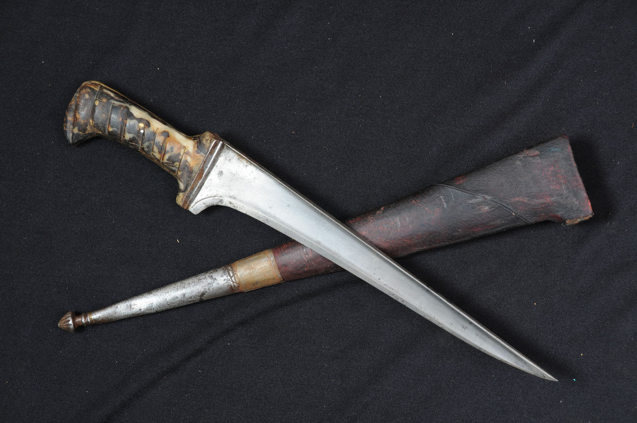

One week ago I got the wootz knife, I believe of Afghan Origin.This is not a pesh kabz or karud. I wonder if this knife has its own name.

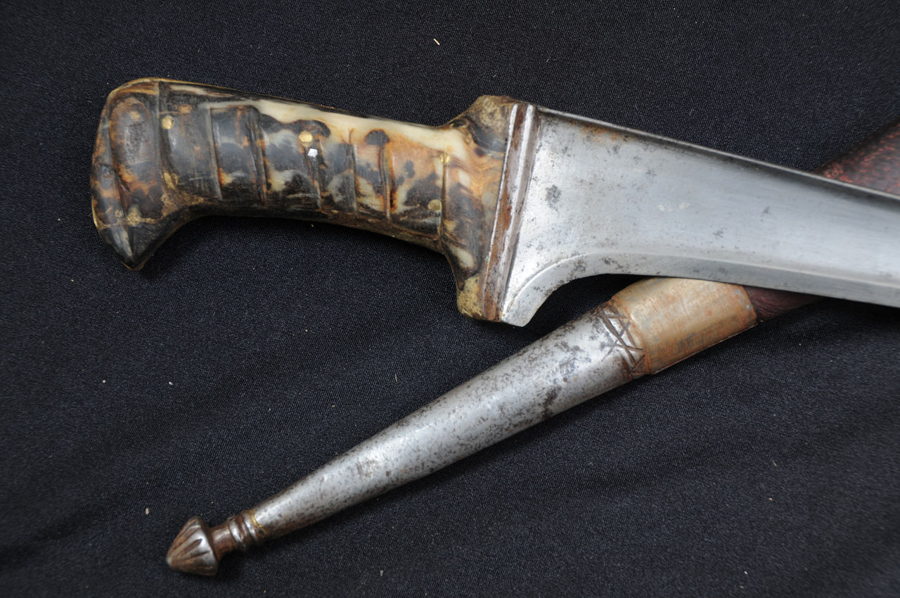

I once had an Afghan knife with a similar handle. The spine of the knife's handle was below the spine of the blade. What is it? The peculiarity of the handles of knives of a certain people?

As you can see from Detlef's message, the first one is a Pesh-kabz. It is a rather unusual variety but it certainly displays all the features of the Pesh-kabz. The blade is almost certainly Indian.
The second one I would call a "Karud." The name "Karud" refers to a straight-bladed Pesh-kabz and it might be simply a misnomer derived from the Persian "Kard."

Detlef, mariusgmioc thank you for reply. So that is nevertheless pesh-kabz. And what about the handle? For what people or region is it typical? I suppose the origin of such a handle is somewhere in Afghanistan.

Yes, I would agree by this statement!

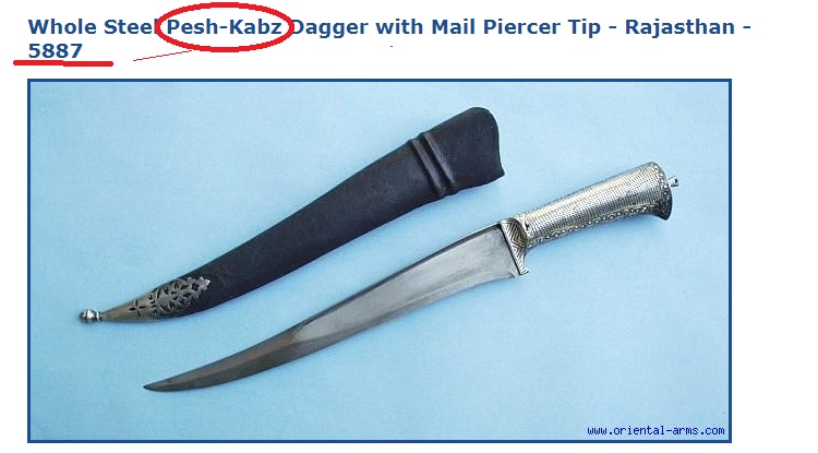

Dear Marius.
Correct me, please, if I'm wrong (I know English badly). But, it seems to me that it is very difficult to confuse the words "Pesh Kabz" and "Zirach Bouk" ... And I see that the respected Artzi, at objects numbers 5886 and 6971 wrote: "Pesh Kabz". Maybe I have problems with vision ???? I worry....

Dear Ian.

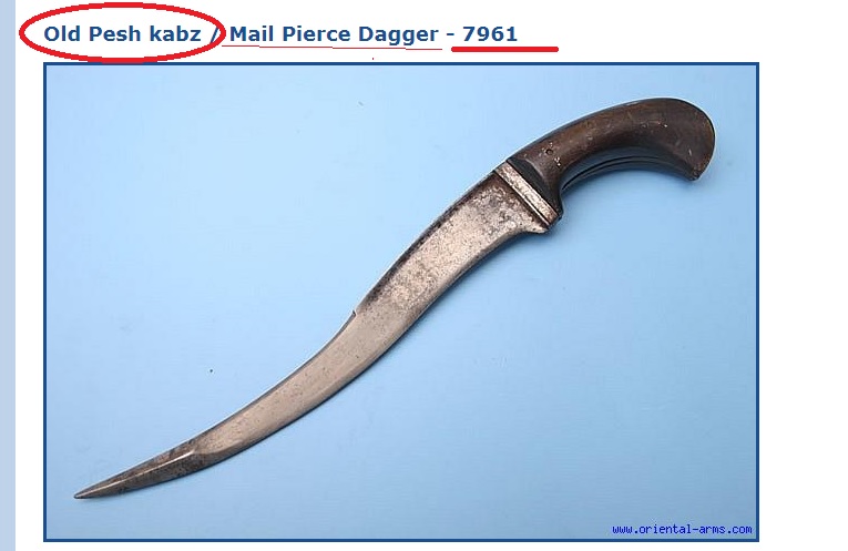

Here is what Artzi writes, in the description of objects 5887 and 7961, calling them Pesh Kabz:
"The last 2 ½ inches are swollen to a heavy diamond cross-section tip in a typical Zirah-Bouk (Mail Piercer)". By the way, the term "mail piercer" is written on the website of Artzi
That is, it's Pesh Kabz with a point like Zirah Bouk.
But, of course, it is ideal to ask the opinion of the highly respected Artzi.

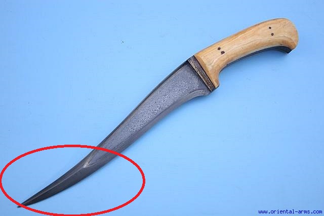

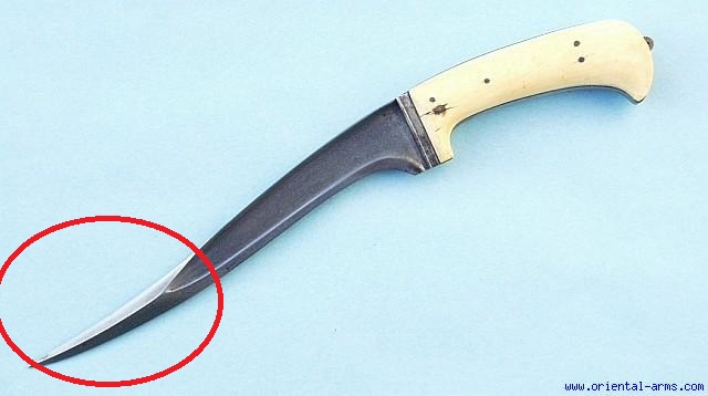

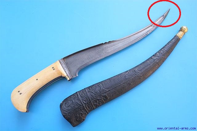

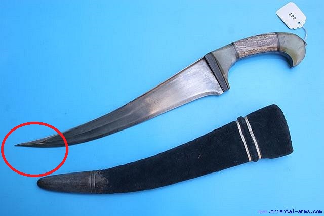

Look, please, here are these items:
http://oriental-arms.com/item.php?id=4441
http://oriental-arms.com/item.php?id=2199
http://oriental-arms.com/item.php?id=2942
http://oriental-arms.com/item.php?id=896
http://oriental-arms.com/item.php?id=5642
http://oriental-arms.com/item.php?id=1907
http://oriental-arms.com/item.php?id=1491

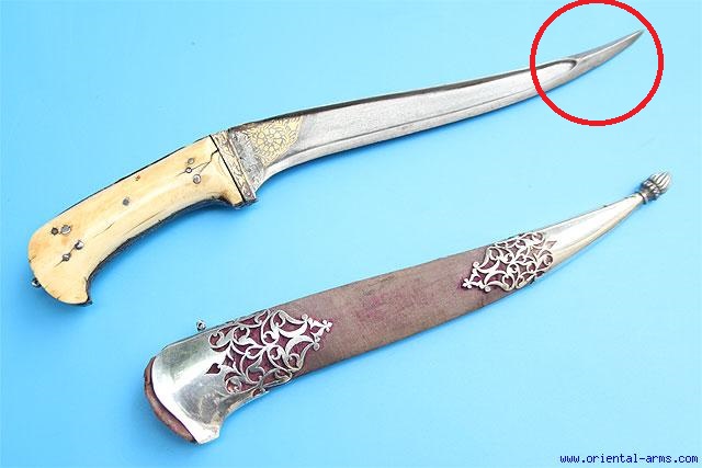

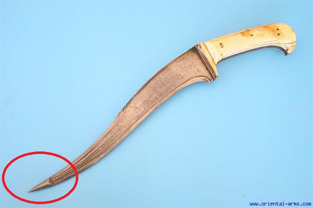

Probably, following the opinion of the respected Ariel, all these daggers should also be called Zirach Boke? They all have - massively swollen reinforced tip (larger or smaller):

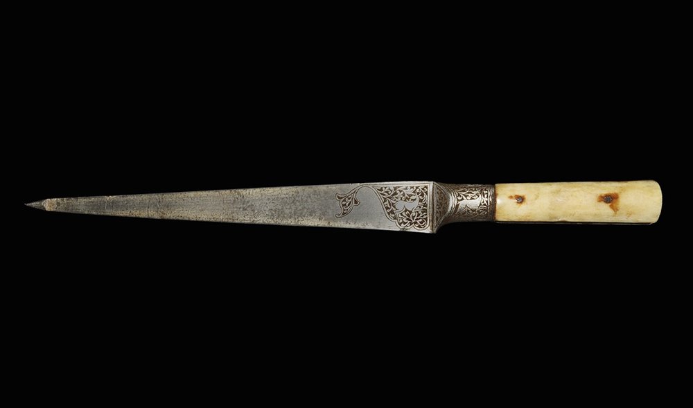

Old 9th August 2018, 07:41 AM   #13
mahratt
mahratt's Avatar
Join Date: Nov 2009
Location: Russia
Posts: 1,042
Originally Posted by ariel
Also, see one from the Met: https://www.metmuseum.org/art/collection/search/31537 ( Stone's bequest).
Thank you for a good example. This - Zirah Bouk. But not Pesh Kabz. I think now everyone can see the difference
