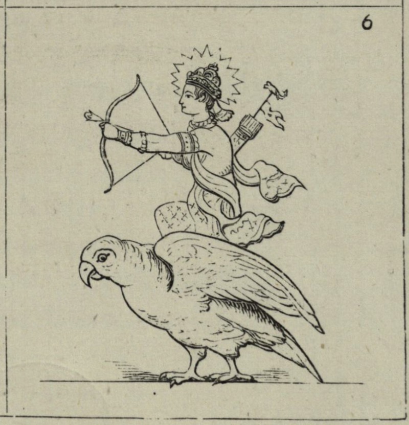

Ibrahiim al Balooshi
Ibrahiim al Balooshi's Avatar
Join Date: Jul 2006
Posts: 4,408
I noted a peculiar similarity on an Indian sign....A Parrot !
Kamedev on parakeet.
