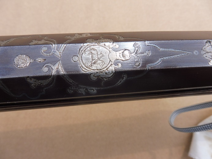

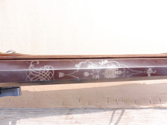

Thank you for the information on the Spangenberg Family, i did a quick search for them and it seems they did more of these quality guns trough the ages.
Attached are a few pictures of the inlaid barrel. It bears a well known picture of a lamb with banner signifying the son of God.

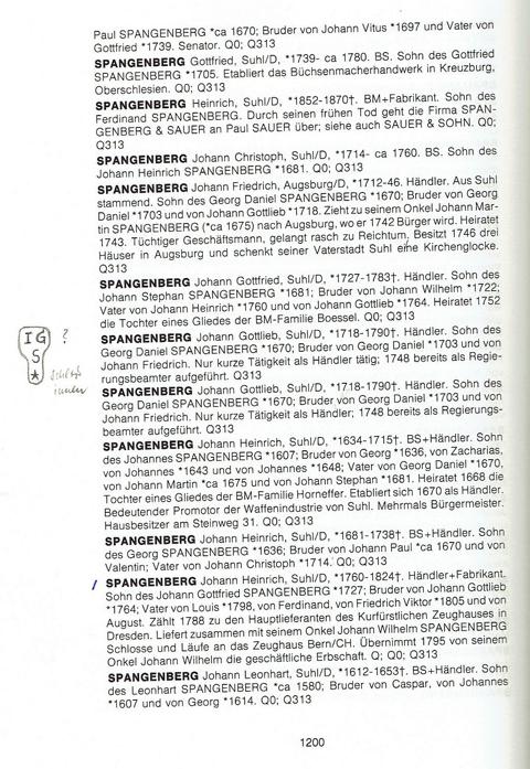

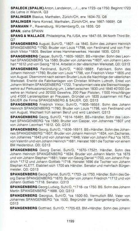

Could i bother you with a request? Could you photograph the pages with information on the Spangenberg family for me and post them here or send them to me?

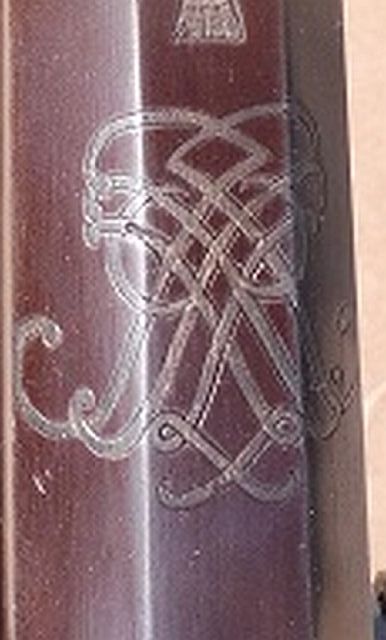

Here come the wanted pages. But far more interesting and not mentionned by you is the monogram on top of the barrel. It is to be red "JP" and probably stands for JOHANN PHILIPP von WALDERDORFF, bishop of the bishopric of Trier in the years between 1756 to 1768.
This date helps very much in identifying the gunmaker: The only G.Spangenberg under the reign of this bishop has been GOTTFRIED SPANGENBERG, working at Suhl between 1739 and 1780
