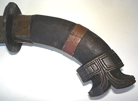

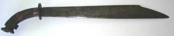

Back home again and recieved this eBay sword that probably some of you recognise?
It resembles the Bagobo Golok pictured in Stone p. 249, except missing the large cast brass piece on the handle.
Searching old forum threads it also resembles the Mandaya/Manobo swords that Ian and Rick has posted.
http://www.vikingsword.com/ubb/Forum1/HTML/000548.html
http://www.vikingsword.com/ubb/Forum1/HTML/001052.html
The seller, who is a member of this forum, wasn't convinced that the scabbard matched the sword.
But I find some of the patterns on the blade similar to those on the scabbard? And the blade fits the scabbard.
Look forward to all comments.
Michael

Old 22nd April 2006, 10:56 PM   #5
Posts: 4,748
Default Maybe N. Borneo
Michael:
I'm confident your sword is not Bagobo. Apart from the fat bellied blade, it has no features of Bagobo work and the scabbard is wrong.
I'm going to suggest N. Borneo for this one, primarily because of the blade decoration. An old thread on the previous Forum included examples of N. Borneo blades that had similar dot designs. These were recently made blades for the most part, but they seem to resemble the designs on your blade. That thread is here: http://www.vikingsword.com/ubb/Forum1/HTML/001304.html
John might have some further thoughts.
Ian.

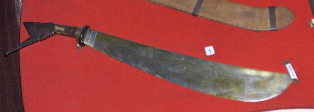

Hello VVV,
Here is a very similar piece to yours with a kampilan style blade.
