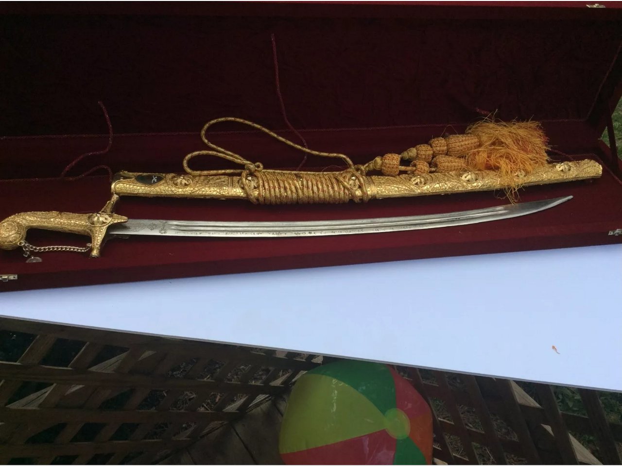

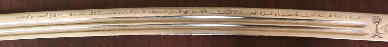

This is a Saudi presentation sword that I believe was made between 1950 and 1970 (the 1928 "sovereign" can be safely ignored). That is just a guess that I base on the quality of the sword. I've handled enough of these now to understand that, generally speaking, the older they are the better their quality. This is a heavy, solid, well made sword that I am happy to have in my collection. I could use some help though with the Arabic text running the length of the blade. TIA!

I just now realized that I forgot to post a photo of the entire sword. Attached. Thanks.

One more photo showing the entire text.

Interesting piece, while its very present in the peninsula through out the 70's and 80's it is actually made in Syria for decoration. Sometimes it makes its way into collections by being gifted around as a cheaper and easier to find alternative to the ones made in the gulf (or the older, finer bladed Syrian examples)
The form does not follow any traditional form, the all filigree mounts are not present in historic arms in the gulf or Syria.. but it looks nice. And now who ever made them in Syria is not making them again.
The hilt form copies the Ottoman populous design.
Translation:
"The sword is glory that you hold,
Glory is not attained by weakness.
And in swords is the defence of Arabs,
And with swords the defence of Arabs and the homeland."
the poem is what you expect from a time period in which Pan-Arabism was still going strong and it makes some critical errors in the Arab language.
A good example for what it is, and these are getting more rare with time. But not exactly a real sword.
Edit: I forgot to comment about the Saudi emblem. The Syrian makers offer custom jobs to their target markets. There are examples around with the Kuwaiti emblem as well :-))

Thank you for the translation! I agree completely that these are meant for display only. I am surprised by how much their quality varies. This is the nicest one I have handled and is good enough quality that I plan to keep and display it. I always figured they were made in Riyad. Thanks for correcting me. I tried to buy one almost exactly like this one about two years ago and was outbid. It may have been this one. The seller's story was that it was given to a Shell Oil engineer by SA in the 1950s. If it is the same knife the story did not transfer with this sale.
One more question: the scabbard locket is stamped with a '90' just above the SA emblem and where it is not seen when the sword in sheathed. Does anyone know what that might mean? Thanks again. Much appreciated.
