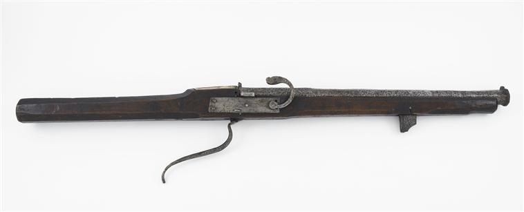

Anybody know anything about this arquebuse? Is it fake or real?
http://peashooter85.tumblr.com/post/...middle-ages-or
"A matchlock musket from the Late Middle Ages or early Renaissance, 15th century."

Difficult to say, i wish there where more pictures. What we can see however is that the piece has been cleaned, probably with acid. Stripped from all its original patina.
The barrel is in the style of the 1470-80s with the octagonal barrel with the flats turned halfway down. Also the swamped muzzle, beeing a predecessor of the maximilian barrelcrown. The barrel hook is far on its way towards the muzzle which is also a later charasteristic.
As to the stock, hard to say.. can't remember any manuscripts with such a stock, seems a bit hard to handle as well. The tinder holder looks more like those from Indian and middle eastern type matchlock guns, by that time they would surely have made something different.
All in all i would not touch it, especially not before having better pictures.

Would it be expected to find a barrel hook on a gun that looks so small? I thought that these hooks were needed on much larger pieces, to brace the barrel and forestock against a parapet so that heavy recoil wouldn't bother the shooter. If I am mistaken, please advise.

it is true that hooked barrels where mostly those of heavier/larger pieces like the haquebuts. There are though also quit a few examples of smaller hooked guns, some of them recieved a hook at a later point in their lifes.

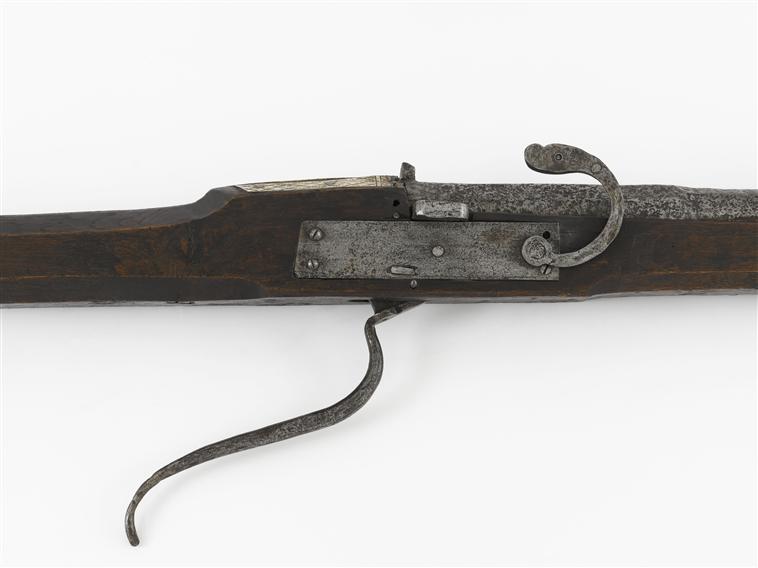

One piece in particular is worth noting, this matchlock arquebuse in the Musée de l'Armée in Paris (museum of arms). They have put a date of 1470-1500s on it but i think that the whole contraption is from at least after the 1500s and the lock has been replaced or at least the serpentine has been along with the original square screws/nails.
This as well could be a total historismus piece with just an original but heavy cleaned barrel (the barrel has been cleaned, but heavy pitting is left, while on the lock and trigger there is far less corrosive damage).
Good pictures is very important and also a good background wich we can find in this ever progressing forum

gentlemen, it would be interesting to see the touchhole of this barrel.the way of ignition looks suspicios to me ,i find nothing in the collection of Mr. Michael Trömner, which is very well documented in this forum and till now has been a great help for me,looking that way.the barrel itself and the hook (Haken) ,as seen from the ship, look gothic. i wish a good evening! iskender
