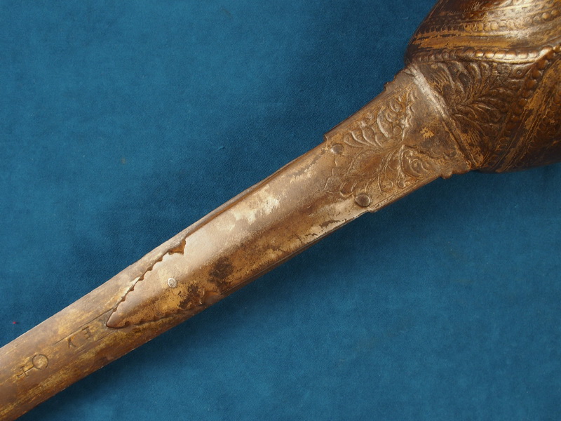

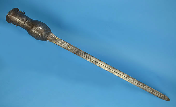

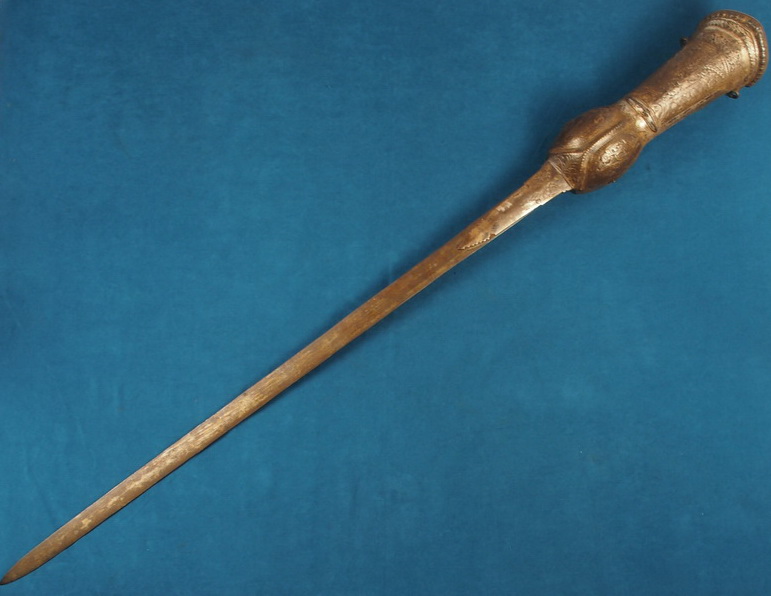

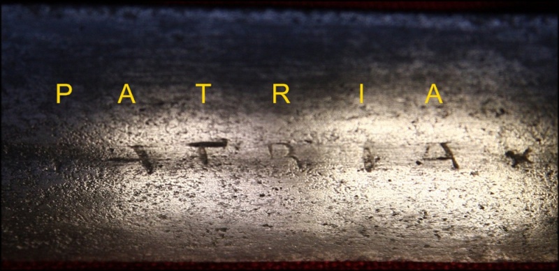

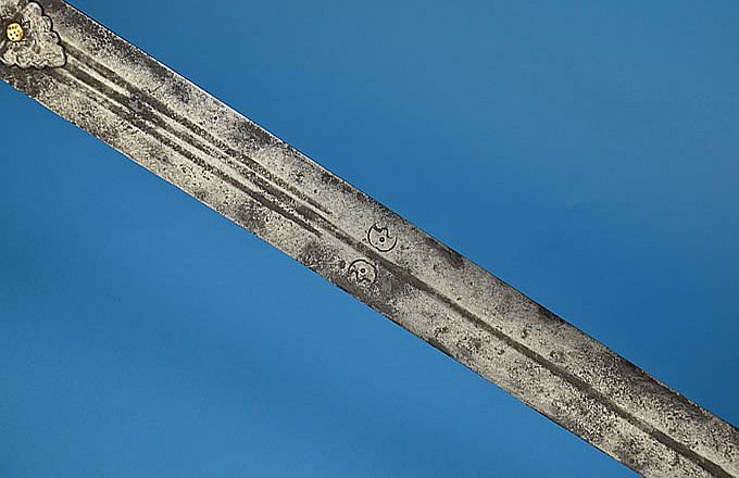

Salaams Mercenary.. Nice example ...This is a Portuguese blade.(Del) Rey inscribed on blade at 4th picture. It is noted that the three primary reasons why they were in the Indian Ocean region was because they sought Gold and Silver, Spices and Mercenaries. In addition, they took a lot of their Mercenaries from India...as well as the likelihood of a blade transition through trade.
Interesting; what look like Dukari Moons locally applied.
Ibrahiim al Balooshi.
