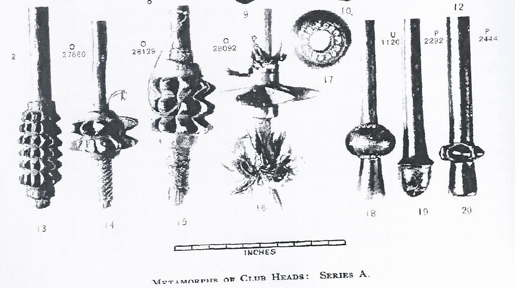

Illustration from "club types of nuclear Polynesia, William Churchill, the Carnegie institution of Washington 1917" clubs Pennsylvania University Museum.
Nos- 17, 18.
