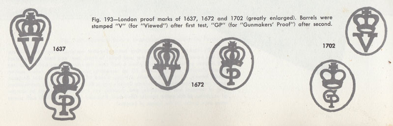

After Blackmore, British Military Firearms these proof- and view marks of the London Gunmaker's Company are from about 1740. I think this is a turn off barrel of a Queen Anne pistol.

Doesn't it look like the more simple crowns in both marks correspond to the later 1702 version shown in your post #3 ? .

I agree but if you look at the relationship between the GP and the crown on the 1702 version the crown is considerably larger than the GP and on my version it is the other way round . I never know how literally we should take these things as published marks are presumably taken from dated examples and proof stamps must have had to be constantly re - made . I cant imagine engravers going to great lengths to ensure stylistic consistency. My argument for a seventeenth century date is simply the thing has a restoration feel about it . By the end of the century English gunmakers had evolved a more austere and confident approach based on elegant lines and sound craftsmanship . Having said that there were plenty of continental gunsmiths working in London at the turn of the century so maybe that accounts for the decoration.
