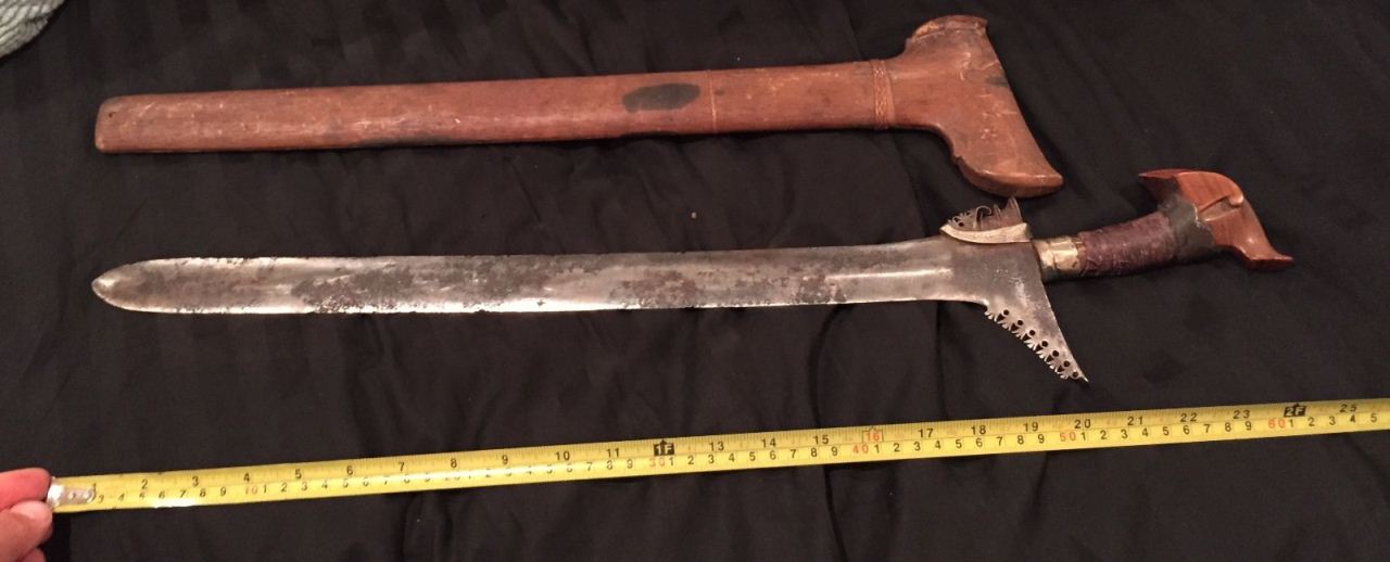

Just won the auction for this. The whole thing's about 60 cm long. The blade's pretty rusty so I can't see any evidence of pattern welding. I don't see a separate ganja either. The fittings look silver
Is this an "archaic" kris, which I understand were very small, or a post WW-2 child's kris?

I'd call it diminutive; it shows age but not any features that could be called archaic IMO .
Maybe it's a kid's sword .
It looks like it does have a separate gangya .

Here's one more picture next to a tape measure for a sense of proportion.

I agree with Rick. This looks like a late 19th/early 20th C Maranao kris. There is an obvious visible line that suggests a separate gangya.
The apparent shortness of a kris like this is not uncommon (yours is not really that much shorter than many kris), even on relatively modern kris. We tend to look at the more massive examples from the late 19th C and consider them the norm, but smaller versions have been made through the 19th and into the 20th C.
Whether shorter versions are intended for children, or perhaps women (Moro women did fight beside the men in defense of their homes), is hard to say.

I think it's a full sized kris .
Most of my full size Moro krises measure around 21-22 inches blade length .

Cool, thanks. What do you suppose the hilt is wrapped with? It looks almost like a bandage.
Is it worth cleaning/etching? That is, is there a chance it isn't mono steel?

agree with Rick and Ian. And I see also the evidence of a seperate gangya. The chance that the blade is laminated is great but you need to remove all rust and the blade need a good polish. The wrapping at the handle isn't original.
I think this kris is a nice learning exercise for restauration. Keep us updated!
