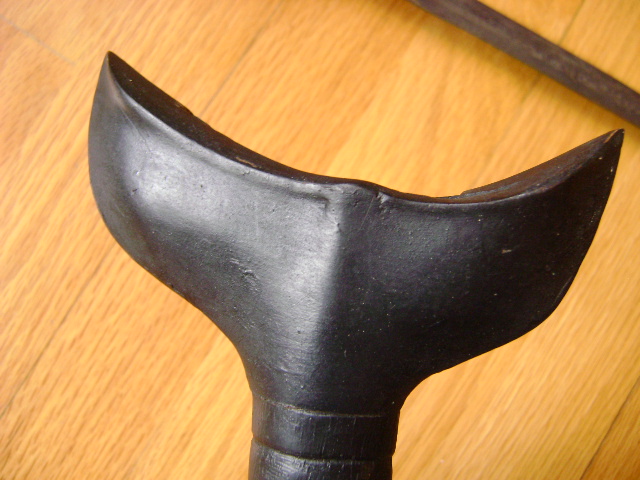

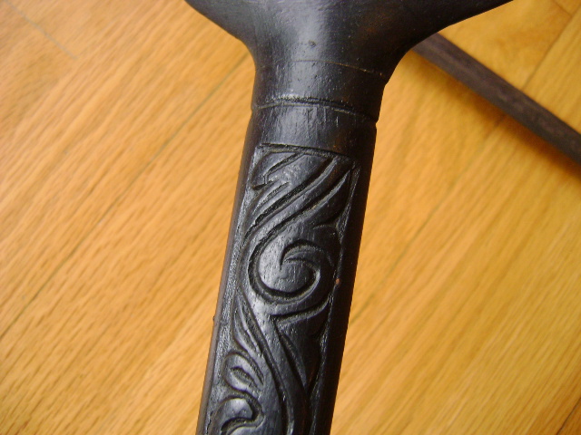

On a whim, I bought a kris I liked. IMHO, this is a Keris Bahari, but I am a complete keris newbie and would like to know more. Allegedly, it came from an old collection, and the same seller offered several more kerises, mainly of Java and Sumatra origins.
The blade is very meaty and quite sharp. It is strongly patinated, but there is no rust and no pitting except some small areas of forging flaws.

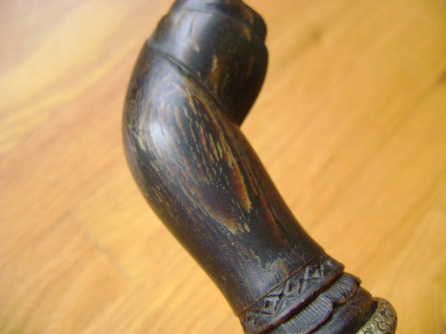

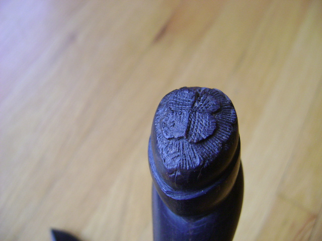

The hilt has sparse, but very precise and tasteful carvings at the base and on the very top ( kind of like a trefoil).
The blade and the cavity of the scabbard smell very strongly of camphor oil .

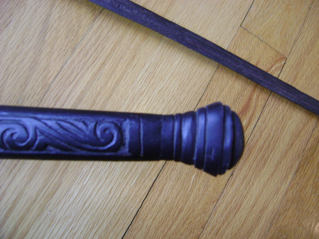

The scabbard is fully intact, with just a tiny crack at its upper part ( almost not noticeable). It is covered with some kind of black varnish? paint?, and there are tiny areas of paint losses under which one can see pale wood. One side of the scabbard is decorated with very simple and completely intact carvings ( this looks to me either incredibly well preserved or newish).

it is not a keris bahari but a keris panjang, both keris have the same blade profile while the keris panjang blade is longer. Some people call this keris execution keris. The keris is from Sumatra.
The blade seems to have old rust, not active so far I can see from your pictures.
The varnish seems to my eyes (dirt-) patination maybe overpainted with some sort of finish. The reason is maybe that the stem (by javanese keris called gandar) is a later addition since the original one was broken, but this is all only a guess since I never have seen such a "gandar" by a keris panjang.
When it will be my keris I would clean the blade in lemon acid or pineapple juice. The scabbard I would let in this state since I am very unsure about the stem/gandar. But the upper part normally have a very very nice wood.
