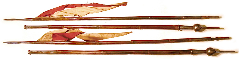

Hi David,
Here is another couple of lances for comparison. Total length 109 inches the central ferrule marked 14 B.L. presumably for the 14th Bengal Lancers.
Norman.

Hi David,
Norman.
Hi Norman ,
thanks for posting these......are they yours ? Interesting that they are 2-piece with a spigot/ferrule .....never seen this type before. Perhaps ceremonial as the 'joint' would generally be a weak point. The 'shoe' is a good example of the Indian Pattern. I do like the fact the pennans are attached.....may have to use a sewing machine and make up a couple for mine, only problem is that I am unsure as to the type of material used....probably the same as that used for flags and standards of the period.
Kind Regards David
