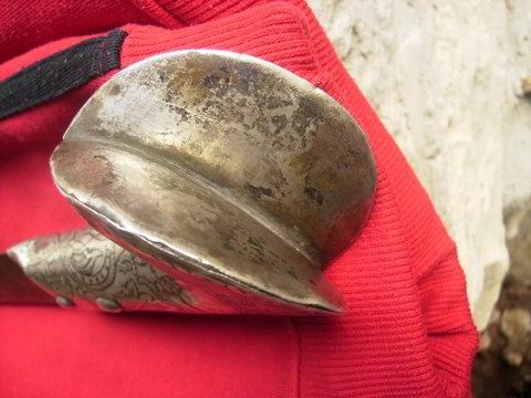

This item was reportedly discovered in an old house in North-Eastern Bulgaria. I have never seen anything quite like it. To me it appears to be a Persian export wootz blade, hilted in the Western Balkans. What is interesting is that the blade appears to have been made this way originally, and it is also short - the length of the entire sword is 80cm, which is about the normal size for a yataghan. I am calling it a yataghan for lack of a better term.
Has anyone seen another example and what is your opinion on the origin of this one?

Interesting sword. would not call it Yataghan though. the blade is Persian indeed. Could be made as a child sword, then later rehilted. the hilt and the way it's mounted resembles shaska. Does hilt split in the end?

I wonder if this, with the animal faces on the hilt, that it may have been fashioned as a hunting sword using a recycled blade? I would personally want a guard to stop my hand slipping forward though.

Thank you gentlemen,
Some great observations. The pommel forks per the attached photo. The way it forks to me is much more reminiscent of yataghans, rather than a shashka though. Also, the niello decoration is found on Greek items, such as #408 from Elgood's book (which also shows that it was used until the early 20th century, the Balkan Wars and WW1). I also found a nicer yataghan with niello decorated hilt and scabbard from a Bulgarian book on weapons, currently kept in Sofia or Varna (the picture captions contradict themselves).
Perhaps the blade was indeed made for a child, but not only is it shorter than usual, but also straight with a slight downward turn, so it was not meant to ever be a sabre by whoever made it. The animals depicted on the hilt are a horse and what I interpret as a lion (it sort of looks like a rat, but lion seems more plausible). I could only find one somewhat similar hilt in the Askeri Museum book about yataghans: the shape is similar and there is a border on the outer line just like the item in question and the other niello decorated yataghan.
We are in agreement about the blade - Persian and made for export. As far as the hilt, I am leaning toward Ioannina or somewhere else in Epirus. But I would love to read as many opinions as possible.

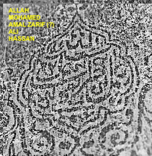

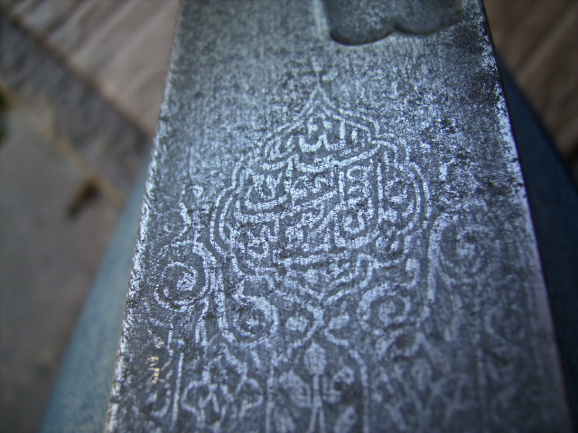

My friend cleaned the blade up and revealed the attached inscription at the ricasso. I feel this warrants resurrecting the thread. Is the inscription legible, and can you please help translate?

Hi Teodor
nice initiative to have cleaned the blade ,
because on ricasso we might read the name of the blacksmith
ALLAH
MOHAMED
AMAL ZARIF
(?) either MADE BY ZARIF (reading under reserve)
ALI HASSAN
several comments
- part of the mentions are religious, used in the sense of talismanic; Allah, Mohamed
and might be Ali, Hassan, the serial seems logic;
God, then his Prophet, the Prophet's son, the Prophet's grandson, those last two very revered by the Shiite
- the owner for this yatagan was Muslim, absolutly, but may be Shiite obedience
- the blacksmith is might be from Armenian community, if what we read as name is correct,
that's it for today
all the best
à +
Dom
