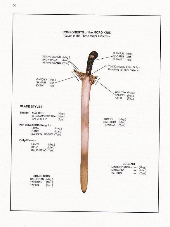

I have a question for those of you who have a higher level of knowledge than do I in respect of the keris of the Moro People.
I am seeking the correct Moro ( and other related ) terminology for the various features of the Moro Keris ( or if you prefer:- kris).
What I mean by this is:-
what word would be used by a Moro to name the blade, or the gonjo, or the sogokan,or the greneng, or the kembang kacang, and so on , in a Moro keris?
I am not looking for the conventional terms employed by collectors in the Western World, but rather the actual terms used by the people for whom this weapon is a part of their cultural inheritance.
I thank you in advance for your assistance.

Alan, scanned is page 60 from Robert Cato's book Moro swords, I hope the links and this scan can give you the direction you need.
Gav

I do have Robert Cato's book, in fact when he was writing it we corresponded, and he let me have some material from European museums that he had used during its writing.
However, I have recently had some doubts cast upon by some of the terms he has used, or perhaps it could just be the spelling of some terms, by a couple of people who, although not keris or weapons orientated , do most definitely know the languages involved.
What I am hoping for is some current local knowledge.
