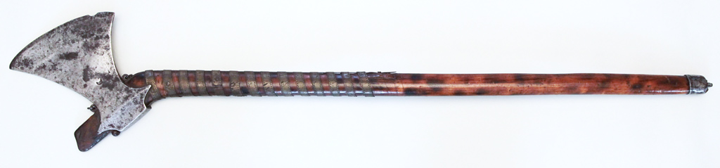

I will post some dimensions later, but for now here are a few photographs.

Wow Lee, that seems to be a 100 % original Norwegian battle axe, probably from the 1630s or there about and with a beautiful flamed birch shaft/handle (what is the correct English word?). A pity that there is a chip missing from the edge. But the handle, I really wish I had an original one as well.

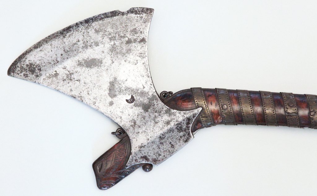

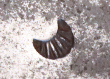

Below are a few more photographs of the axe.

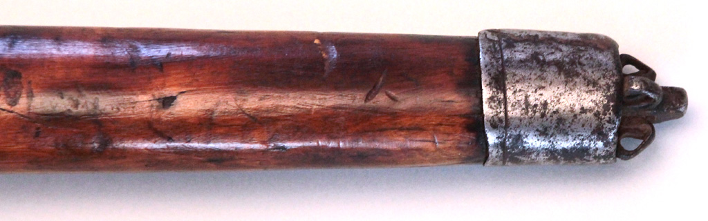

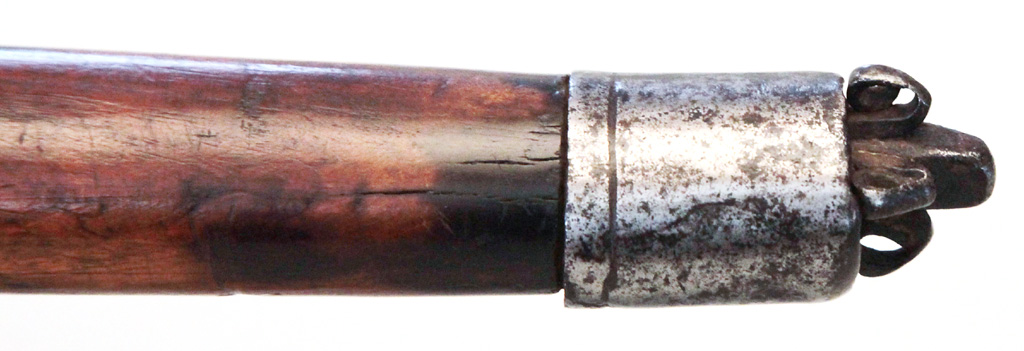

I am sorry to disappoint, but I do not believe the haft is the beautiful flamed birch illustrated in the gun stocks above. The grain of the axe handle is relatively straight and the dark areas appear to be mildly 'ebonized' (darkened by restrained heat). Pictures can so deceive. Below are two closeups near the haft cap.

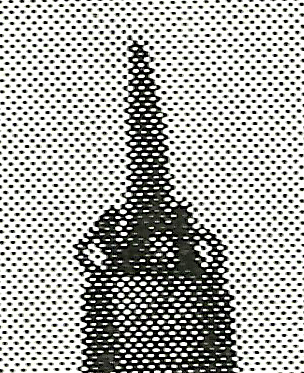

Up close, the spike appears to be a single forging from which the curved elements arise. This has always reminded me of a crown.
Mass = 1,122 grams; maximum length = 1.045 meters
And a few questions for Trond (and or anyone else):
Have you seen similar curving in battle-axe hafts on other examples; is such a curve a typical feature? (I have believed this to be deliberate rather than age warping as the metal axehead also seems to follow the same curve.)
I find the crescent mark to be similar to that on Trond's engraved type 'A' axehead, but not from the same die. Perhaps the same workshop?
Any idea of what the little rings on the haft next to the head were used for?
Lastly, any idea of how expensive these would have been for the typical farmer of the time in terms of days of work required to earn the money to buy one?
Lee is online now   Reply With Quote

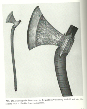

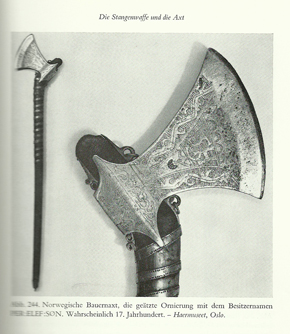

Hi,
i found these two illustrations in "Heribert Seitz, Blakwaffen, Part 2"
First one is dated with 1610 and has the same butt.
Very fine and rare pieces.
Dirk
As mentioned before, my knowledge on DkN muskets and rifles is not too bad, but I have only collected edged weapons the last ten years and axes only the last few.
None of my axes have the original haft and I can't remember if other axes I have seen have this curve.
As far as I know, one does not know where these axes were produced or even if they for certain were made in Norway. They probably were as they are not known from other places.
Sorry I could not be of more help.
Trond
Trond is offline   Reply With Quote

Junker, thank you so much for sharing the examples from Seitz. I have not previously seen the second volume and so this is new to me. The German name shown in the caption, bauernaxt, is interesting as it does relate the form to the peasantry. Considering another thread of the moment, I suppose these axes, as prized possessions, are as special to 17th century Norway as the long rifles are to 18-19th century America.
