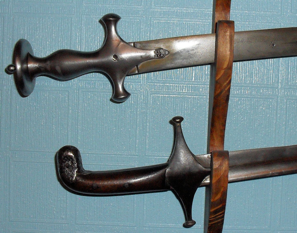

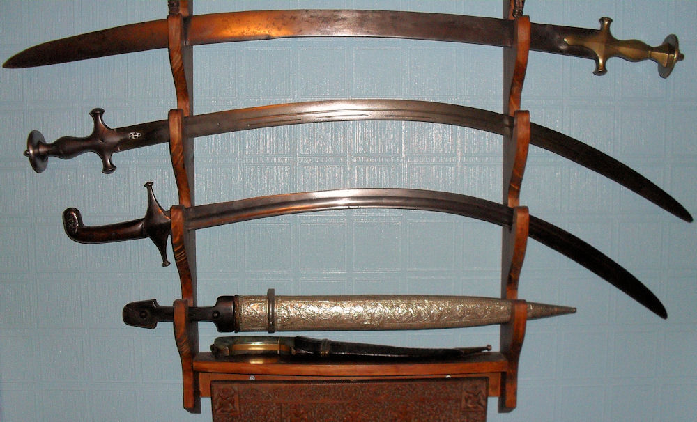

Further to this being a trade blade and the question of matching it to suitable hilts, I found myself thinking that the fullers end long before the hilt and the blade is rather long.
Would this also suggest that this blade was made with a variety of modifications to fit various hilt styles being catered for?
See pictures below. Fairly standard Shamshir below and good sized Tulwar above.
