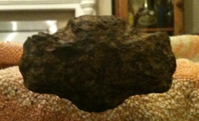

herewith a sword with questions,Finding place is Norffolk in the UK.
parts of the scab. wood and leather, hairy side inside (both hard as stone) remain at the tang and blade.
can any body place/date this sword or know a similar?
the type of pommel is also not known to me
what kind of cross has been used on this type ?
ttl length 90cm ,blade 77, tang 10cm, pommel 60mmx37mm , blade width 53mm.
thanks+regards

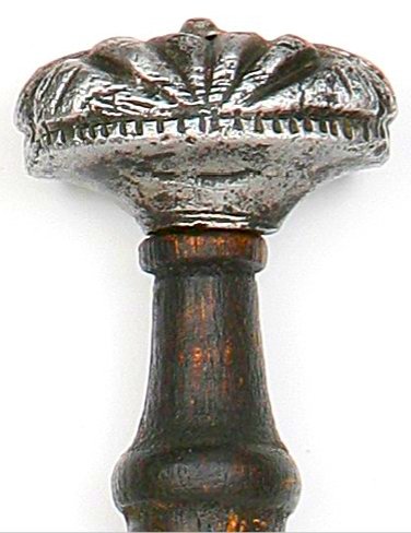

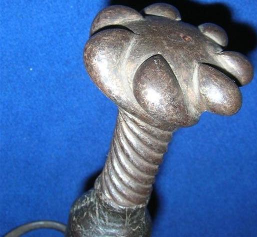

It's the fragment of a South German ca. 1535 Landsknecht backsword. Look at the pommel. The quillons are missing as well as the wooden cord bound and leather or velvet covered grip.
I attach images of a similar pommel of a contemporary Landsknecht dagger sold at Bonhams in spring, and of a sword sold at Christie's.
For lots of more illustrations, please see my former thread on Katzbalgers and related Landsknecht swords:
http://www.vikingsword.com/vb/showth...ght=katzbalger
Michael

this sword is very difficult to place, when you look on top of the pommel in the plan of the blade you see a cross patee. I received reactions from a roman sword till a 16thC sword.still I really can not place it.
I think that it is not a katzbalger because the shoulder of the blade fitted into the cross guard, you can see the trace at the blade, most (all) of the katzbalgers have the shoulder resting on the cross block and more important a ricasso!
f/m I think there is some pattern welding however because there is organic material hard as stone on the blade,it is not very obvious.
looking forward to some more reactions.
