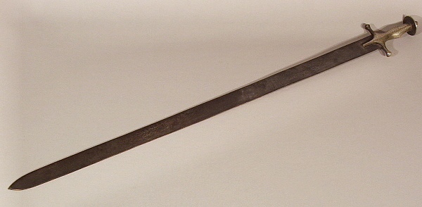

No help here Jim but I can add this image for further discussion about the diverse styles of weapons used that carried this script.
Gav
Old 18th July 2010, 01:55 AM   #3
Posts: 10,871
Thanks so much Gav! Thats what I was looking for, good examples, and this really presents a quandry with this....what in the world is a Sudanese weapon doing with an obviously Indian hilt????
Last April we discussed another of these anomalies with a brass tulwar hilt and a Sudanese type blade described as a 'kirach', posted by Valjhun.
(attached below)
I have seen these curious tulwar type kaskaras a number of times, but not in any significant number. There was of course distinct connections in trade between India and the Sudan, and Indian forces were with the British at Suakin in 1885, but it would not seem any of them would have had Mahdist blades on thier weapons. There have been firangi blades mounted on a few kaskaras.....but it would seem more likely that these Indian hilted examples would have been the product of innovative armourers in Sudan using Indian hilts.

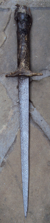

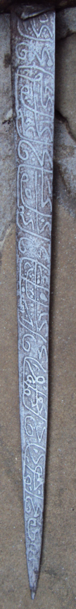

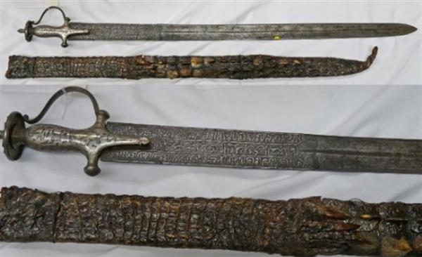

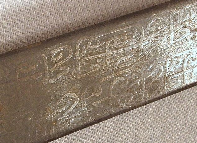

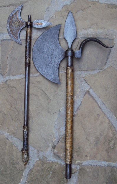

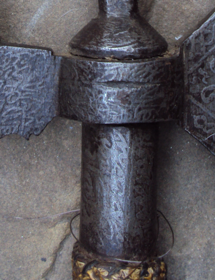

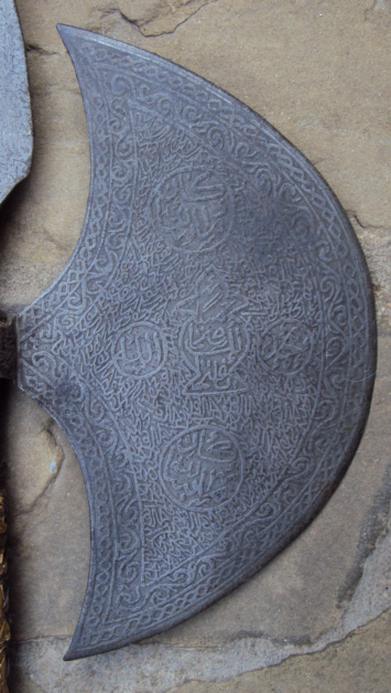

To keep a more narrow focus lets just stick to etched thuluth where ever from. I have seen some on Indonesia weapons.
These are the three examples I have. I am not an expert but I thick it is possible to see three diferent styles, certainly two. Are they indicative of differnt regions? Clearly different manufatures. Crocodle skin in not a pointer as the Niger has crocs.

Since I'm just learning about this, does the thuluth name cover the shape of the characters or the method of etching? Or both? To me, it looks like the figure and ground are effectively reversed from "normal" weapon etching. "Normally," characters are incised in blades, and if etched, the etcher coats the weapon with wax (or similar) and scratches the characters in the wax. Here it looks reversed, in that the figures appear to be written in crayon (okay, written with wax) and the blade is etched around them.

Well made point on the crocodile skin too. There certainly were crocodiles in the Niger and the use of crocodile hide was used in certain cases in West Africa in some of the secret societies. The use of the crocodile hide on weapons to me seems situated mostly in Sudan, but in singular cases it would be possible to the west I suppose. Most of what Ive seen is armor type regalia, along with pangolin hide, rather than on weapons.
