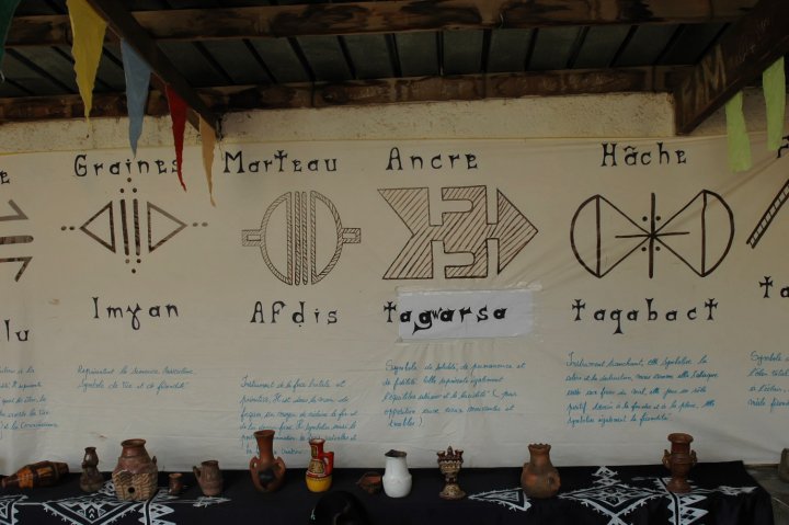

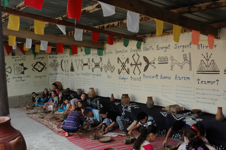

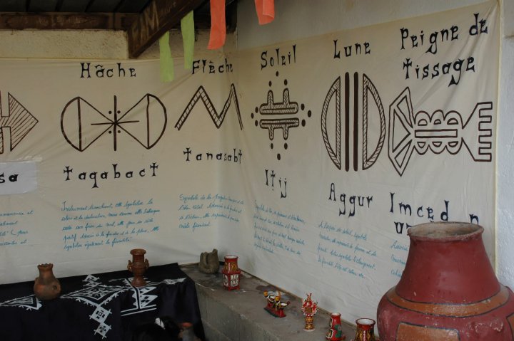

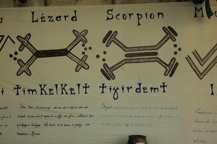

Hi Jim,
While gathering material on Kabylia and the Iflissen, I found these pictures of motifs used on traditional Kabyle pottery. Notice that one symbol, the double drum means "axe", while the double zigzaging lines could mean "arrow" or "mosquito". I will keep looking at the various symbols we sometimes see on flyssas.
Will you be at this year's Timonium?
All the best!
Emanuel
