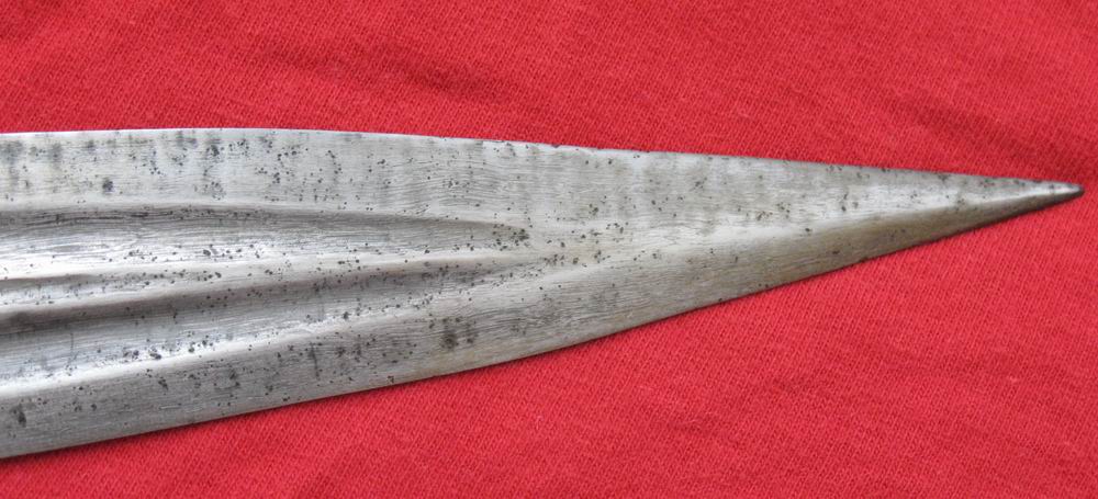

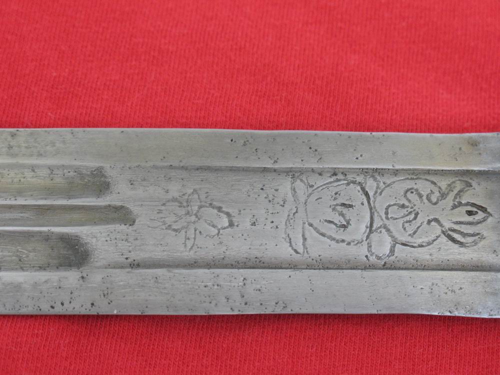

I am not a metallurgist - actually quite the opposite, but I vote - sham wootz. This is probably mostly due to wishful thinking on my part, as I have a kindjal with a similar pattern visible throughout the blade - pictures attached.
Teodor

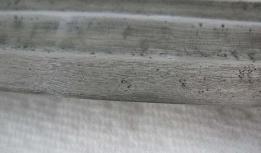

Could be shear steel, the 'other' pre-Bessemer way to make steel from iron.
Here is a pic of a lightly etched wood chisel made of shear steel, the laminations can be coase or fine depending on the amount of processing. It can look almost exactly like sham wootz
