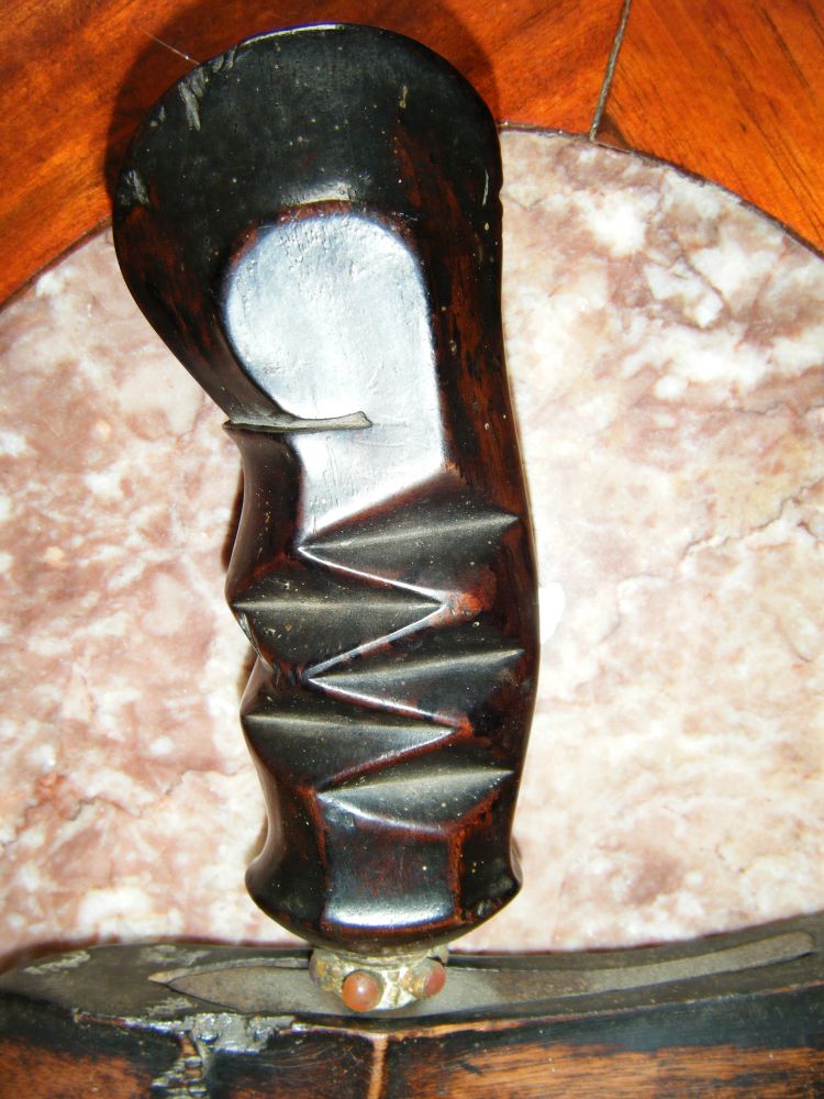

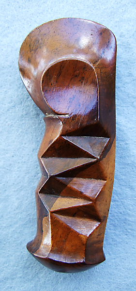

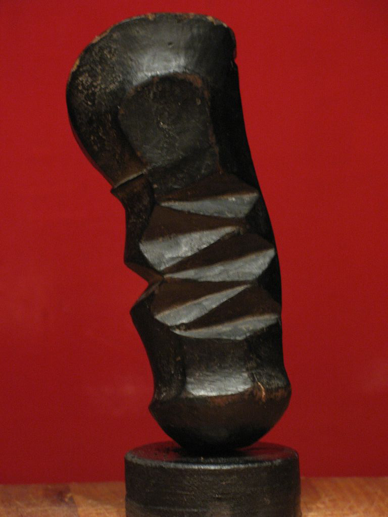

Atlhough my interest in krisses is broad I never included Bali in my collection. Now I have by accident a Bali cecekahan hilt that came from a friend.To my surprise I do like it a lot.
I would like to learn more about the symbolism of this hilt. Who has more info on this? Reading throug the books I have I found very little.
Type of the hilt used by lower classes - maybe specifically by warriors - is about all. Nothing about the decorations - notches on the back etc.
And those of you who have nice variatons on this cecekahan hilt please do share here!
Regards, Erik

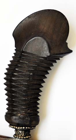

Hi Erik,

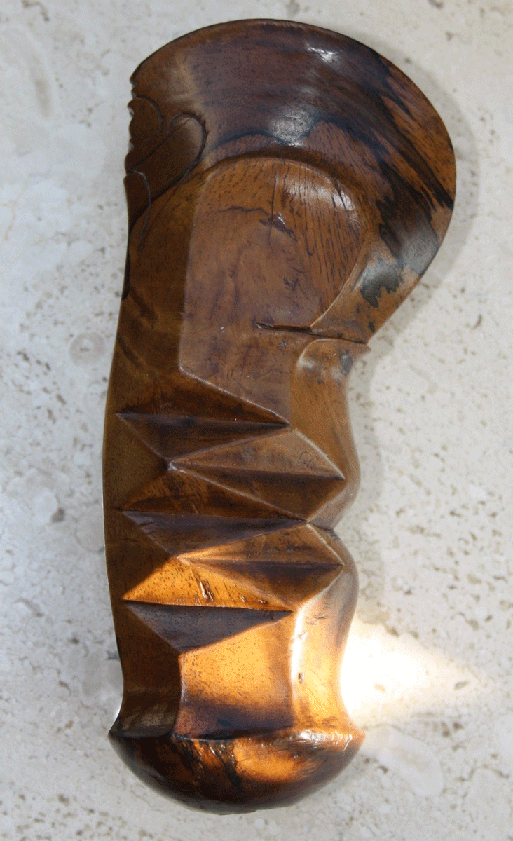

in my collection I have only the style you have. The handles with more notches seems to be very rare, I've seen only a few and I look already long time for a one with more notches. Here two examples from my collection.
sajen

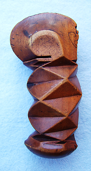

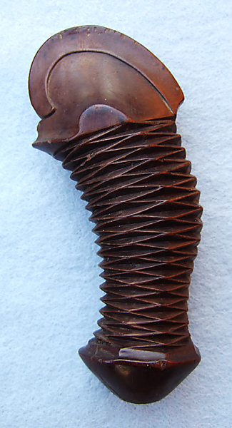

Hi Erik,
There was almost a "frenzy" on that hilt.
Nice one.
Here 2 examples I have at this moment.

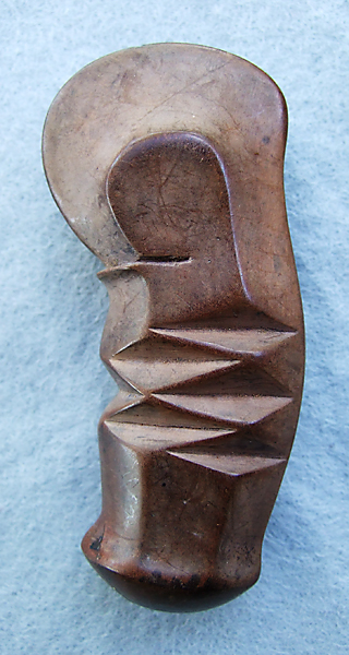

Old 27th July 2009, 11:13 PM   #4
Posts: 7,258

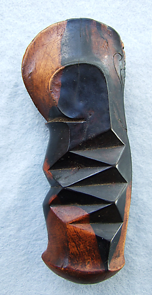

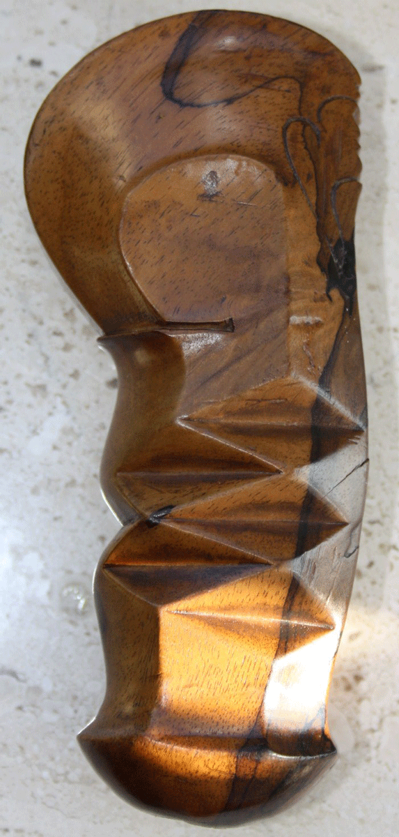

Plus one, and something a little different.

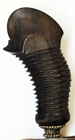

Old 28th July 2009, 04:20 AM   #5
Posts: 7,258
Here's another couple I could put my hands on. I've got a few more around somewhere, but they're on kerises I think, and too difficult to find.
Actually the name of this hilt form is "cekah solas" :- cekah = a thick slice; solas = eleven (Balinese).
The strict form of the hilt has eleven cuts, five on each side, and one in its front. Also called cekah redut --- don't know what "redut" means.
In the old days they were considered to be a hilt for soldier, or a pendekar.

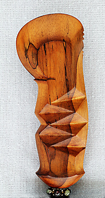

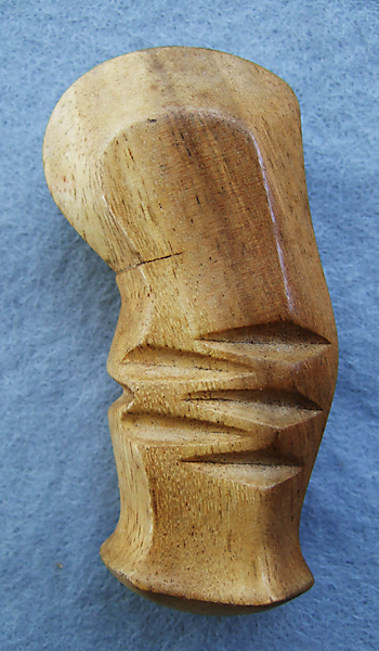

Dear Erik,
IMHO one of the complete book on Bali and Lombok Kerises is Ir Lalu Djelenga's book, "Keris di Lombok" (1994, 2000). It is interesting to read on this special "danda" or "danganan" (keris hilt), usually used by (Balinese and Lombokese) soldiers, selected soldiers with very special ability named "Pemating". A commando type of soldiers, which usually they are 'invulnerable' to weapons.
The normal "cekahan" hilt, usually has "eleven notches" ("solas takikan" in Lombokese dialect). That is why, this type of hilt usually named as "Cekah Solas" danganan, or Cekah Solas hilt, or just say it in universal words as "eleven notches hilt"... ("solas" in javanese language is "sewelas", or eleven in English)
The form of this hilt almost similar with "Bondolan" type (please see the comparison from my collection below), an ordinary type of Balinese of Lombokese hilt. The difference only lies on the "takikan" (notches) in the grip-side.
The normal notches are eleven -- please count: five on each plain side, and one notch on the front side (please see the picture). If more than eleven notches, then it will be called as "Cekah Redut". Unordinary cekahan...
This type of hilt (also bondolan type) -- according to Mr Djelenga -- now maybe use for any type of Balinese or Lombokese warangka, whether it is a gayaman, ladrang or even "jamprahan" (special warangka for pedanda or Hindhu priest)...
GANJAWULUNG

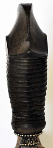

Old 28th July 2009, 09:22 PM   #7
ganjawulung
ganjawulung's Avatar
Join Date: May 2007
Location: J a k a r t a
Posts: 991
Default CEKAH Redut?
Similar to Alan's "more than eleven notches" hilt -- I count at least 98 "takikan" (notches) in one hilt. Is it cekah redut?
GANJAWULUNG

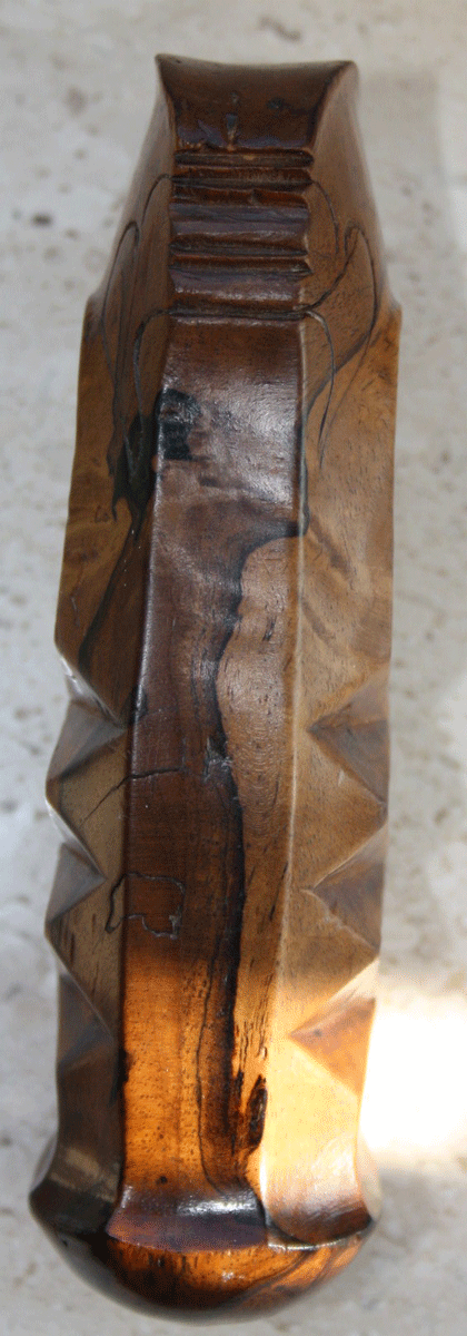

Old 28th July 2009, 11:51 PM   #8
Posts: 7,303
I have 2 of these hilts and i have noticed that on mine as well as Erik's and a few others there is also 5 lines notched into the back of the "head" of the hilt. Does anyone here have a clue as to the symbolism of these notches?

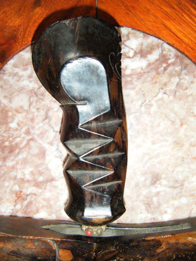

Here's another one.
This used to belong to me, but it has moved house. The new owner has kindly permitted its publication here.
Old 29th July 2009, 01:46 PM   #10
erikscollectables
erikscollectables's Avatar
Join Date: Nov 2008
Posts: 318
Exactly one of my questions too.
Will start travelling now so only join the forum again after the holidays but hope to learn more then...
Regards, Erik
