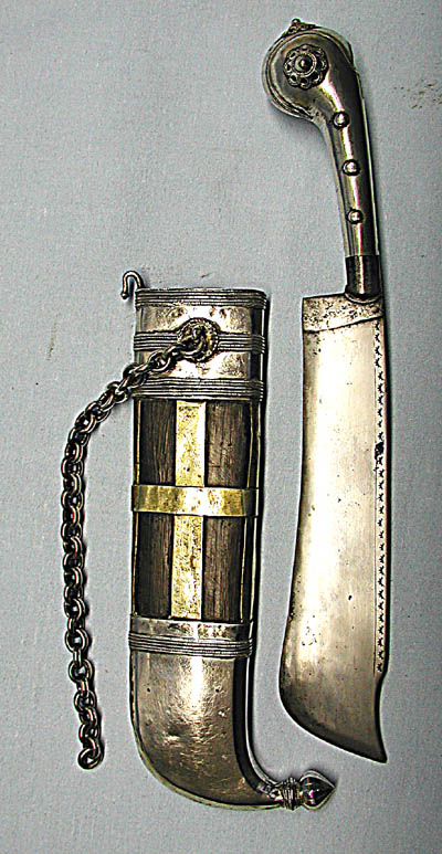

It’s an interesting question you ask, and the answer is yes. There are other weapons than the ones you mention. Straight or tulwar blades swords, often with hunting scenes chiselled on the blades, kukris were also used in India, although they were not so common as many other weapon types and the pichangatti from Coorg – attached. There are, no doubt, others especially if you look for the tribal weapons, but it would be interesting to see what other can come up with.

The pichangatti shown by Jens was as noted, a utility knife, often with added and attached items for tonsorial use etc. however, as with most implements.....could certainly serve as a weapon as required....much as we have certainly heard of kitchen knives used. Most knives in tribal areas serve as eating utensils on occasion, dressing of game, while in most cases those of station often used various forms of knives en trousse.
