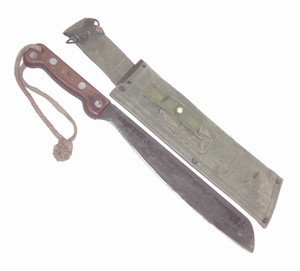

Another example, of the opposite way, can be seen in the former (1960's-1980's) British issue Golok machete for tropical area.

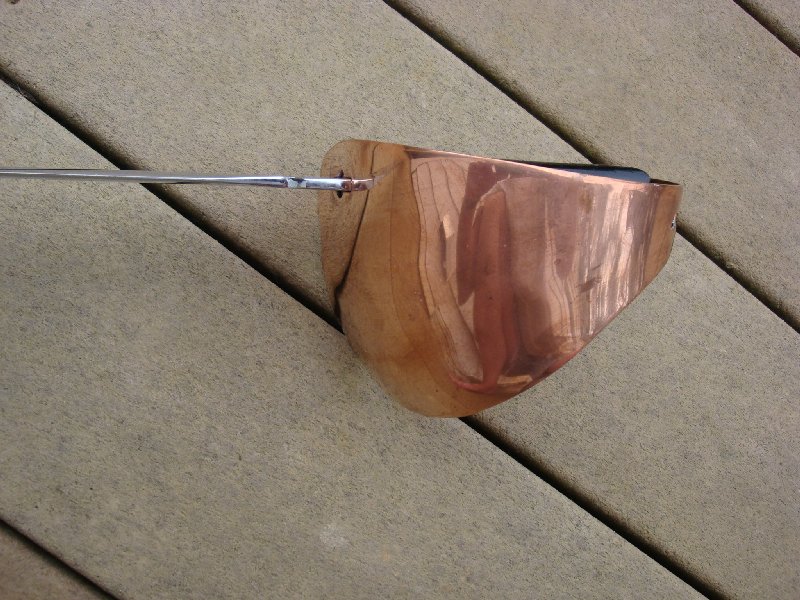

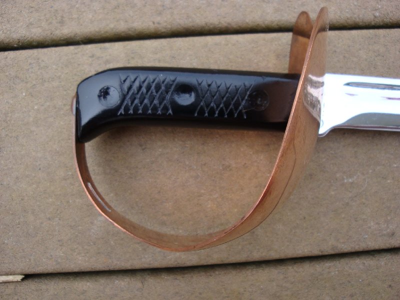

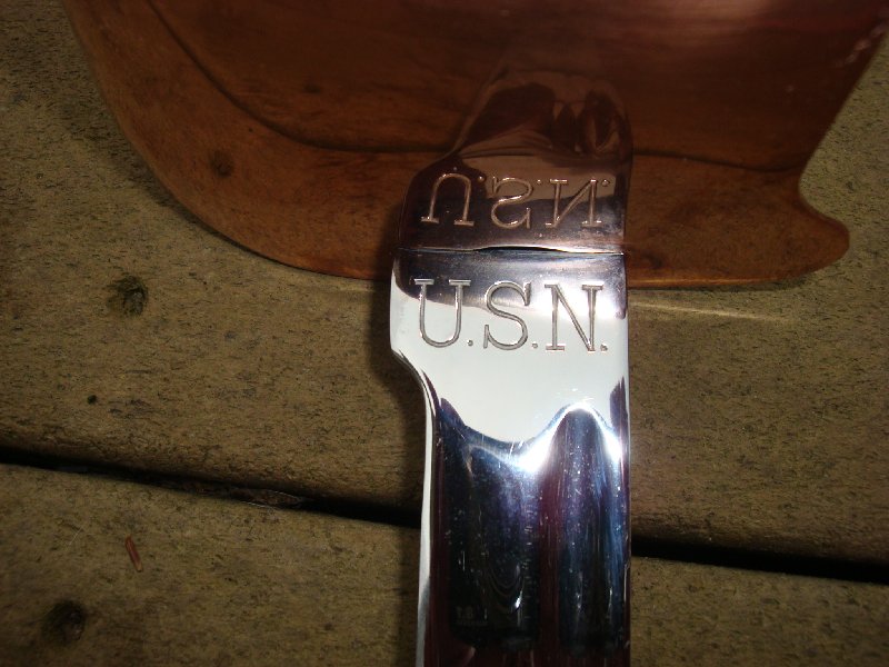

The American 1917 has the blade similar to these but the 1917 had a solid basket. What Lynn Thompson of Cold Steel lists his as a 1917, is actually the Milsco version made later in the century. I was suprised by one recently that had a copper basket and shiny blade. According to another respondant, those plated American 1917 versions were truly done up that way for parade and such.
Cheers

The copper and nickle plated job that surfaced and a ringer of a Neumann 18th century piece that I couldn't pass up and have adopted.
Cheers
Hotspur; the repro at the bottom already comes with rust and a dark blade
