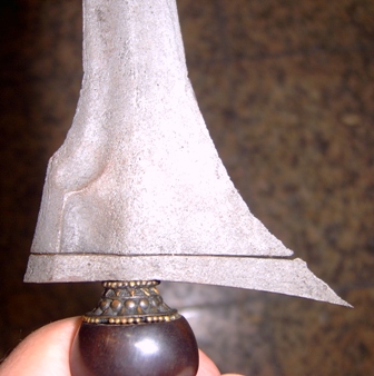

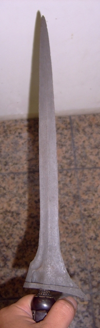

recently got this pamorless keris.
I always wondering about kelengan keris, and finally I got one.
I've been trying to find out whether it has a hiddden pamor. the result comes to zero, but I found small area in the middle of the blade surface showing tiny little materials ( like a very smooth sands). what is it? .
the new warangan work seem just fine.

The 'smooth sand' is prob what is known as 'pamor miang' in peninsular keris context. It's not really a pamor, but some sort of crystallization. Experience is that metals exhibiting "pamor miang" are not very strong/hard, and is usually the non-cutting edge metal. Sometimes we see this in Sumatran kerises without pamor as well. Not sure how it is formed though.
Thank You BluErf,
the 'smooth sand' do not bother me any way.
I'm quite pleased with the warangan work.
the black colour seem strong and deep. specially after I put some keris oil on it. I took tho pisture immediately after the oiling, and it result nicely.

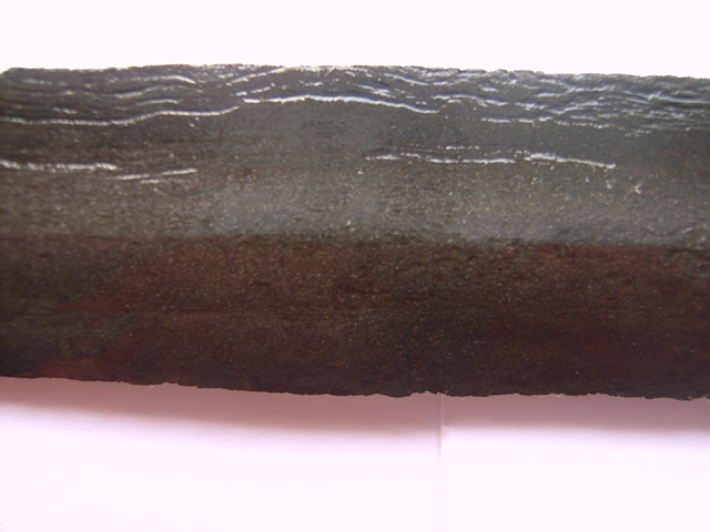

here are some pictures before the warangan process. I hope you all enjoying the picture as I do.
the third picture shows some lines as a result of the forging process.
really love those lines. I've been looking for keris with lines.

the 'sand' like appearance you see is just the crystal structure of the steel/iron revealed by the etch. Probably a forest of pearlite crystals. Nice blade.
