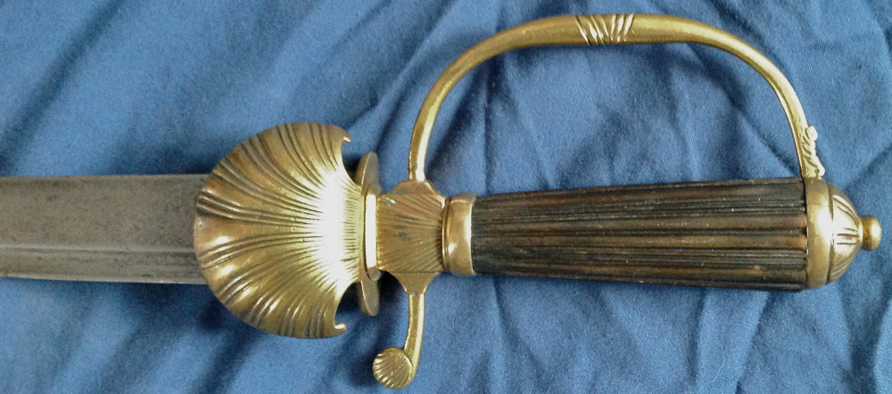

Hi,
Continental European, rather than English I would suspect, mid 18thC hunting sword. O.A. length 28 inches blade 22 3/4 inches, 1 1/4 at widest and shy of 1/4 inch at its thickest, the hilt is of horn. There is no blade decoration but there is a makers? mark on both sides of the blade, see photos. I have come across one other sword on the net similar looking, but with pictorial relief on the guard, with the same makers? mark. Would obviously like to hear from anybody who has any idea on the maker and of course all comments welcome.
Norman.
Old 4th June 2014, 06:13 PM   #2
Hi Norman,
From the altar of my ignorance ...
If it is not German, surely has such influence, with that typical shell guard appendix.
I can not avoid thinking that many hunting swords are mounted with (shortened) sword blades.
Have you examined how the fuller end meets with the point, to exclude such probability ?
Nice piece, by the way .
Old 4th June 2014, 06:47 PM   #3
Norman McCormick
Norman McCormick's Avatar
Posts: 1,657
Hi Fernando,
German would seem to me to be a good call. The fuller ends properly on both sides 5 1/2 inches from the blade tip thereby to my mind excluding the possibility of a cut down blade. Here is another with the same makers mark and blade profile making the probability of both coming from the same workshop more than a possibility.
My Regards,
Norman.
Old 4th June 2014, 07:13 PM   #4
I see !
Pity i can't ID the mark; maybe some member will.

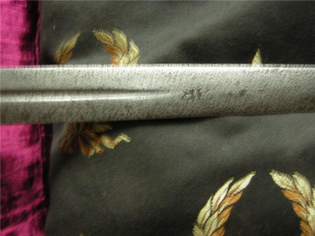

Here's a better image of the 'makers' mark on my sword.
Norman.

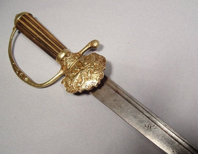

Hi,

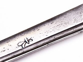

A friend found this similar mark on a basket hilted backsword.
Norman.
Photos, Culloden House Antiques.
Old 5th June 2014, 08:35 PM   #7
A fleur de liz ... right ?
Old 5th June 2014, 08:50 PM   #8
Norman McCormick
Posts: 1,657
Looks pretty much like it, now all we need is some well informed Forumite to come with an I.D.

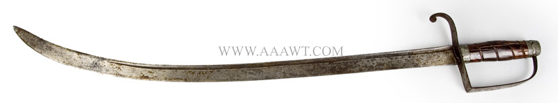

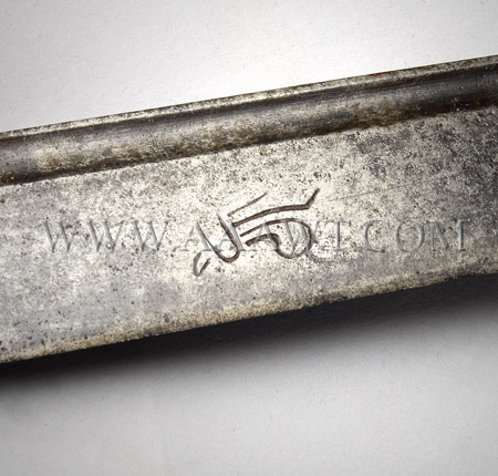

Found another possible example of this mark.
Norman.
Photos, AAAWT

I know less than nothing about these European weapons ... however, I did find this at http://www.cullodenantiques.com/page...d-weapons.html to whit there appears an equal Fleur de Lys below from that weapon not an English Dragoons Basket Hilted Backsword but a Scottish Troop Horse Grenadiers Sword Sorry Norman !!
OOPS...!! This I note has already generally been pointed to earlier at #6.. but I make the correction.
I note also at #9 some arabic to the blade which is a variation on the "God is Great" theme but stacked half sideways...

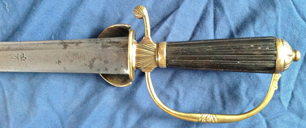

Thank you for the additional pics of the interesting Culloden House item which Norman posted in #6 and noted as a basket hilted sword. As it was not specifically identified it is interesting to know that it was a horse grenadier sword. I have always considered Robert Docherty's descriptions and detail most reliable, and this is a great example.
The Scottish regiments in the British army were receiving swords made in Birmingham and London for a good number of years before Culloden (1746). One of the first recordings of an actual supplier was 1759, when Nathaniel Jeffries was noted having delivered 3500 broadswords that year ( "Swords for the Highland Regiments 1757-1784" Anthony Darling, 1988 , p.13).
He and Dru Drury were both actually goldsmiths, who according to Darling (p.53) probably subcontracted for finished guards, pommels and blades from Birmingham and assembled them at their workshops in London, contributing their own grips and coverings.
They both stamped the blades with crown over their names in roughly similar location to these fleur de lis stamps and with similar 'artwork'.

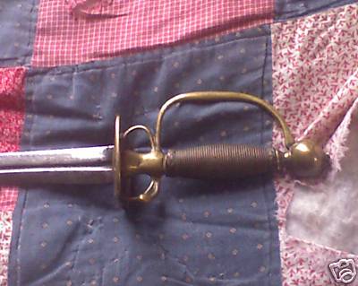

Another sword French C1740, the sword belongs to a member over on S.F.I. and I do hope he doesn't mind me using his photos.
Norman.

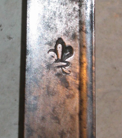

This is a fascinating thread and the factors behind the "Trio in Juncta" or "Fleur de Lys" are very interesting and Forum are lucky to have the entire Bookmobile of Jim McDougall in direct support on route 66...

Norman and Ibrahiim, thank you for the kind words !!
I am warned by my wife that any more books in this thing will require much heavier springs!!
My hope is that others will be joining in here quid pro quo....I add whatever I can find in order to share as much as I can and there are so many other references out there I don't have here. That's why I implore others who have them to check them and add their notes.
On the Scot/French situation. While that was of course a well established alliance and the French language was well spoken in Scotland, the deal with these fleur de lis markings on these basket hilt swords I think not really applicable. These were English blades on British dragoon swords which were typically from Birmingham, and there mostly from Germany (though these FDL blades are still undetermined) .
I am beginning to wonder if these fleur de lis blades might have been from St. Etienne? There seem to be a good number found in French mounts, more than I had thought.

I'm wondering just how far back the fleur-de-lis really goes on English blades?! I've personally seen at least two of the so-called 'doghead' Englsh naval swords (brass cast monster/dog gripped) from the 1680-1710 period with the above stamp! Early Brit naval hanger baldes from this period often had German blades (the King/crown Wundes family marking comes to mind), so still wondeering if these baldes are German-made imports?
