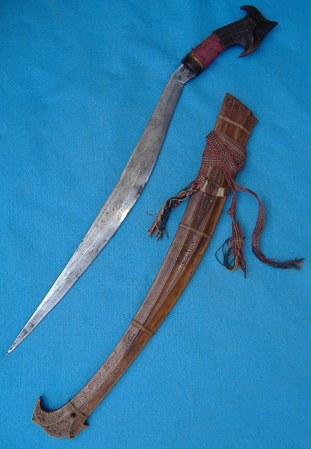

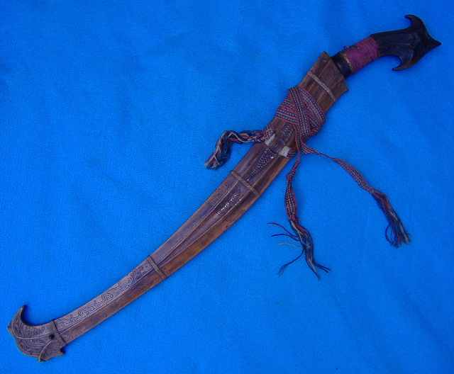

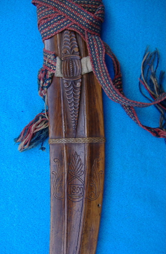

As a collector of Moro swords I typically stay away from the swords of non-Muslim people of the Philippines, but this talibon struck me as exceptional. Dated 1899, the carving is outstanding throughout, and the blade is very thick and heavy. This one really gave me a new found respect for such pieces.

wow! what is striking is that it actually has the date engraved!!! nice acquisition, charles...

Congrats on a great find. The Visayan Islands started to be under US control in 1899. Cebu was fighting the Spanish control in 1898. I've lean towards thinking this type of sword would be from Cebu. Maybe an early presentation sword to US officer? It sure seems to be in excellent condition. By 1900 there was conflict with Americans. If you find any more info on it, please post.

Nice puppy Chuckmeister (woof! ). It is possible that this is a capture piece. Cebu and Bohol were fighting until 1901, especially when some Cebuanos moved to Bohol and finally surrendered. I have a similar talibon with the surrender date in ink on mine. Rare to have the cloth on it.

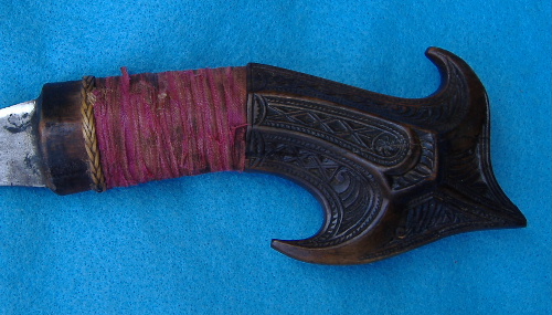

...notice the red wrapped hilt?
Pulahan?!?!?
Cebu?....
try Samar

Don't know about Charles S; many collectors have (until recently, it seems) avoided nonMolslem PI swords because of fashion and (incorrect) attitudes regarding quality.
This (though we lack a definition) is the type now being called a "garab"; it's the type with the thumbest, and yours in the particular variation (triple concave sheath front, finialed pommel, etc.) one sees in pretty much all the published sources. This always carried a perhaps inappropriate prestige, but it certainly seems like a nice sword (they usually do).
Most interesting feature may be that this is a left handed sword (unless your photos are reversed or something).

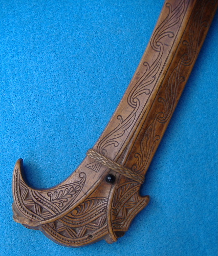

note the pinned sheath tip.

I have noticed that the better talibons ( to the fashions) have a pinned tip with mother of pearl. Mine does as well.
