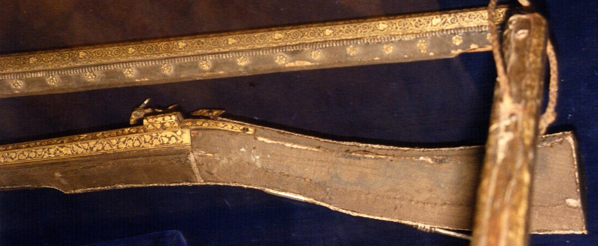

- two arquebuses with textile-covered stock (the velvet now mostly rubbed, with only the remaining), ca. 1540, Vienna Waffensammlung (1)

One more close-up of the Vienna arquebuses; their stocks were originally covered with velvet of which only the backing layer has survived, due to bad rubbing.
