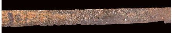

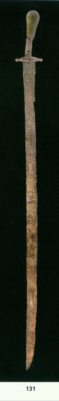

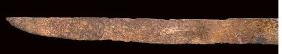

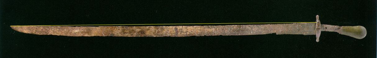

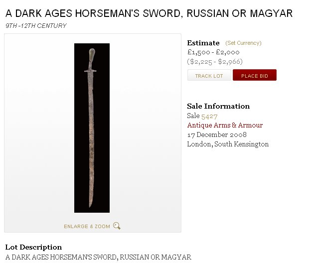

Sold at Christie's, Dec 17, 2008. It failed to sell.
Michael

The Russuan! or Magyar attributions is based on?

Definitely East European influence, anyway, TVV.

Agree, but I was just curious, as it could have belonged to a variety of other ethnic groups from the Early Middle Ages. I could not see any reference to the location where this sword was found and wondered if it was known and if there were any reasons for the Magyar or Russian attribution.

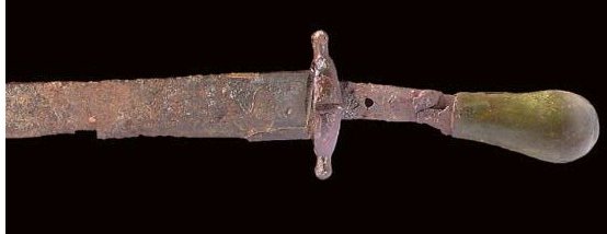

Kronck, to me the blades appear different. The blade on your nice replica seems to be a little more curved and shorter, and the blade on the auction sword to me seems longer and pretty much straight. If so, it could be earlier than what it is dated, and I have seen such blades attributed to the Avars and Bulgars, prior to the Magyar arrival. I guess the Khazars used them as well.
Also, I see the little brass habachi-like element at the ricasso, the function of which I remember was subject to some debate.
Or it is possible that I am not seeing it correctly - it happens to everyone.

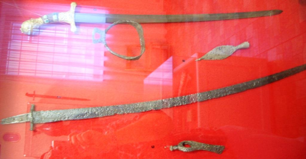

Such sabers have been found in excavations in Hungary by certain amounts and can be seen in museums, like the pair in the following photo (taken at the Hussar museum, Eger). However, the habaki-like part shows a connection, if by influence only, to Chinese sabers and should be researched.

Here are some examples of Avar swords, and from the photography I guess these were taken from former Hermann Historica auctions:

These swords are massive in hand. I know Oliver Pinchot is about to publish something on this but no details yet.
The pommel on the sword in the top pic is replaced, maybe that is why it didn't sell.
I think the research shows the collar at the forte on these originated in Middle Asia and then traveled east.

mine has a 29.5 in. blade as opposed to the others 30 1/8", well spotted, that extra 5/8 in. makes all the difference . oddly enough, mine varies from straight also by 5/8 in. in the centre of the blade. it's definitely magyar tho. (the smith is a magyar ) just made a bit later than the one in post #1. no sweated on edge thingy tho.
looks a bit longer in this photo:
it's all in the angles.
p.s. - the thumb ring for me at least is more comfortable with the finger behind the sword guard rather than in front. shown here on a 15c magyar sabre repro, it's even more uncomfortable on the 9c one with it's thicker bronze guard.

drawing a line across the top of the christie photo shows their 'slight curve' to be a bit less than mine, near enough straight.
i had a look at christies site for sale 5427 in london on 17DEC08 and did not see it in there, wonder what the lot no. was. there were a large no. of arms and armour in that sale no. some nice pieces.
Linky to christie's site for past sale 5427
Last edited by kronckew; 21st February 2009 at 03:13 PM. Reason: better picture posted later

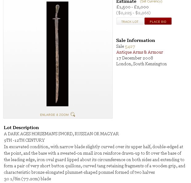

As I wrote in the first line of my post the saber failed to sell so it does not show up in the revised version of the online catalog which comprises only sold pieces.
The lot no. was 131 and it is of course still there in my copy of the printed calalog.
Michael

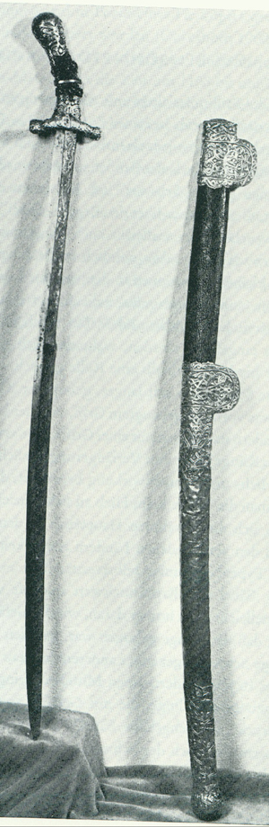

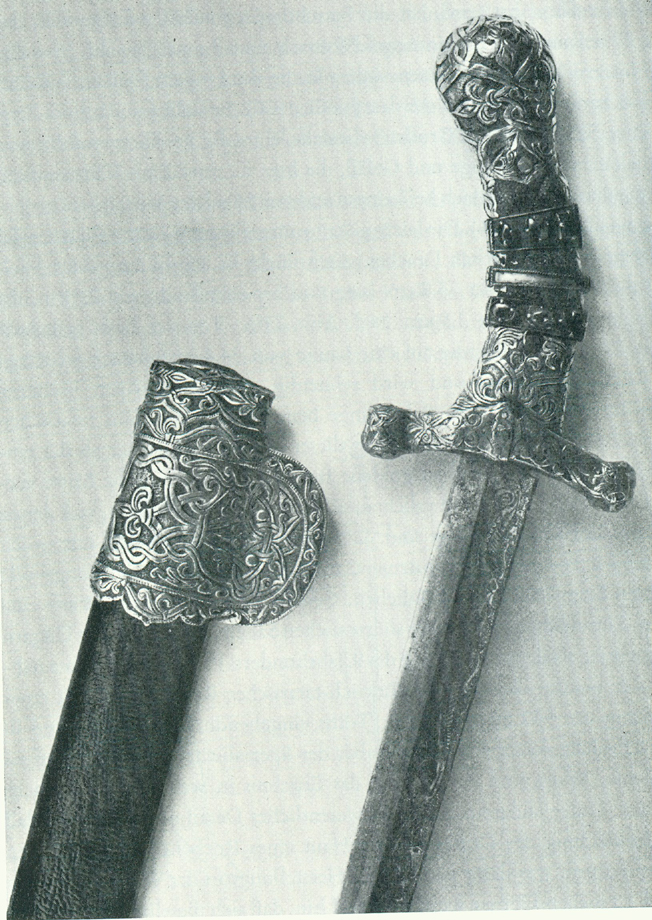

Another 9th century East European saber retaining its scabbard, preserved in the Profane Treasury Vienna. Although this had been attributed to such historic persons like Charlemagne or Attila by the romanticism of the 19th century these trials have been renounced of ever since.
Michael

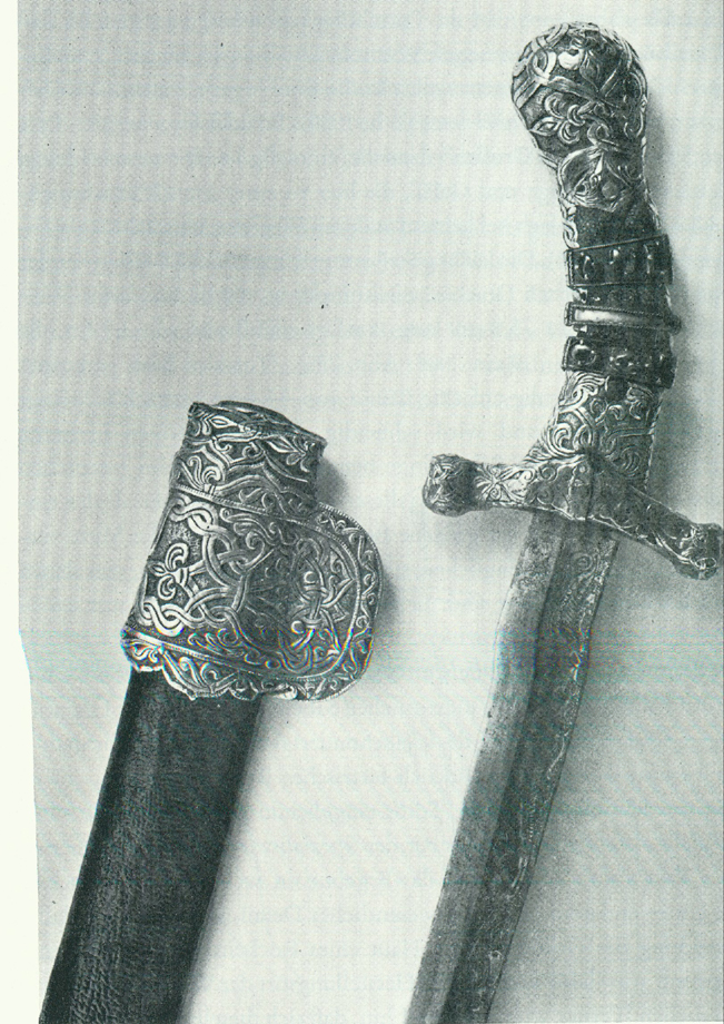

Once more, now without the distortion of the blade.

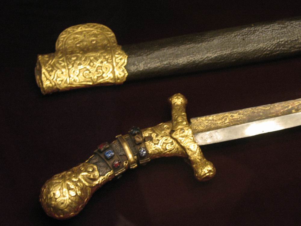

Thank you Michael, this is a lovely sword, exceptionally well preserved and I doubt there is any doubt that it is Magyar indeed. I was able to see it in the Hofburg trasury early this year and tried to take pictures, but since using flash is forbidden, they did not come out too well.

Thanks for this color pic, Teodor. It is quite good despite the low light in the Vienna museum.
