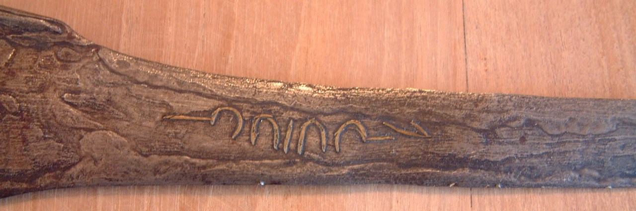

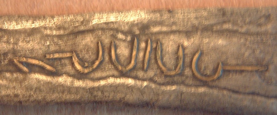

Is there anybody on the forum who can tell me what this inscription is?
It is on a very old javanese blade, inscription is probably newer than the blade (might be 14th century blade) but it is old too, 19th century or earlier.
At first I thought arabic but I have confirmed it is not that.
In the meantime I heard two other options. Old javanese or a "magic" text by a local magician (Duku?)
Who knows more?
Regards, Erik

Kiai Carita
Posts: 91
Default Not Jawa and not Arabic
It is not Jawa script, and neither is it Arabic. Might not be a scrip at all.

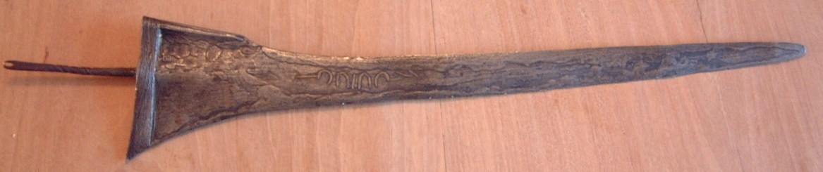

Erik, you say it is on a very old Javanese blade.
Could we see the blade please?
Erik and Alan,
I am afraid it is not on a very old blade. To make sure, perhaps Erik could upload the whole picture.
OeS
Raden Usman Djogja is offline   Reply With Quote

Default Blade
The blade. Wanted to save this for another discussion but here it is.
Some "specialists" here in the Netherlands had a look at this blade.
They all thought it was a very old blade maybefrom around the 14th century.
The style of the peksi was linked to Empu Supo (am not sure if this is the correct spelling of the name) and the blade they thought was from around the same period.
I myself have no opinion on this as my knowledge does not go this far, I am just repeating what I heard so far. What I do know that it was not made after 1950 (came here before that) and the metal is different from what I normally see on krisses. Thinner and somehow stronger and more flexible.
I like it a lot and think it is quite beautiful despite the fact that it should be washed.

I believe the name you are looking for is Mpu Sombro. The hole at the end of the twisted pesi was used to hang the keris from a string.
This is an interesting keris. Sorry that i can't help you with the inscription, though i do agree that it was probably added at a later date.

Yes, an old blade, but the lettering I believe to be almost certainly a much later addition.
Very often we find that script applied to blades, and also other objects, is very far from perfectly executed, and is the result of an unlettered craftsman attempting to copy something from a local interpretation of an original script. A very knowledgeable scholar may sometimes be able to guess at what was intended, but most ordinary people, with ordinary levels of knowledge cannot.
If the gonjo were to be removed I believe we would find that the shape of the pesi is not original:- the base of the pesi, where it enters the gonjo, would probably be considerably larger than the body of the gonjo. I think that what we might be looking at here is a keris that has been turned into a definite talisman. The talismanic script was applied to an already old blade, and at the same time the pesi was twisted and a hole for suspension was provided.
Trying to give a tangguh from a photo is often a stupid thing to do, but being full of the Christmas spirit , I'm feeling a little bit stupid right now, so I'm offering two guesses for a possible tangguh:- Tuban, or Tuban-Pajajaran. Fourteenth century is supportable if we base our estimation of age on Javanese tradition, however, if we base our estimation of age on other grounds, 16th-17th century is more likely. In any case, its old.
I don't think we can hang this blade on either Mpu Supo, or on Mpu Sombro. Supo would probably want to stick it into anybody who associated this level of workmanship with him, and Sombro is not known for blades of this size or refinement.

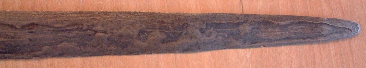

I agree with Alan. And the "glue" between ganja and the blade is probably newer glue too. Kind of "epoxy" glue. Anyway, IMO it is an old "kebo lajer" (mahesa lajer) blade..

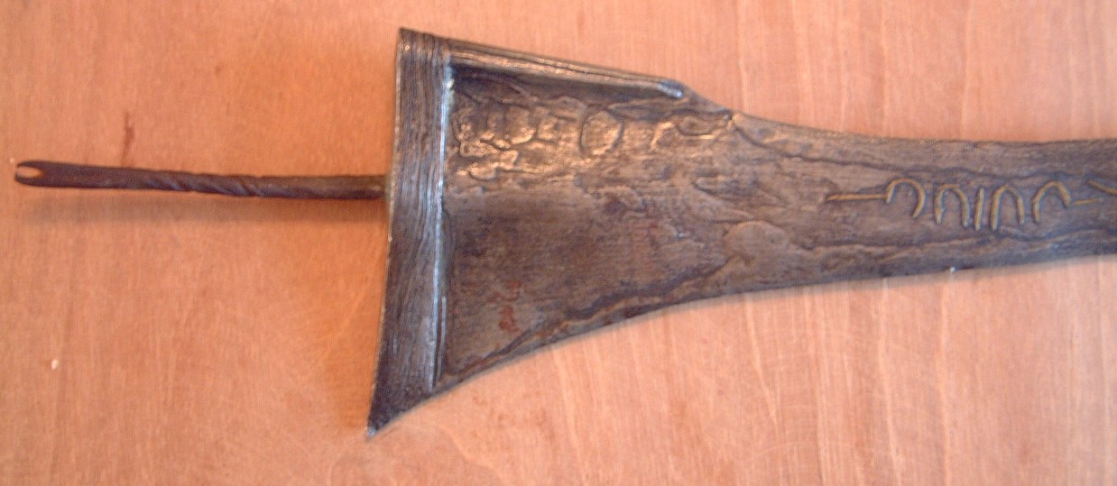

It looks like the ganjar is not original to the blade .

Looks original to me.

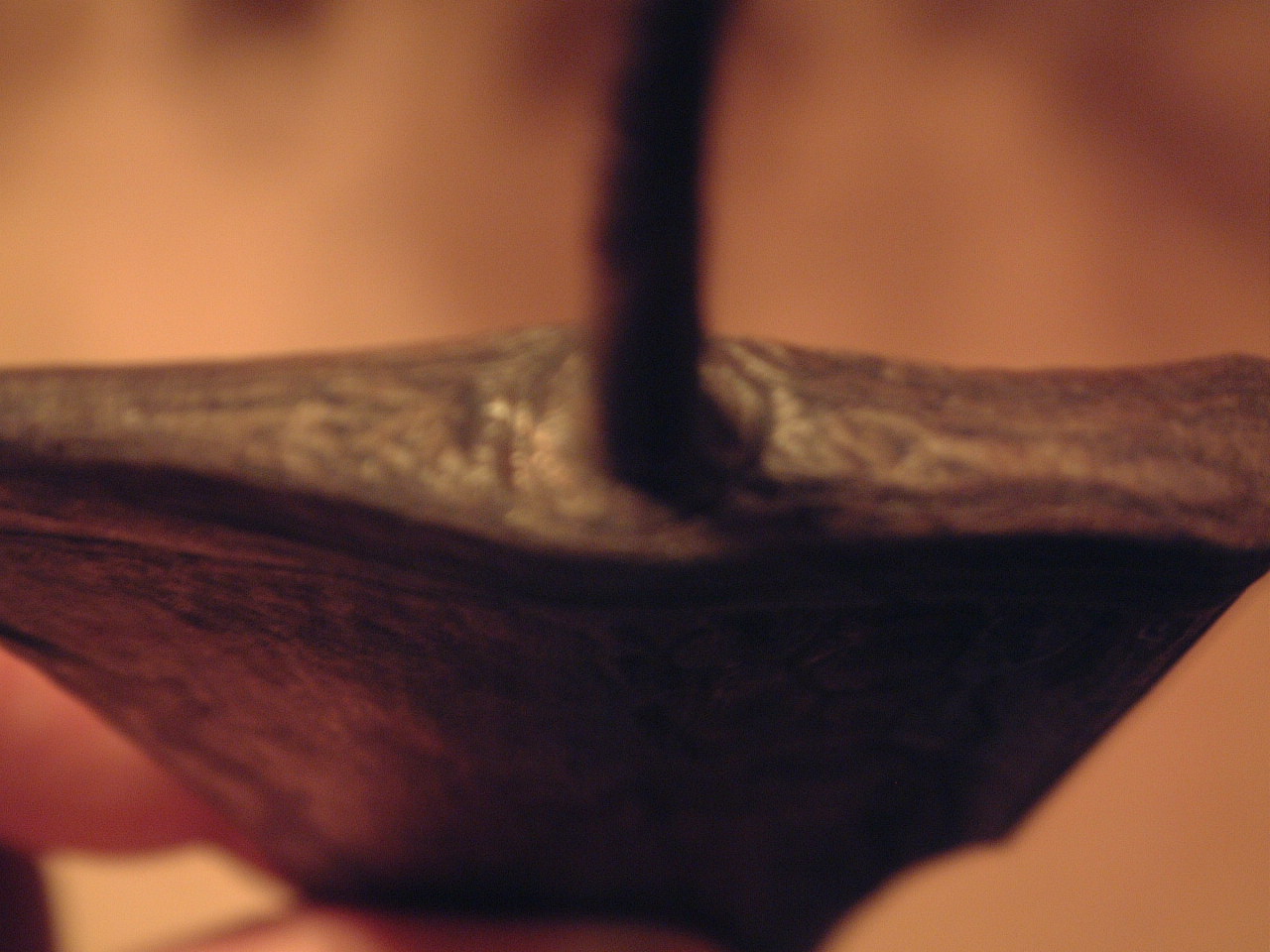

You are spot on. I just took the blad from its place on the bookshelve and had a good look at the gonja from the top.
The hole for the peksi is indeed a bit larger and had been filled up (with metal as it looks but defenitely filled up!).
To me the gonjo seems original th the keris.
So a change of peksi form and the addition of text to make it a talisman.
Who would have done this and why with this keris?
Can you add more?
Thanks, Erik

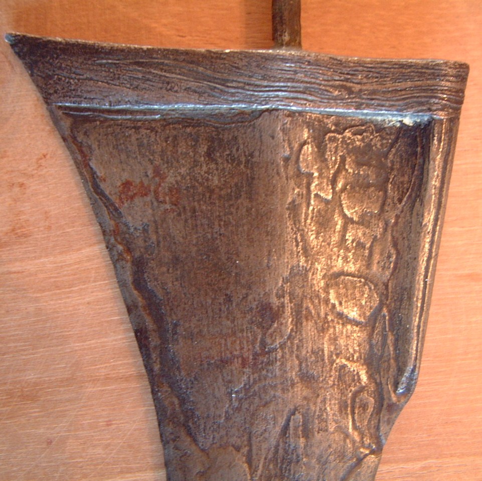

The filling is either plastic steel, or Araldite mixed with iron filings. The Araldite/iron filing mix has been used in Jawa probably since the stuff became available years ago. It acts as a preservative to stop erosion of the blade base, apart from assisting the fixing of a gonjo.It took me a long time to come to terms with this practice and accept it, but when you adopt the mindset that it is your responsibility to preserve that which has been left by previous generations, for future generations, and you discard the self-centered egotism of the "original" concept, its not too difficult to understand the rationale.
Araldite and similar products are very easy to remove with heat, and whilst they are in place they do provide very good protection.
As to why the addition of script and the gonjo alteration was done, I have no idea.
I could create a lot speculation, but I don't know, so one guess is as good as another.
A. G. Maisey is online now   Reply With Quote

Here is a photo of the peksi hole in the ganja.
The best I could do without daylight.
