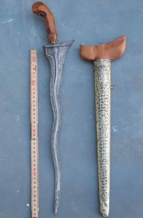

I bought this large 5 luk blade.
For some reason I am often charmed by the shape of 5 luk / pendawa lima blades. It was definately not the dress of this keris.
Someone dressed this keris with java ukiran, mendak and pendok.
It has a odd shaped wrangka which seems very recent, but to me appears to be made with a precission I would only expect in Indonesia.
So my questions : is this blade from Java ? where would you place the wrangka ?

Great shape Willem,
Whats the hilt like?

here is the entire picture.

Based upon what I can see in the picture it does appear to be a Javanese blade.

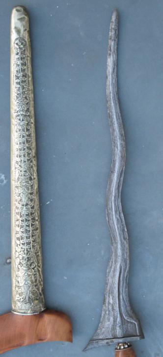

Hilt Solo, scabbard is recent, and I am guessing, but probably an attempted copy of an old North Coast wrongko, but either the original was not particularly good, or the current tukang couldn't copy it very well.

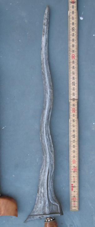

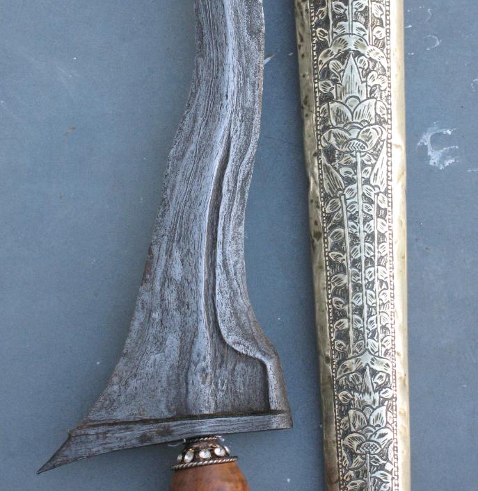

I agree that the blade looks Javanese but it is more than 39 cm long so probably not from Central Java but rather North Coast? The dapur includes a large pejetan, single sogokan, tingil and ada-ada? and can be defined as Kala Nadhah with exceptions. The warangka looks disporportionate with the blade (too small). A nice and elegant blade anyway
