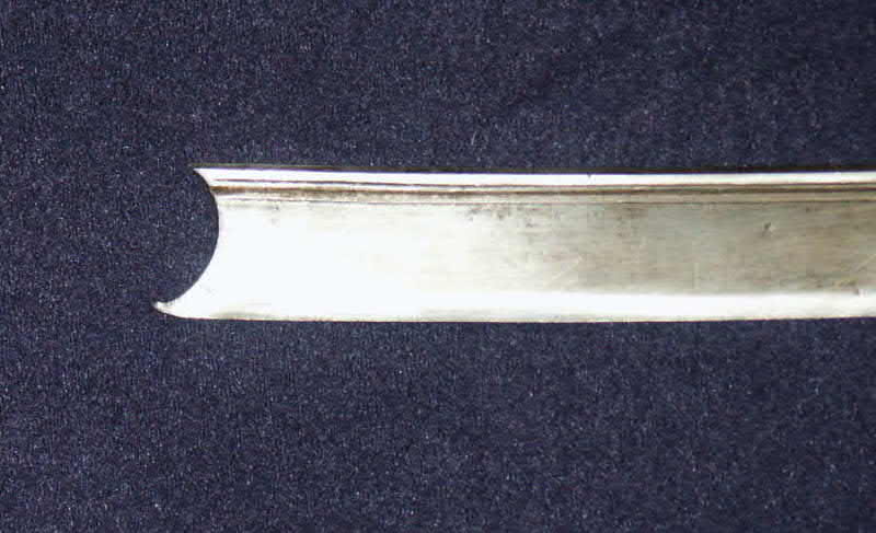

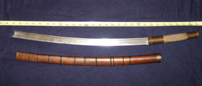

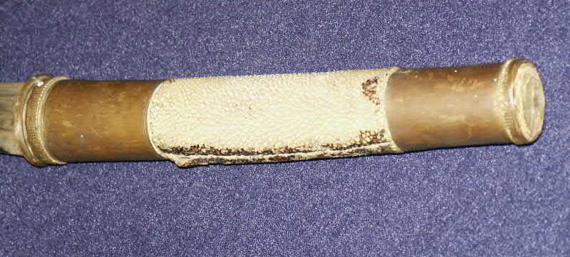

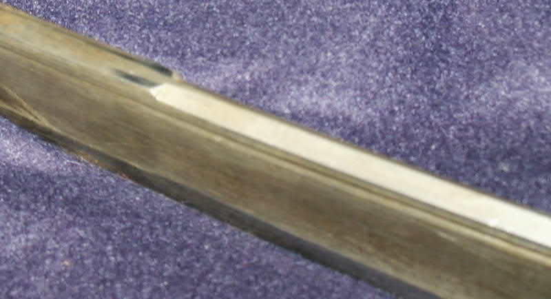

My first Dha. Can you help with regional ID and age. Ray skin wrap nailed around hilt. Pommell missing. Blade closest to hilt is 3/8" thick. Fullers run along the entire length of the blade. Hollow ground. Spine tapers down. The blade is in good shape.

Cool first dha, Kino.
This one is Burmese. The blade tip is one of the more interesting, in my opinion.
I have a similar one in my collection. I'm on the fence as to whether the blade is for real, as it looks like stainless steel, and the grinding and fullering are quite precise, as if machined. I'd say mid-late 20th century, for my example. Your results may vary.

I agree with Andrew, although I think it is probably older -- early 20th C. -- based on a couple of similar examples I have. The ray skin hilt appears to have some age. I have not seen ray skin on the hilt of dha that I thought were post-WWII.

I definately concur with Andrew, Burmese. During one discussion with Lung Som reference tip shapes he drew me a picture of two hua tat shapes, the first with spine edge and blade edge protruding equal, this he claimed was Thai (which includes Northern Thailand) and another like yours with the blade side protruding out past the the spine which he said was Burmese. The simple three piece handle has been used in both northern Thailand and Burma, but most I've seen have been attributed to Burma. The spine work and specifically the transformation from a flat spine to almost a false edge part of the way down the spine I've only seen on those blades attributed to Burma.

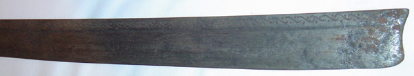

A Shan attributed blade, the blade side tip has obviously been worn down through use (in person you can see it).

A very nice well made sword kino. Congratualations. I actually turned down several of these when I first started collecting dha ( calling myself a dummy ) as I was not attracted to the tip style. Then I got my first one and since then I have found that these blades are often some of the better made blades. I do not know if anyone else has had the same experience . Its not uncommon for a blade such as yours to have hardened inserted edges, active forging patterns or differential hardening. Thanks for sharing the pictures with us

Perhaps we might be hasty about assigning different origins to dhas based on the relative projection of the tips--at least without looking at a very large sample and considering their age too.
The older example posted by Khun Deng, for instance, has less of a projection at the edge than the spine, but it looks like a blade that has been used and resharpened over time. Since it is the edge and not the spine that is sharpened, the point would have a tendency to get shorter as material is removed (and perhaps rounder as in that example), but the spine would presumably remain more or less intact, saving the occasional ding.
