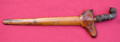

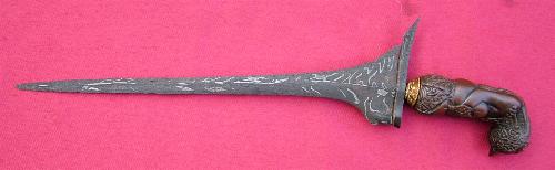

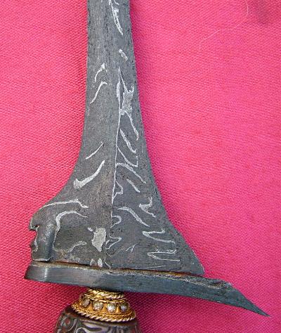

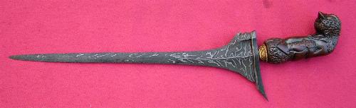

hello guys who can tell me more about this keris pamor and dapur
Old 6th December 2008, 03:27 AM   #2
tunggulametung
Join Date: Jan 2007
Posts: 238
Pamor might be ganggang/ganggeng kanyut - floating algae.
Dhapur might be sempaner/sepaner/sempana bener/supana bener, a complete ricikan for the dhapur is is kembang kacang, jalen, lambe gajah, tikel alis, ri pandan (some not clearly/no longer visible on this particular piece). A popular dhapur.

Hi Hans,
looks like a realy old piece. majapahit??

Posts: 7,255
Nope.
Mojo has an elongated blumbangan, in form not dissimilar to SKA.
