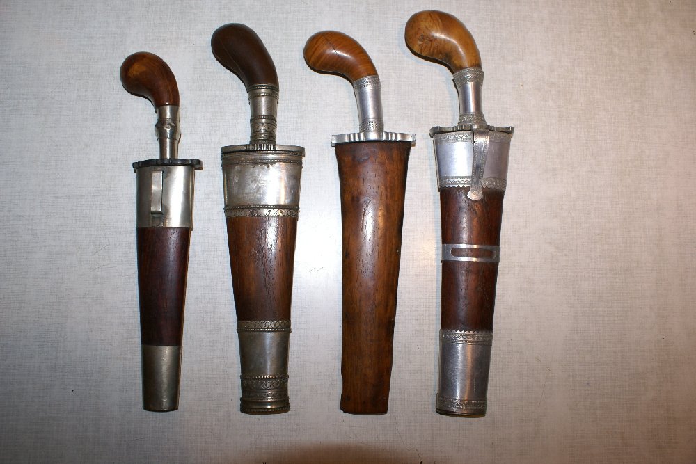

Please let me know if you get tired of seeing these.

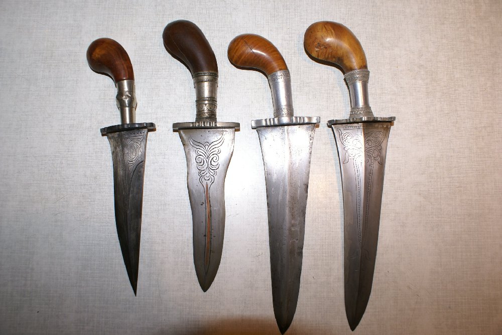

4 3/8" (111 mm) laminated blade. Looks like it's seen some repair and refurbishing over it's life. The ferrule has steel strips rivetted on, and the scabbard has aluminum bands that look like a later repair.
Steve

Posts: 478
Steve,
Did you etch this one? If so what procedure did you use?

Steve,
Yes.
1. Polish with wet-or-dry sandpaper lubricated with Windex up to 800 or 1000.
2. Rinse, dry, then clean with Acetone.
3. Etch with Ferric Chloride diluted 3:1 with water. I use Radio Shack Circuit Board Etchant.
4. Neutralize first with vinegar, then with Ammonia based window cleaner (or ammonia), then with baking soda.
5. Rinse well, dry, then burnish lightly with 0000 steel wool lubricated with oil.
Steve

Originally Posted by Ferguson
Yes.
Steve
THANKS!
