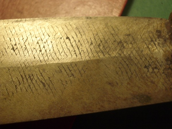

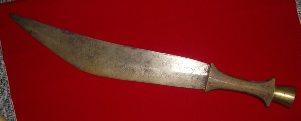

A strange weapon.
Blade is not brass, as it looks on the photo, but iron (steel ?)
Shape is curious; coming from East Africa ? ou South east Asia ?
Grip in wood with a shape that could also come from East Africa (Somalia ?)
Blade does not appears to be forged but the filed from a blade of 4.5 milimeter thickness.
Does anybody have a clue ?

Looks like an east African design made from a file.

A "gile" from a file!

Thanks to both Bill and Andrew. after a search a "gile" certainly. From a file ?
The original file would have been very wide and thick !
No other explanation for this grid on the blade ?
Thanks

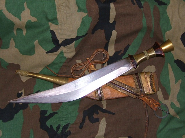

It's a gile Afar or Danakil tribe. The blades are forged from truck leaf springs or large files or rasps as is yours.

Thank you Lew,
You are certainly right, I found your gile after a search with the name "gile" that was given by Andrew. I am just surprise by the file idea but I cannot explain the scratched network otherwise.

Files are usually made from good tool steel and old worn out files are seldomly discarded they are recycled into blades. I have a huge pesh that was forged from an old file I will see if I can find you a picture of it.

I can conclude that the blade of the Gile was really forged and not obtained by stock removal. This means also that it must have been forged with several files that have been heat welded. This demonstrate a good control of the forging process and a sizable consumption of charcoal. When one looks to your video on the Afar tribe dancing, the number of gile shown, seems to indicate that these blades are currently produced in relatively high number. All this means high consumption of charcoal which should be scarce in the region as it is very dry and with little vegetation. Very surprising.

I am not a metalurgist, but with my practical knowledge I have a few questions / remarks.
- A file is hard and brittle. not the best material to make a knife
- a file is often not as broad as this knife is.
- a file's surface is often flat while this blade is getting thinner towards the edges is away that I have never seen in a file.
So if you would reshape a file, the original grooves of the filw ould remain vissible in th emiddle but surely not towards the edges.
So my idea is that this knife is not made from a file, but maybe the grooves/stripes are caused by shaping the steel, with a very rough file.
So in fact they are filling marks

Knives have been forged from files for hundreds of years. Many American revolutionary black smiths used them as their source of steel which was hard to come by in those days.Yes files are quite hard but the smith anneals them in the forge to soften them up. When you forge the hammer blows spread the tapers out in the file which widens the profile of the blade being made. I collected custom made forged knives for years before getting into antique knives and I have owned many knives forged from files,rasps and even steel cable.

Files and rasps come in all sizes, some fairly large. As the blade is forged down to a thin edge, it gets wider, and retains the pattern of the teeth.
This is indeed one of the things that I overlooked when drawing my conclusions.
