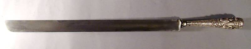

Hi,

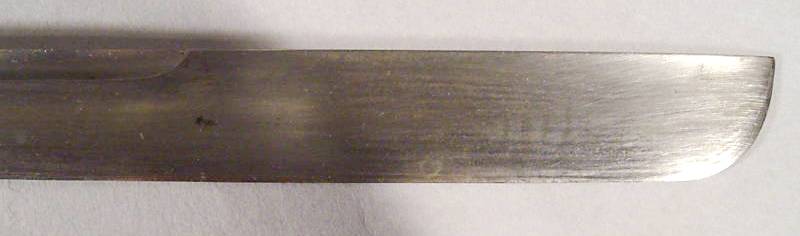

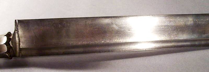

just finished on eBay, was suggested a form of a Klewang that has had a re-hilt (suggested by one observer as a parasol handle). It looks as if there are signs of hairpin lamination Lack of knowledge prevented me bidding enough to win. I wondered about other peoples opinions.
Thank you for all comments.
http://cgi.ebay.co.uk/ws/eBayISAPI.d...ayphotohosting
Regards David

It's an Aceh Sikin Panjang blade with a very odd, outside the culture, hilt.
It doesn't look like a useful combination "tool-wise".
Michael

Thank you Micheal ,
it was the blade I really liked, is it likely 'hairpin' lamination ? I agree the hilt is an oddity and its overall shape is not really suited to the sword's functional use.
I have always associated 'hairpin' lamination with Oriental origins, if this (the blade) is this type ..did the bladesmiths of Aceh produce this blade or was it, perhaps, imported ?
Kind regards David

I assume that this blade was locally made as I have never heard about any imported Sikin blades.
Michael

i lost that one by a pound, the blade was what i was after, the handle someone had commented on as being a burmese parasol handle. ah, well, wasn't going to risk more especially when the postage from germany was not mentioned. i had visions of putting a more culturally correct grip on it.
the laminations look more like just straight laminated steel, not hairpins.
nice blade, whoever put the parasol handle on it was in an altered state at the time...i initially thought it was a large bread knife

Hi Micheal,
thanks again for your insight .
Hi Kronckew,
'great minds'... and all that. I too was thinking the same ...the only slight problem I had with the blade was, it looked to be 'overly cleaned'. The postage was £14 .... not overly expensive. I was thinking of removing the handle and selling it, I'm sure a parasol collector (strange what some people collect ) or similar would be interested ...and the 'funds' used towards a genuine replacement
I wasn't convinced of the Klewang 'connection', but felt certain it was of SEA origins. The 'parasol' handle was stated as Burmese, whether the handle was fitted recently, to sell or was part of its legitimate history is a mystery....but feel its overall shape would not provide a good 'grip' for the wielder.
