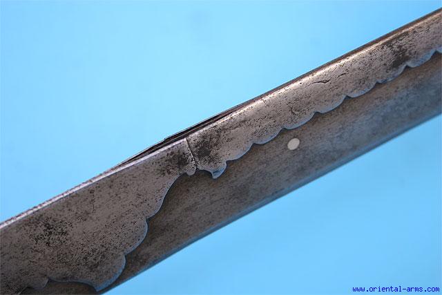

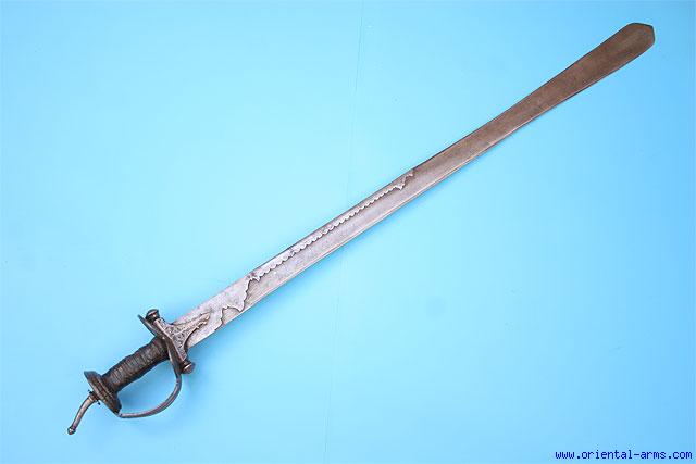

can someone tell me something more over the reason from gild ore brass filled wholes at indian swords. at my last khanda sword i found such an filled whole and today i looked at the web site from oriental arms and there is also an khanda with exactly the same sign.( you can see also such brass dots at the cover from eggertons book at an khandablade) i know there are in the past time some discussions over the reson from wholes in the blade if it is an talismanic sign ore an indicat for the quality from the blade. there are also the opinion if it is only an filled ( nail) whole. i donīt believe that it is an whole from an nail what was only fille dwith brass ore an other soft metall. i hope some one from the forum members know more over these things.

Copper and brass inserts are common throughout South Asia, Southeast Asia, and China. You should take a look at old posts on the topic. There are many of discussions, but not too many answers other than they are nice decoration.
Sometimes they have symbolic meanings, and sometimes they don't.

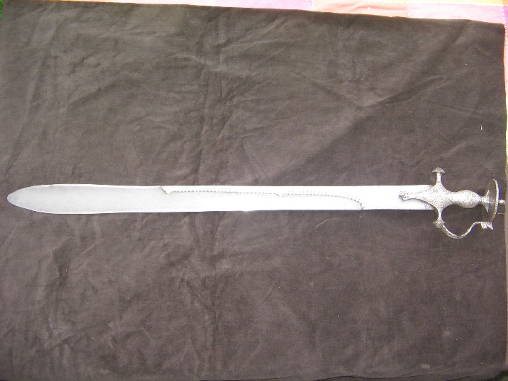

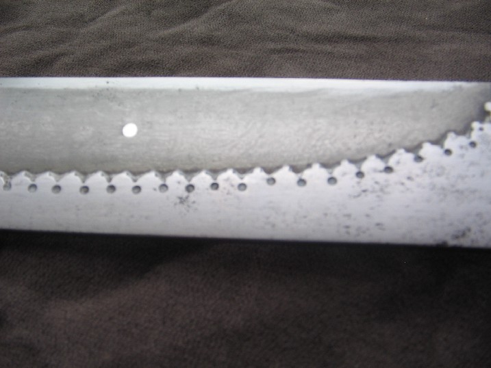

I have noticed these holes in a number of Indian blades, usually broad straight blades in Hindu-style basket hilts (which have no tang, being secured by plates over the forte of the blade). The holes are often filled with inconspicuous iron and I have found that they are often in a position suggesting that the blade has been remounted and that these are a residual artifact of the rivet which had secured the replaced mount. Sometimes there are two or more such defects and they are often close and or irregularly spaced. Some of these blades have appeared to be of an age that likely would have known multiple sets of mounts, while in others I have had the suspicion the filled hole came with a new sword in imitation of older blades or to suggest it was an heirloom.

Below is a better photograph of the firangi showing the two holes filled with iron and three photographs of the hilt for Jens.
