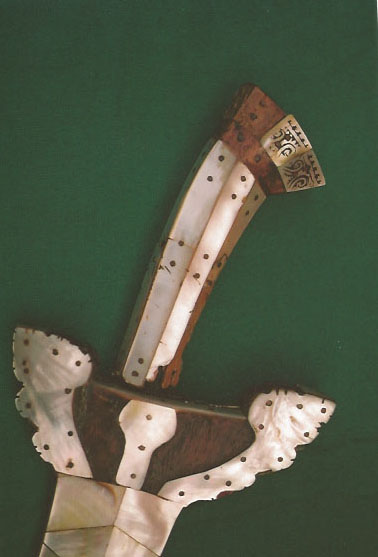

I hope is the right place for put the only keris of my collections on the table
tank for your comments in advance
bonsoir a tous
jacques

Hey Jacques. I thought for a moment that is might indeed be the wrong place to post this when i read your title. We generally differentiate Indonesian keris (which have their own forum) from Moro kris though a difference in spelling. While i am not sure calling a Moro kris by the spelling keris is "academically" incorrect, i think you might be able to see that separating the two through spelling can help make discussion less confusing. If you don't mind i am going to change the spelling in your title to kris so that other members that are interested in Moro kris will see immediately that this is a thread to check in on.

A VERY NICE MORO KRIS, I HAVE NEVER SEEN ONE WITH SO MUCH MOTHER OF PEARL SHELL. IT IS VERY ATTRACTIVE, THE BLADE IS A NICE WATERED STEEL PATTERENED ONE. THIS KRIS IS MOST LIKELY FROM MINDINAO ISLAND NOT SURE OF WHICH MORO GROUP MADE IT. I LIKE IT WHO EVER HAD IT MADE IT MADE IT FOR SHOW AND IT SURE IS AN EYE CATCHER.

Barry, do you think it is possible that the dress was made at a later date. This type of mother of pearl dress didn't come about until around WWII AFAIK and this blade looks a bit older than that. Also this hilt seems to be on backwards.So while the dress seems to have been made for "show" the blade may well have been made for "business".

I agree David, the blade is earlier than the rest. MOP was actually used before WWII, but not earlier than the turn of the 20c. However, so much MOP is a later use. I there also agree that is maybe circa WWII MOP fittings.
Also the front of the ganga is Sulu type and the blade has a little Indonesian style to it. Still I would say Sulu region as the place of origin.

Hello Jacques, very nice Moro kris indeed! My first impression was also, wow so much mother of pearl! Though wanted to add that -as Barry noticed very sharply the MOP on the scabbard may be later- I think the engraved MOP pieces on the top and bottom of the scabbard are probably older as they look more yellowish from handling.
Usually the middle section -now covered with the MOP mozaïk- is wounded with fine rattanstring which brakes easily when old n dried out.
I do feel its all authentically done (no restauration by a dealer or collector) at a later stadium, although they dont have the two dots of the wood pegs to attach them as the pieces on the handle. The long pieces on the handle are also attached at a this later stadium as when handling these pieces would also acquire a much yellower patine from handling.
However as this may sound a bit negative, I believe its not so bad as who wouldnt want to own this magnificent piece! The blade has a very powerfull presence! And its a wonder almost all MOPpiecses are still there.
On style and origins, I would myself not ascribe it to Sulu but more to the mainland of Mindanao >Maranao?< as the handle (geometrically) resembles a horsefoot and Sulu-pieces tend to have more the gracious cockatoo type of handle.
Enjoy the piece n regards, Indiana

Not sure if anyone has mentioned that the blade is on the hilt backwards, and needs to be reset.
Hello Wouter,
I think that Jose was relating to the blade when he stated the Sulu origin.
